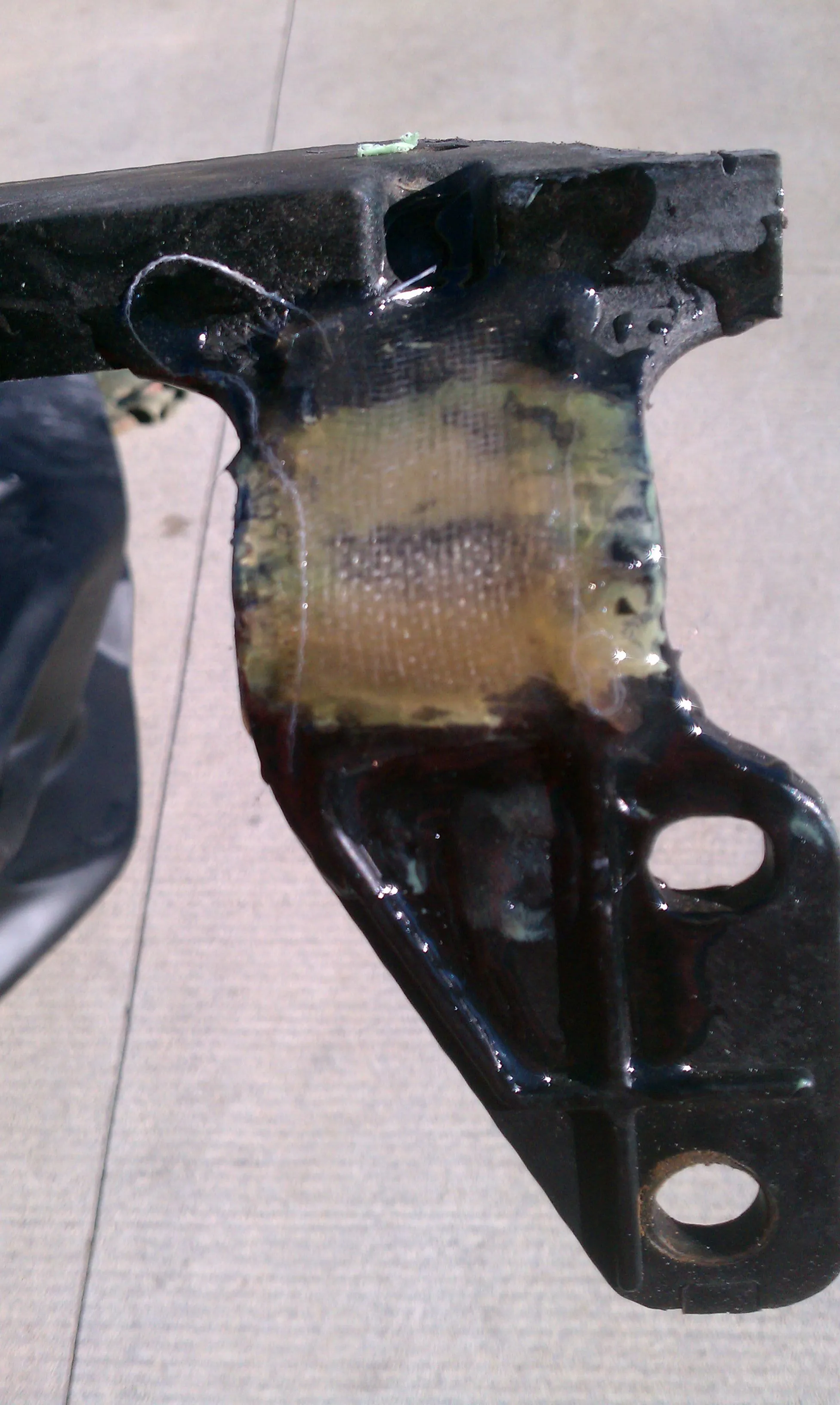

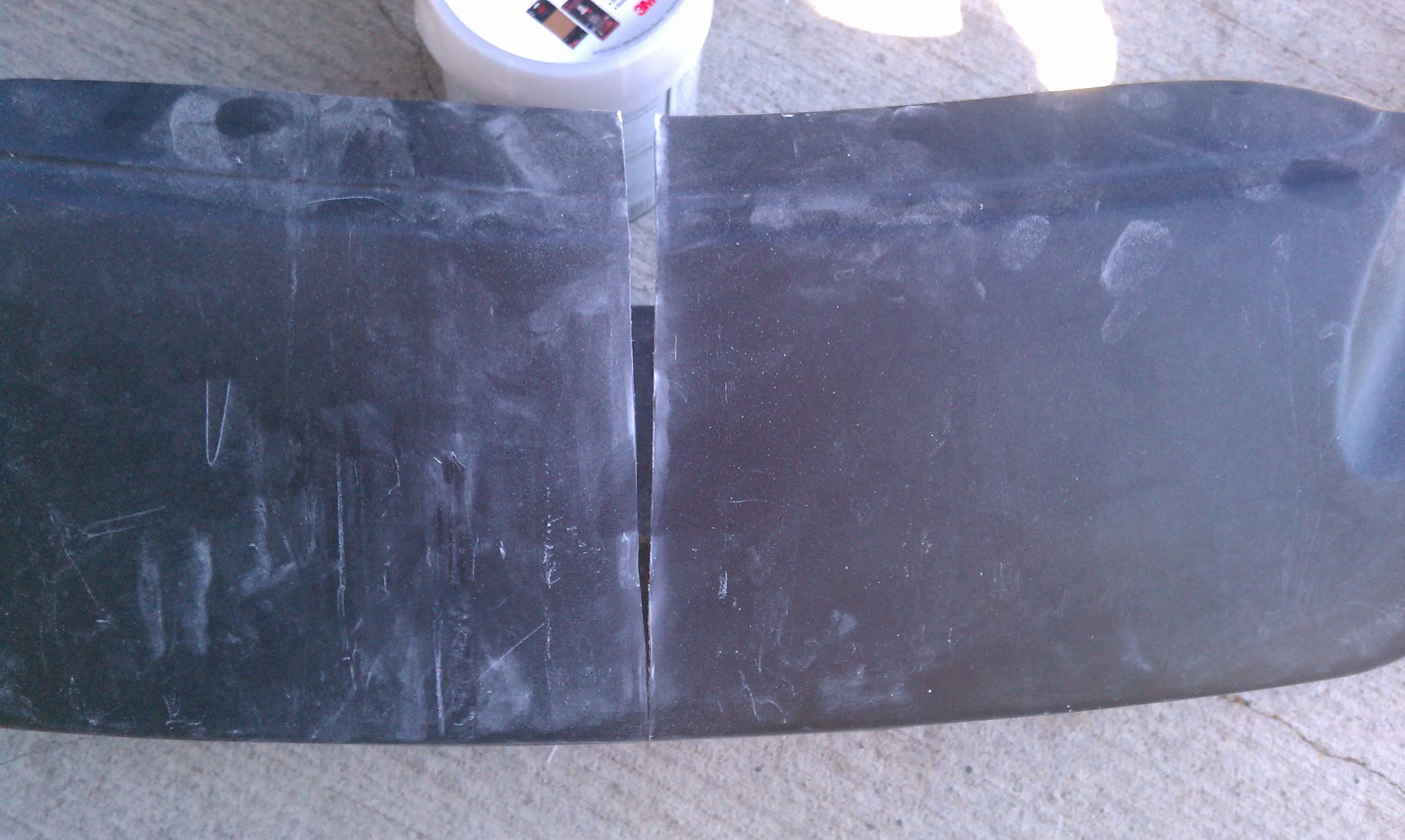

hey everybody im installing the vader body kit on my mx6 and ran into an issue, the front bumper was about 1.5 inches too wide on each side, i cut the center in a v cut (not the whole thing just the top section) to squeeze it closer with out having to cut it and fiberglass the whole thing.
i found the other post about his install but all the pics are gone, i was wondering if anyone else had installed a kit and may be able to give some tips
these are some pics of the upcoming body kit and install, i dont know how to show them in the thread so they are attachments

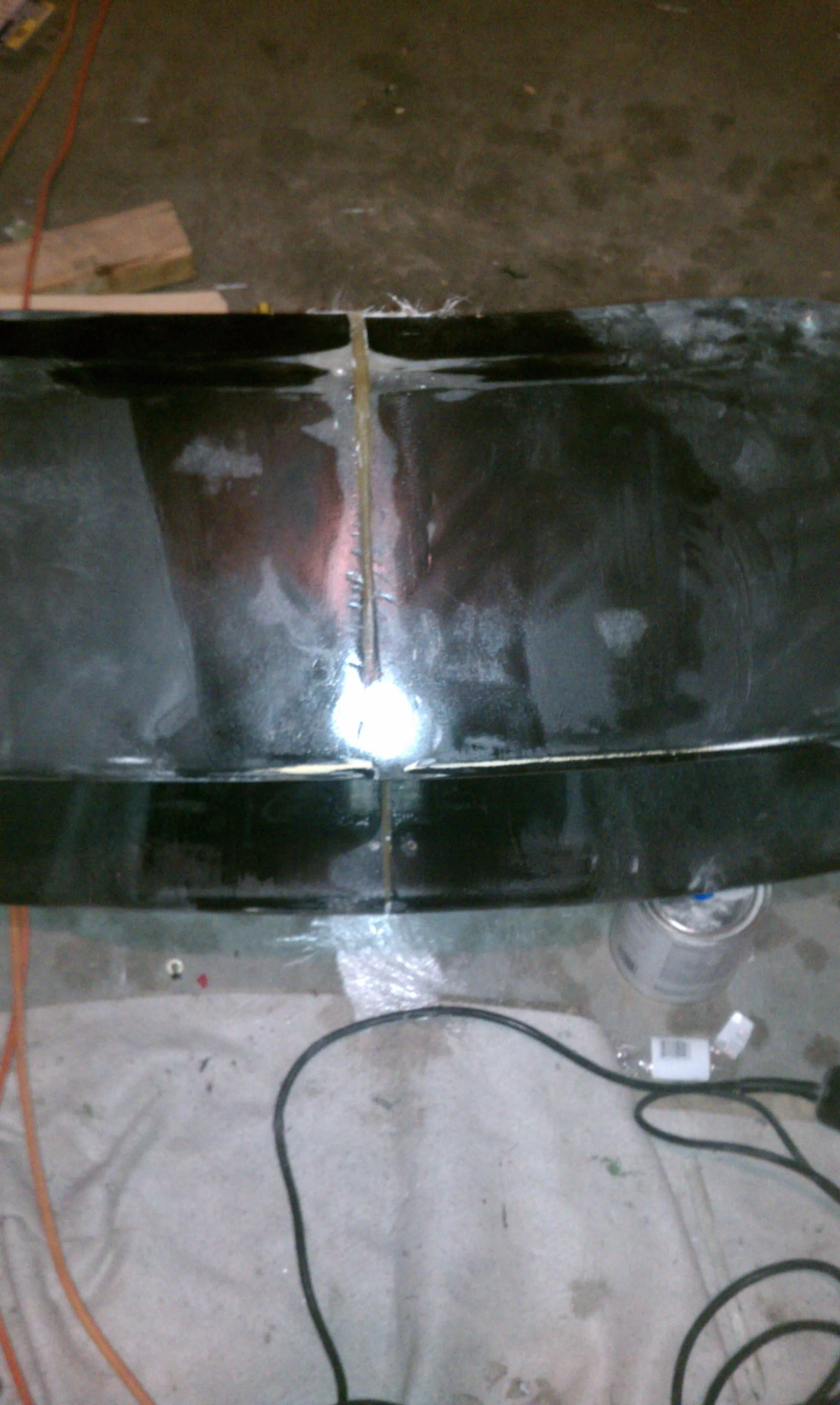

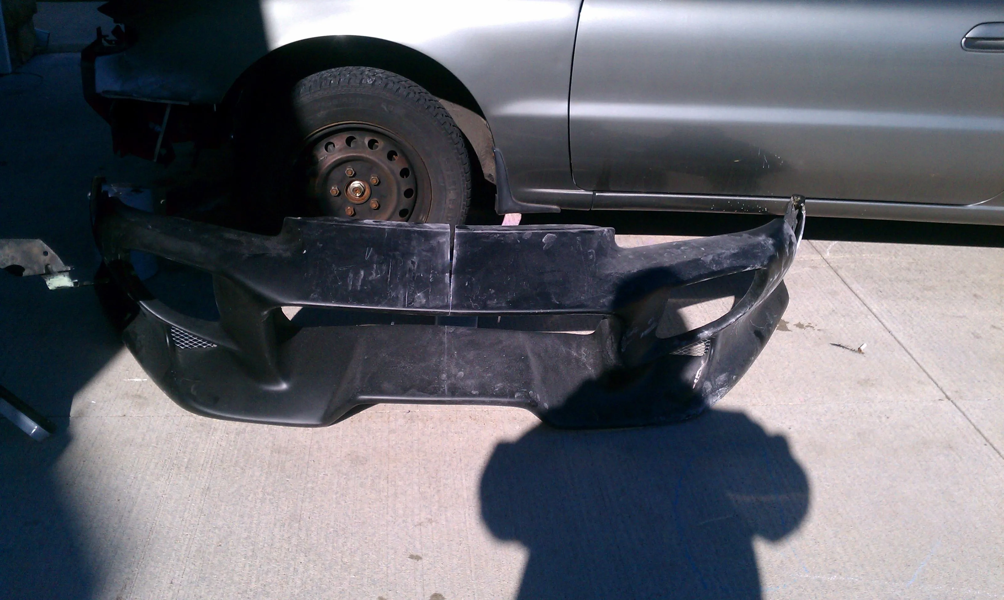

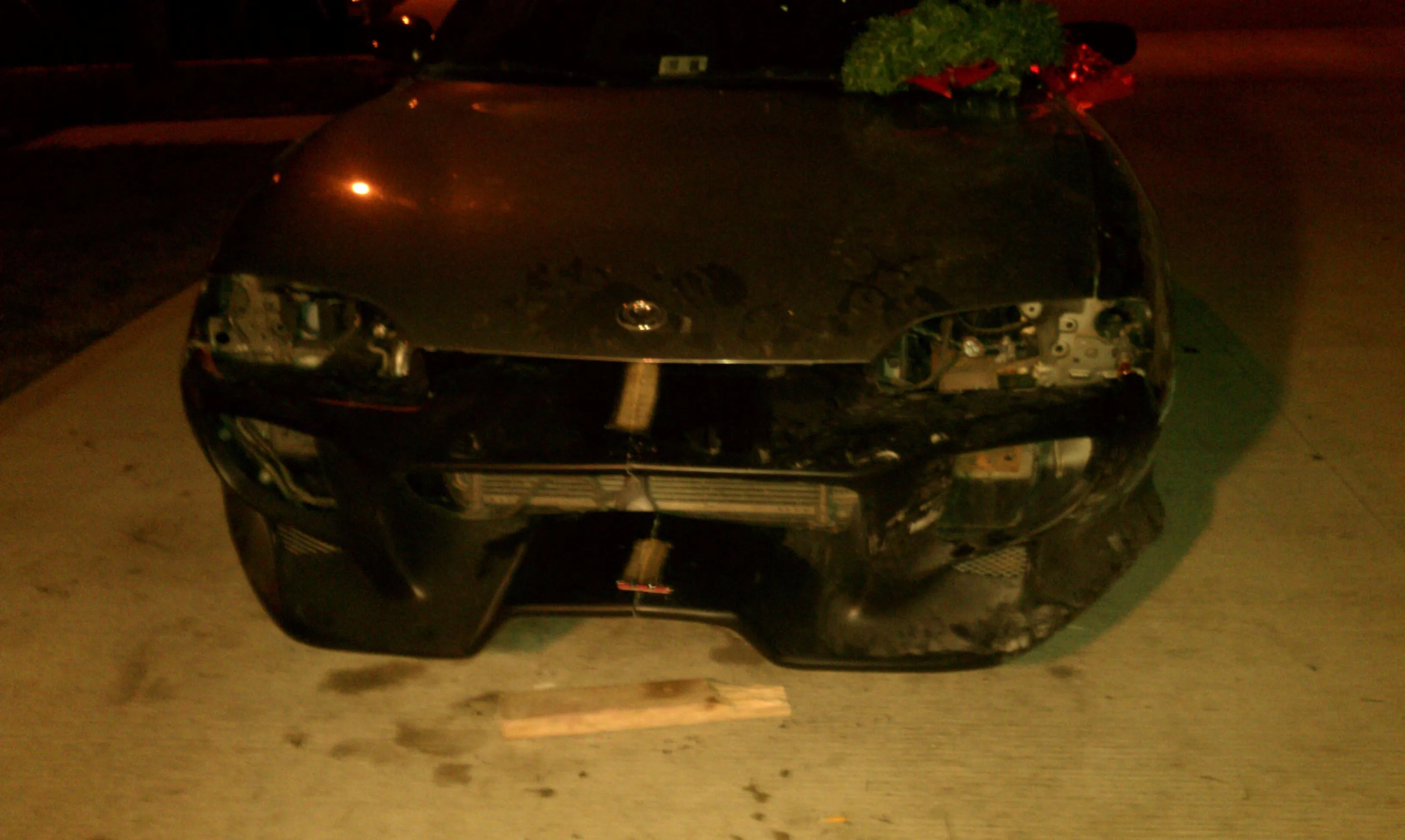

Day 2
despite the lack of intrest in this thread (stash) i will carry on and post todays pictures, i had to eventually cut the center all the way through to make it fit properly on the sides, this is not all ways the case on kits though, we installed my buddies kit 3 days ago on an eclipse and it was just a matter of flexing it right.
on this one i screwed it in on the fenders and cut the center than trimmed away the excess, after that i was able to brace it with some self tapping screws and pop sickle sticks (the holes will be filled with milk shake and glass) then i used a few pieces of glass to add rigidity to the center so i cold pull it off and keep my dimensions.
tomorrow i will fill glass the bottom in full and milkshake the top and add a few pieces that i cut out messing with it (they didnt need to be cut out obviously)

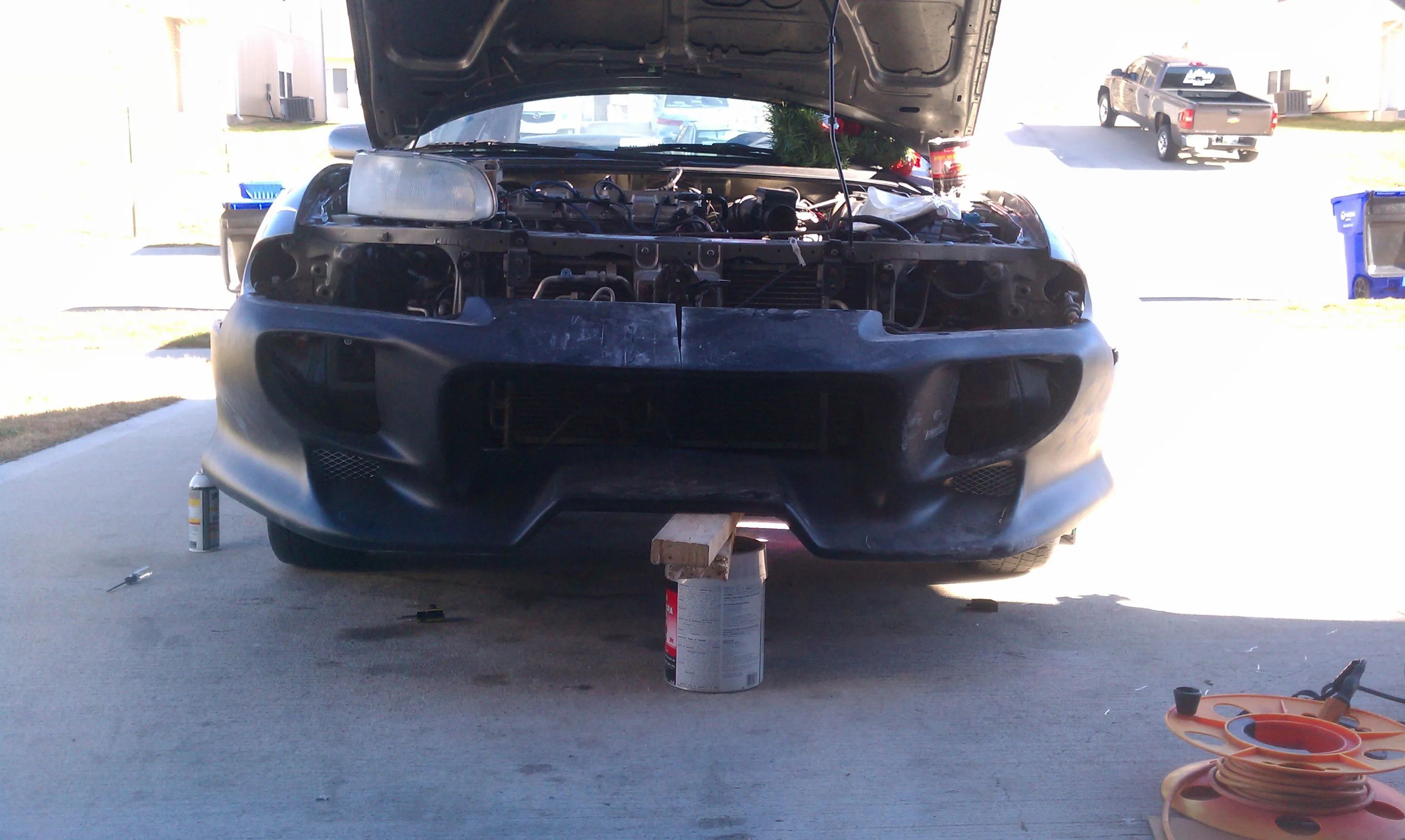

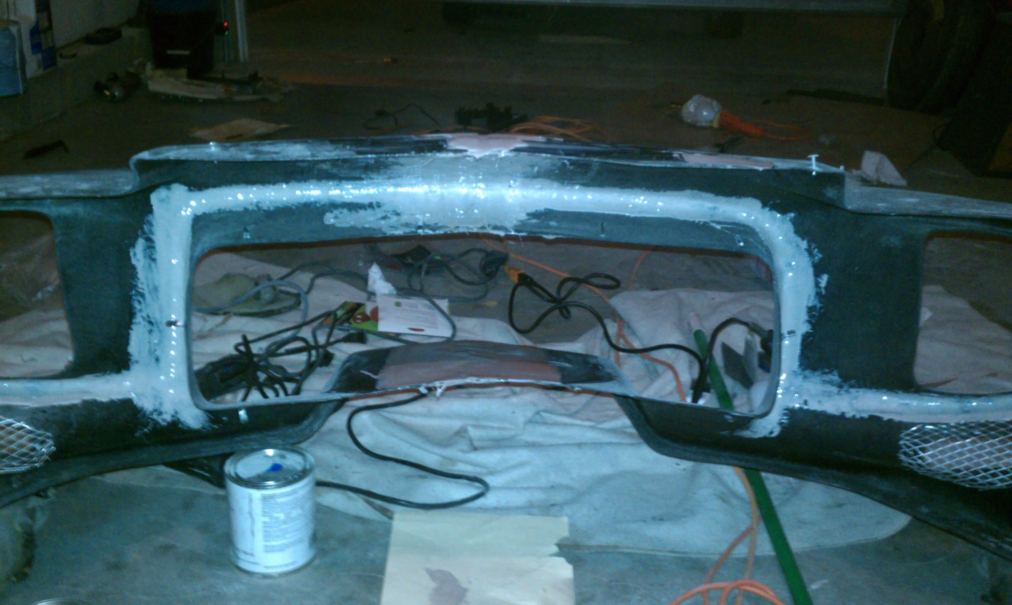

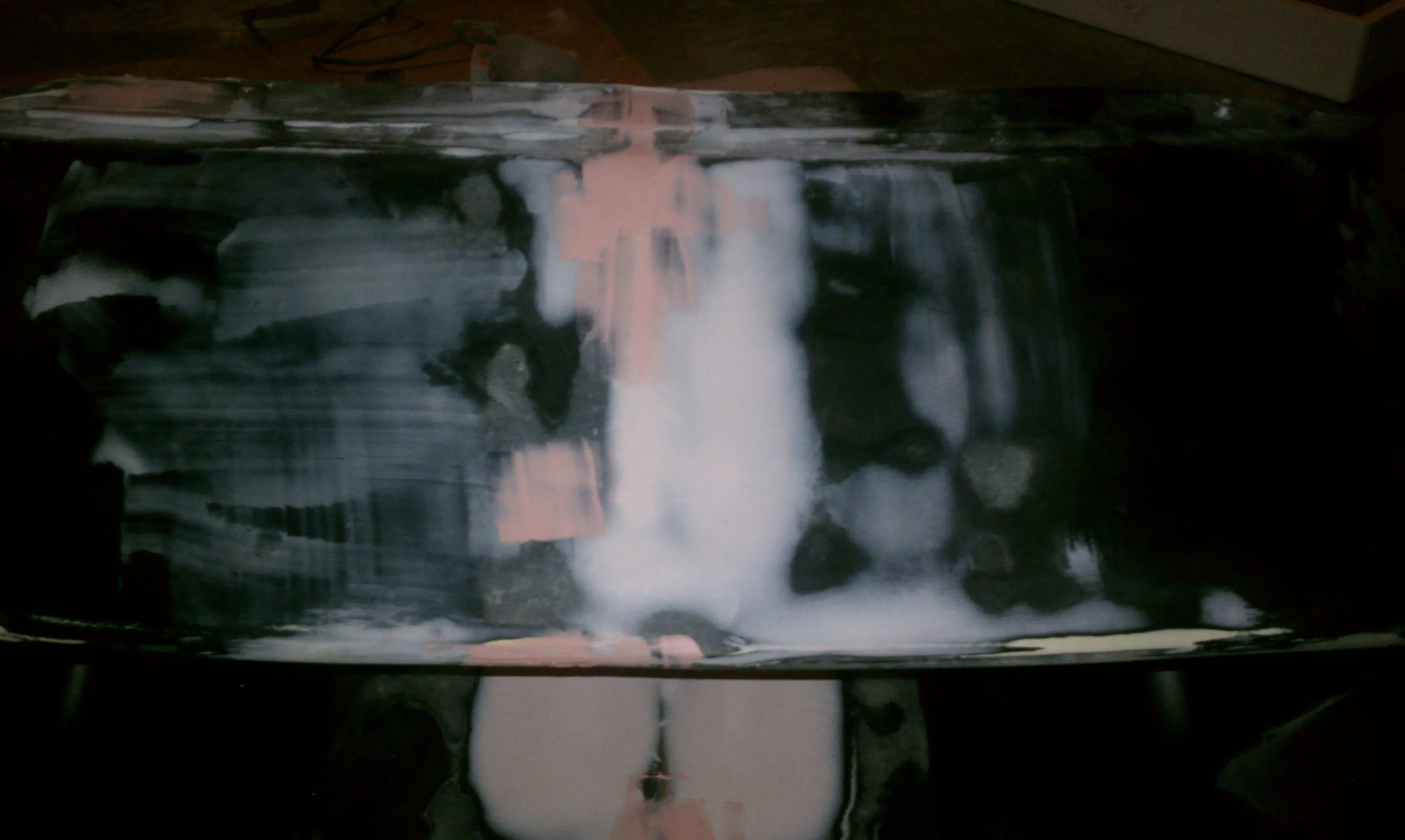

day 3
today i pulled the bumper off the car and flipped it so i could glass the underside, a did three layers for glass mat not sheet (its stronger & easy to use), after i layed my three i did 2 layers going the other way for extra force.
once this was done i flipped it back over and cut and smoothed the glass down (the one on top i used as a support bracket)
I sanded the area with 60 grit and wiped it down with water, then xylen to remove any oild from my hands as well as any other contaminates.
i miked the milke shake with appx 4 oz of bondo and appx 3-4 of resin, i used both hardners a dash of bondo hardner and for color to ensure proper mixture, and appx a teaspoon of resin hardner, mixed it real good and layed it down.
it went on real smooth and much better than either one alone!!(breakn).
i then used the left over on the inside that was glassed earlier in the day to add extra strength, then smeared it around the corners on the inside as well.
Milk shake is fiberglass resin and bondo mixed to the consistancy of.. you guessed it MILKSHAKES!!!!!!!!!!(boobs2)

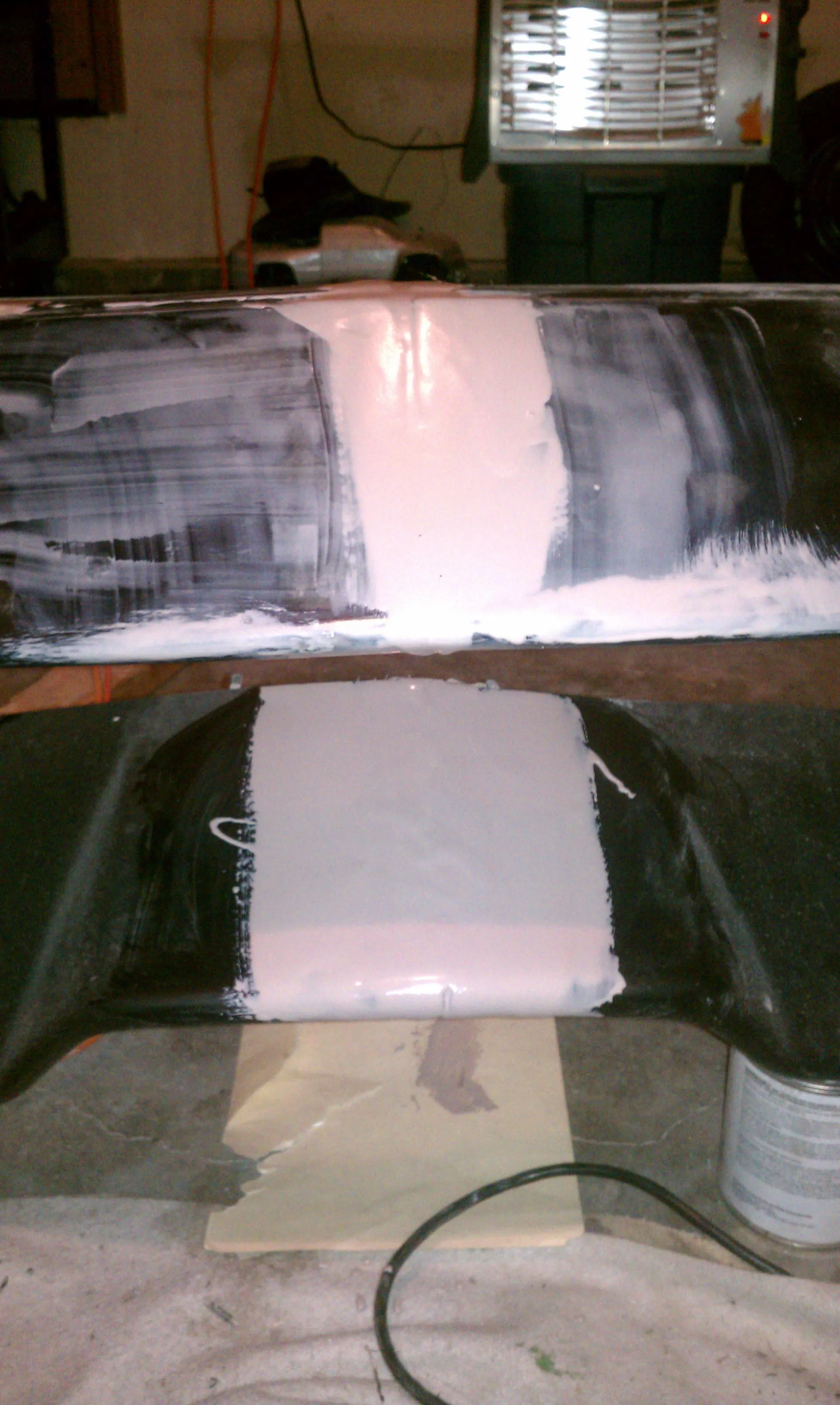

next day
yesterday i smoothed the milkshake off, and patched a few small spots as well i had to reconstruct one of the side pieces cause i foolishly cut it off last week. it was so cold 24f that nothingn wanted to set up and took a lot longer i only have 1 pic for you today

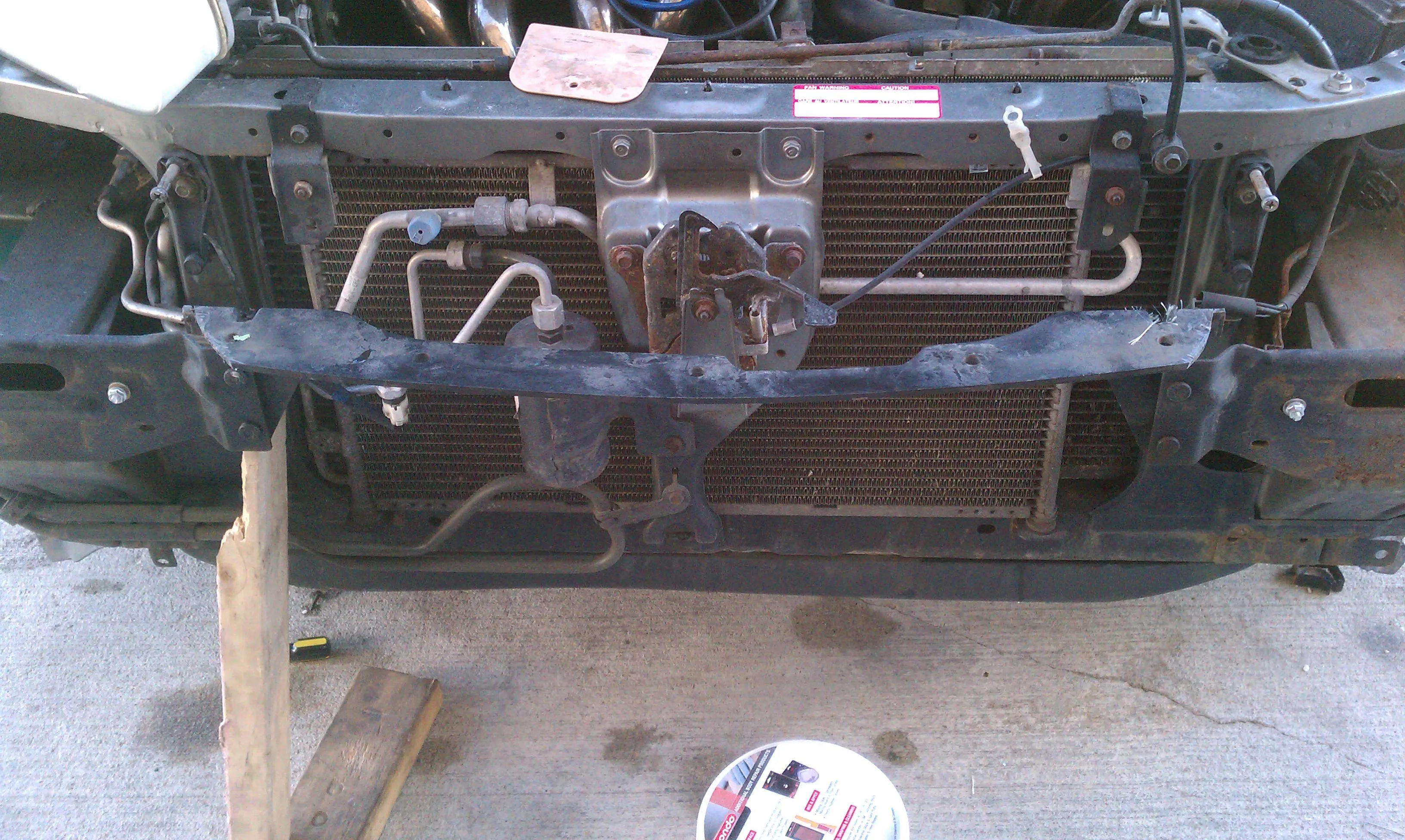

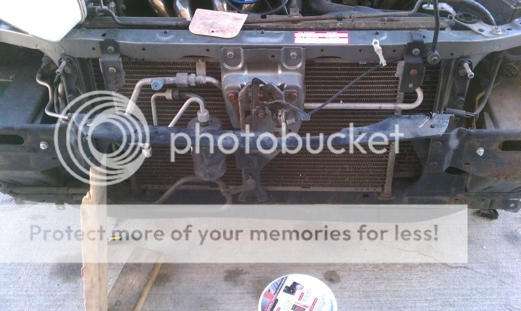

i'm not sure, i bought the car with the kit already installed, PO did a terrible job. tore it off in a wreck, and am now just getting ready to replace all of the body parts. and idea what that thing running across the core support is called? mine broke off and was lost in the wreck.
