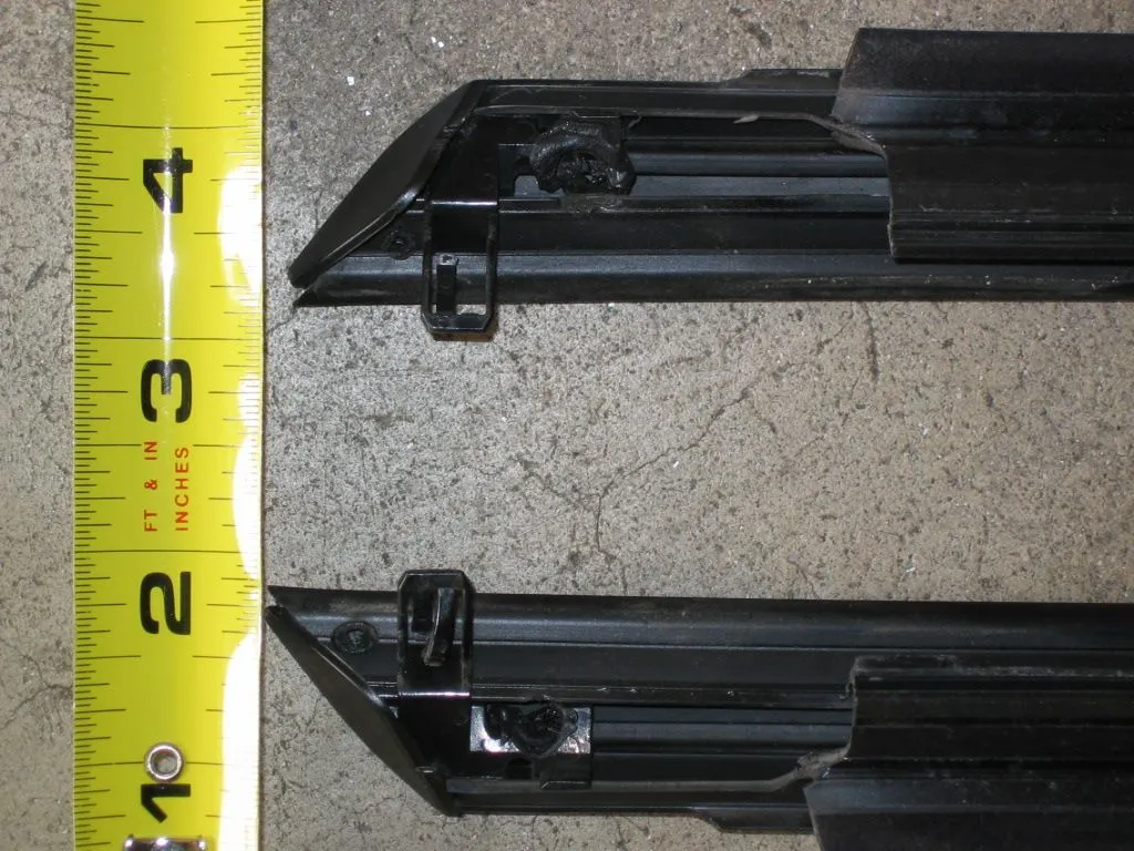

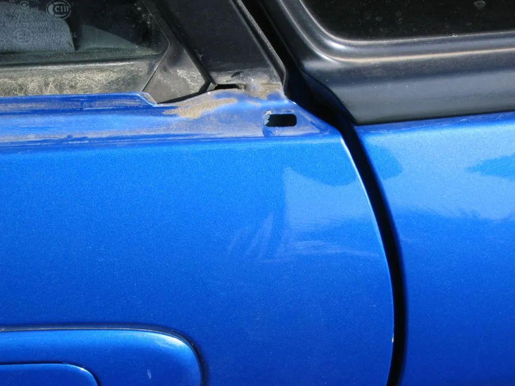

2. The rear ones unfortunately have a set of those accursed plastic snaps. I broke a prong on one of mine by just pulling up. To free the other side I pulled up pretty far, slid in a narrow screwdriver, then pushed slightly on the outside prong to release it. The 2nd and 3rd pictures show where those prongs are on the strip, and where they plug into the car. Those fasteners are fragile, be really gentle with them (and they may still break anyway.)
3. The piece that holds the screw has a little tap that is supposed to go inside clip over the hole and into the inside of the car. That clip had broken off on one of mine when the screw was removed. The screw alone seemed to hold it ok though.

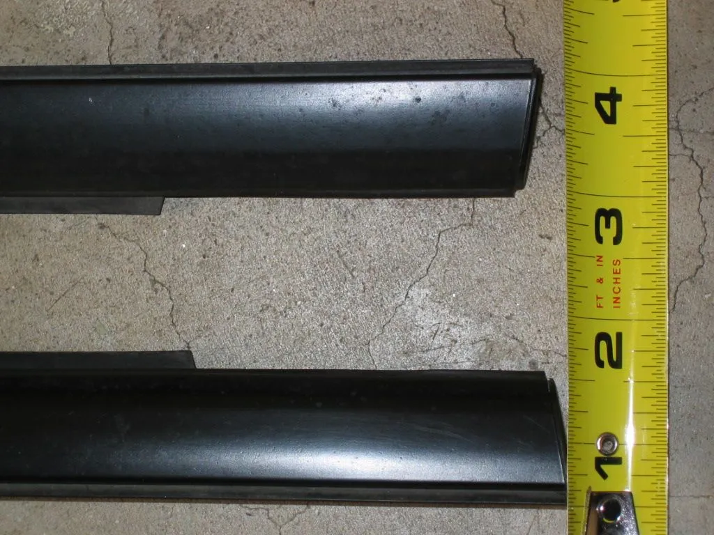

The problem with mine was pitting, not fading. It's hard to photograph but the first picture shows some of the pits. Note that both strips are equally pitted, it's just easier to see on the top one. I worked on one strip for 20 minutes straight with steel wool, a green pad, and finally some 1500 wet/dry sand paper. All of the mottling was gone, and some of the shallower pits, but most of the pits remained. Some of them were nearly a millimeter deep. I think paint may be a better solution than sanding for these pits. The strip material is definitely plastic, even though the pits look like they are in soft rubber.
The other three were just sanded with steel wool for 5 minutes and wet sanded with the 1500 sand paper for another minute or two. Then all 4 strips were treated with "Back to Black" and put back on the car. There's no obvious difference between them, so the extra sanding didn't help much. I think to remove the pits would take a LOT of sanding, with much coarser sand paper, and that would mean more sanding later to remove the scratches from the first sand paper.
