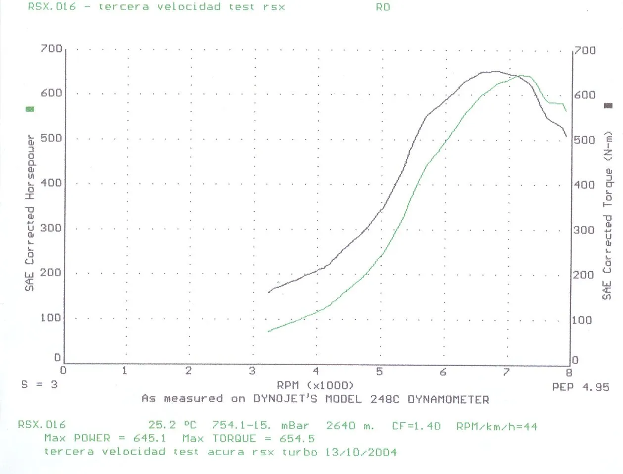

You want real big WHP. Go with Haltech. Our P5 is putting out 330 WHP and look what my RSX is doing. The fastest and most powerful RSX powered by a Haltech E6X.
Juan
Yes, I am using a GT35R and the dyno run was made at 28 psi of boost. The first run was 11.6 with full interior at 130 MPH but at 22 psi. The car would spin the tires even in 4th gear at 28 psi.
