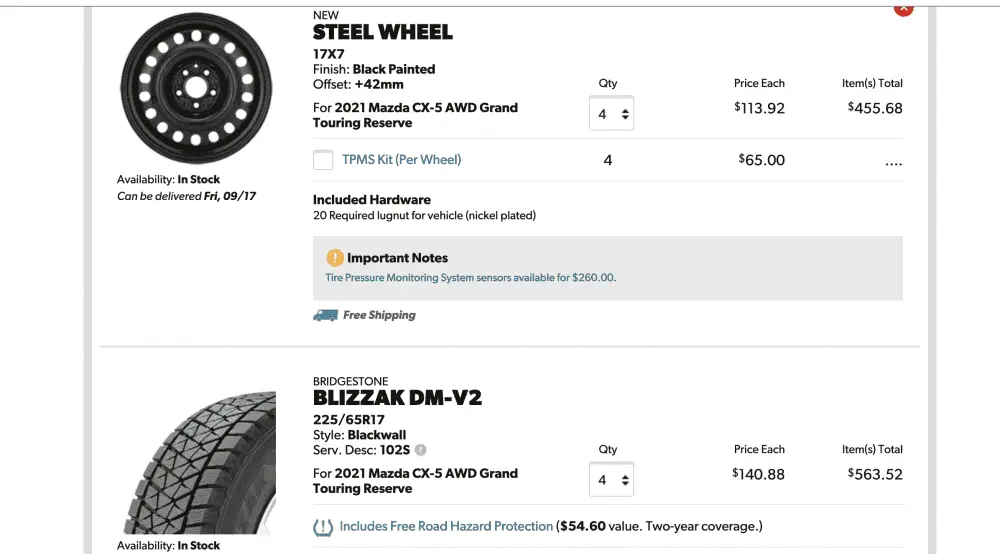

Sooo... I'm getting ready for some New England weather (love it!) and I'm actually considering this convo from Tire Rack website.. I just hung up the phone with someone at Tire Rack who confirmed that these black rims are ok to use. GTR has a '19 inch so I went down two numbers based on forum sugestions. On that note.. what can possible go wrong..?? I also got https://www.amazon.com/dp/ (commissions earned)
Big thanks to @yrwei52, @sm1ke
@BushWickz you'll love the blizzak dm-v2. Good choice on the 17 inch (more sidewall) You'll need tire pressure transmitters as well. (Or have dash lights on if that's okay with you)
I have always found deals on aluminum wheels at discount tire. I just prefer the look of the aluminum vs plain steel. Usually cheaper than those steel wheels you listed
Any winter tire will be better than an all season or summer tire when driving in snow or ice, regardless of the brand.
I bought four slightly used winter tires on kijiji, and four used rims, and paid a fraction of what new rims and name brand tires would have cost. They've worked great the last 3 winters.
Don't over think this. Get a decent tire and some steel rims, and you will all be good to go.
I am running the 17" Blizzak DM-V2's and am happy with them. Now, I got a set of discontinued brand new CX-7 17" rims several years ago on a clearance deal from my local Mazda dealer and this setup has worked out really well for me.
