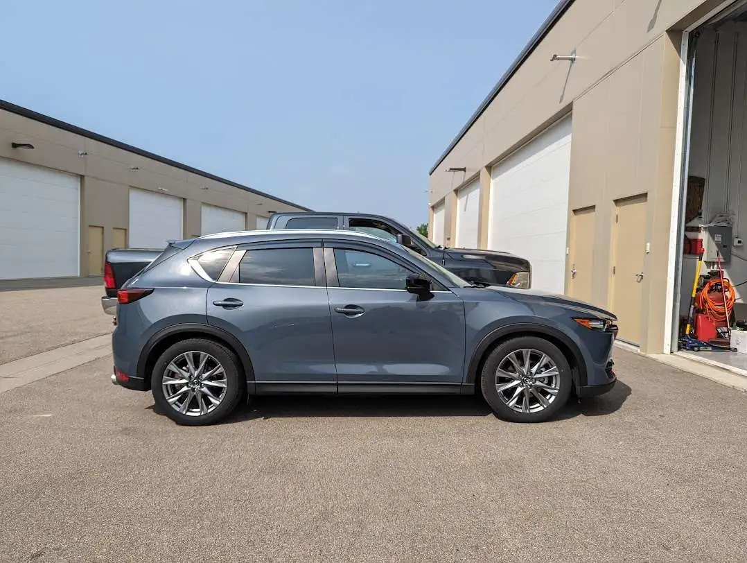

I second the Bilstein B6 front/rear suspension upgrade for my 2018 CX-5 Grand Touring (FWD). I did this a year ago and it's tight, but not harsh. It handles sharp bumps well and is not as floaty as the stock suspension. I believe it actually raised my ride height by 1/4 inch though. So, if appearance is your main concern look elsewhere. Even my wife and kiddos noticed the improvements and had no complaints.
