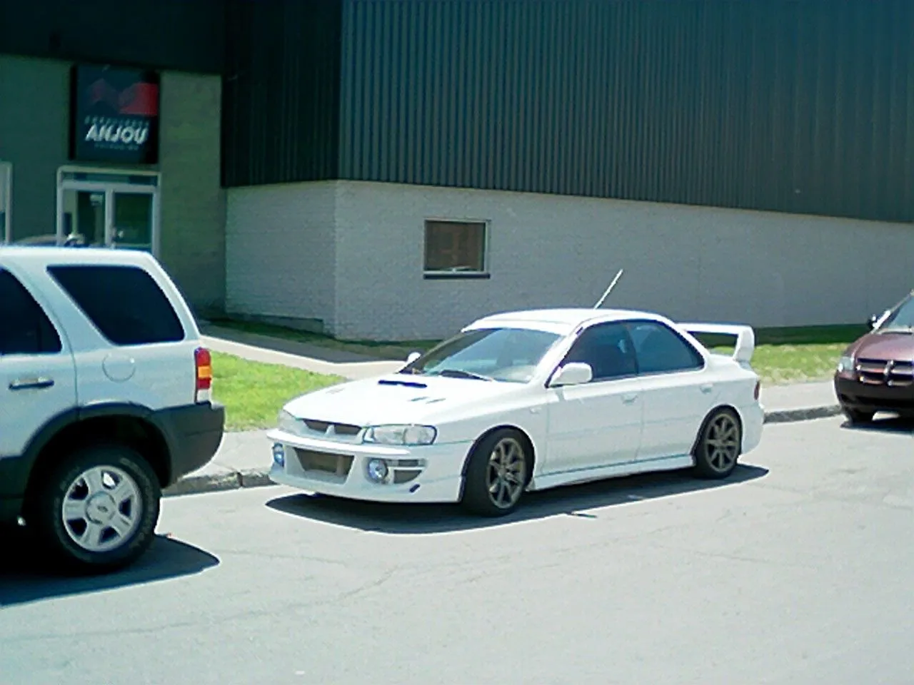

I brought my car back to mazda and what do you know my radio is ****** and the have to order a replacement, I hate you mazda.
I owned an Impreza and never had anything close to this many problems
I miss you baby
