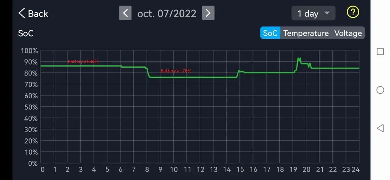

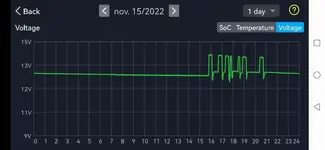

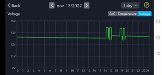

When I don't us the car, 12v battery draw and lost capacity.
I've been looking for a rule or pattern that could explain what's happens.
At last I bought a battery controller (BM6 at AliExpress), trying to identify the problem

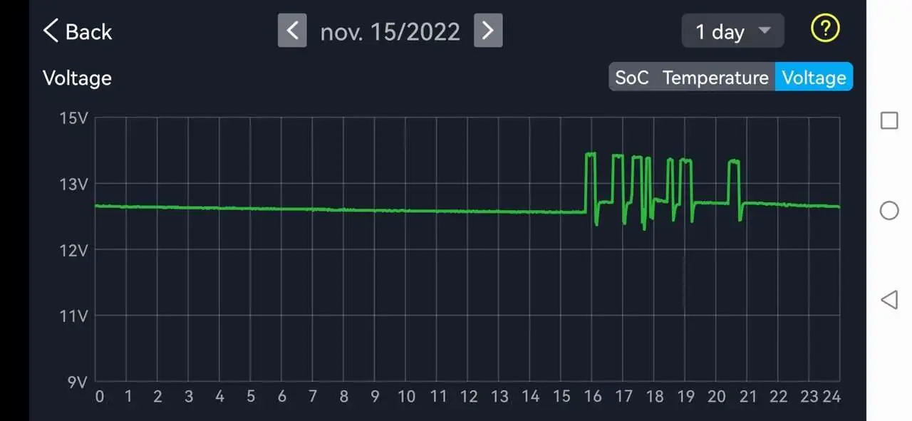

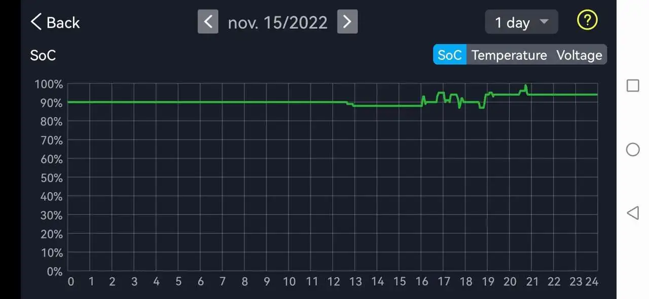

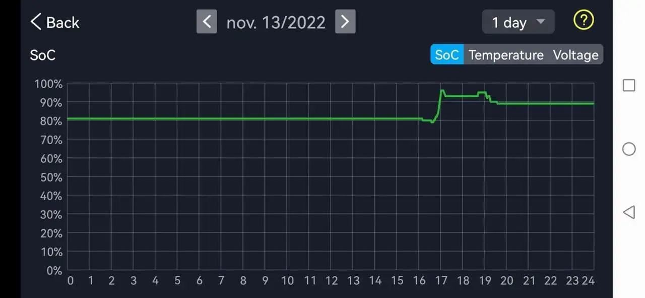

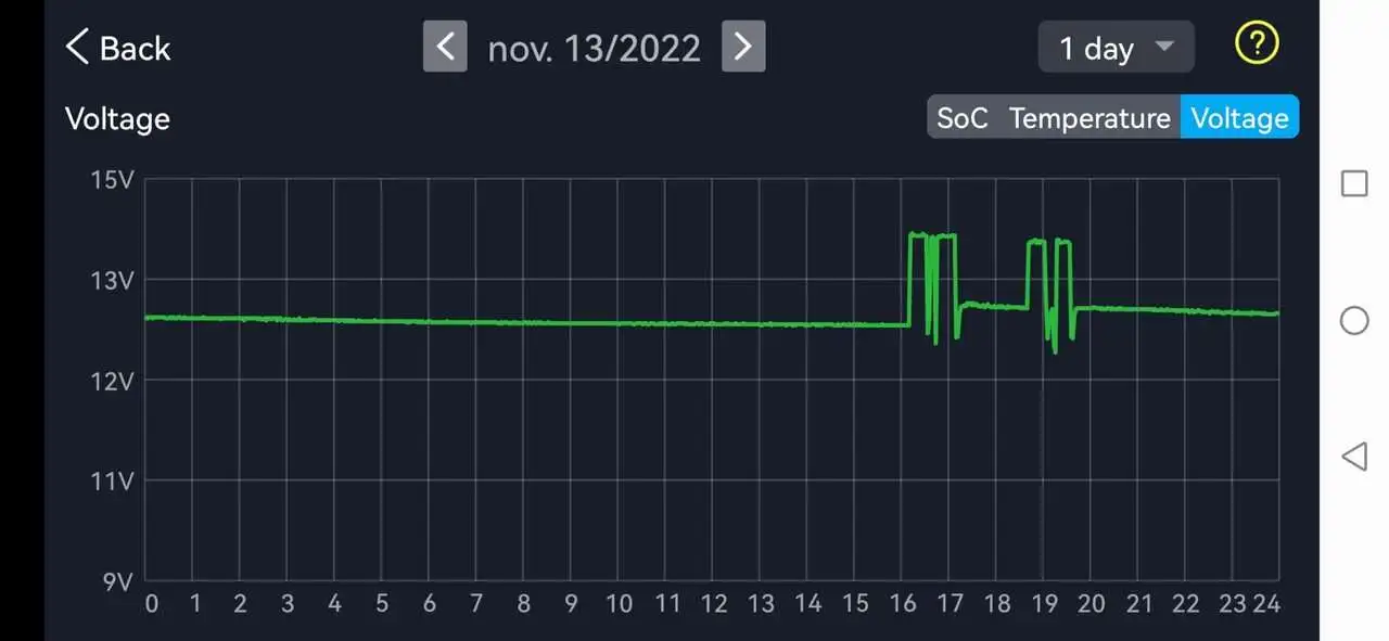

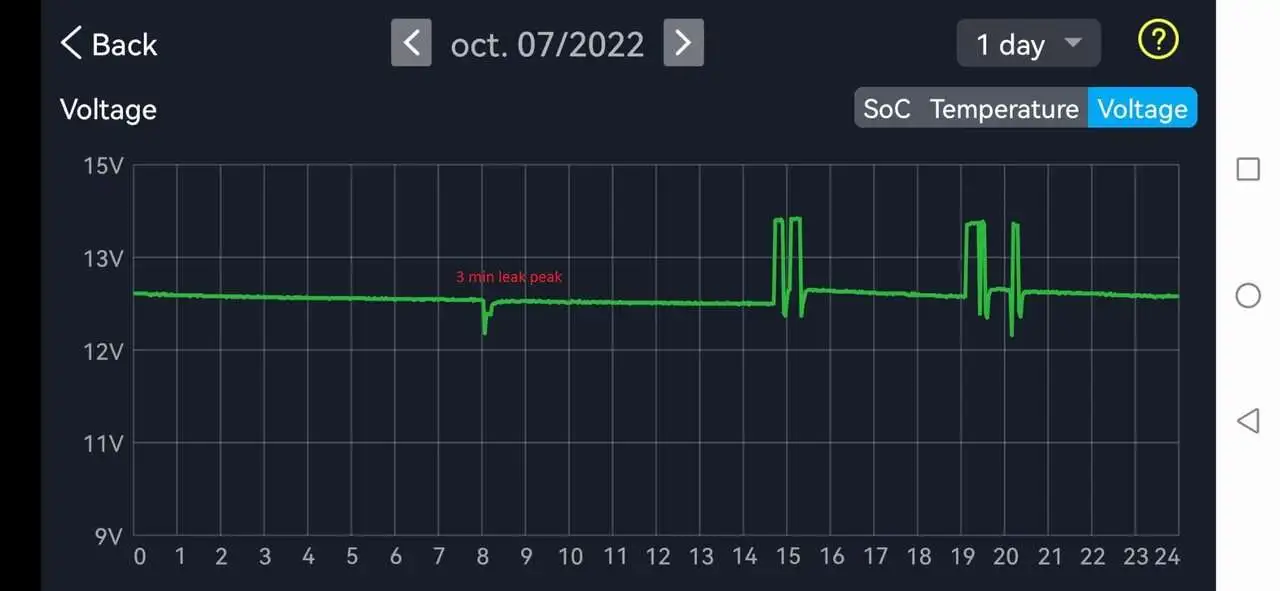

I've detected at dawn and nightfall a 3 min consumption peak of voltage.
It cause at least a 8% of battery capacity in each event, these data are 24h the car into the parking.
....2nd part....

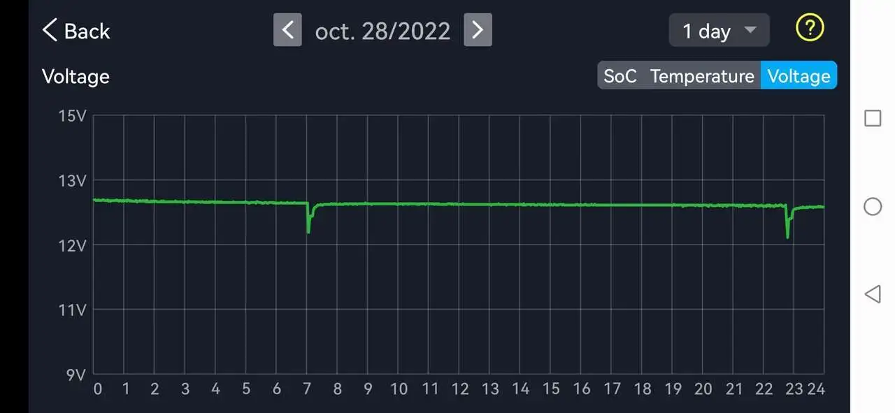

I installed the battery controller on 20221006, and first results were this:

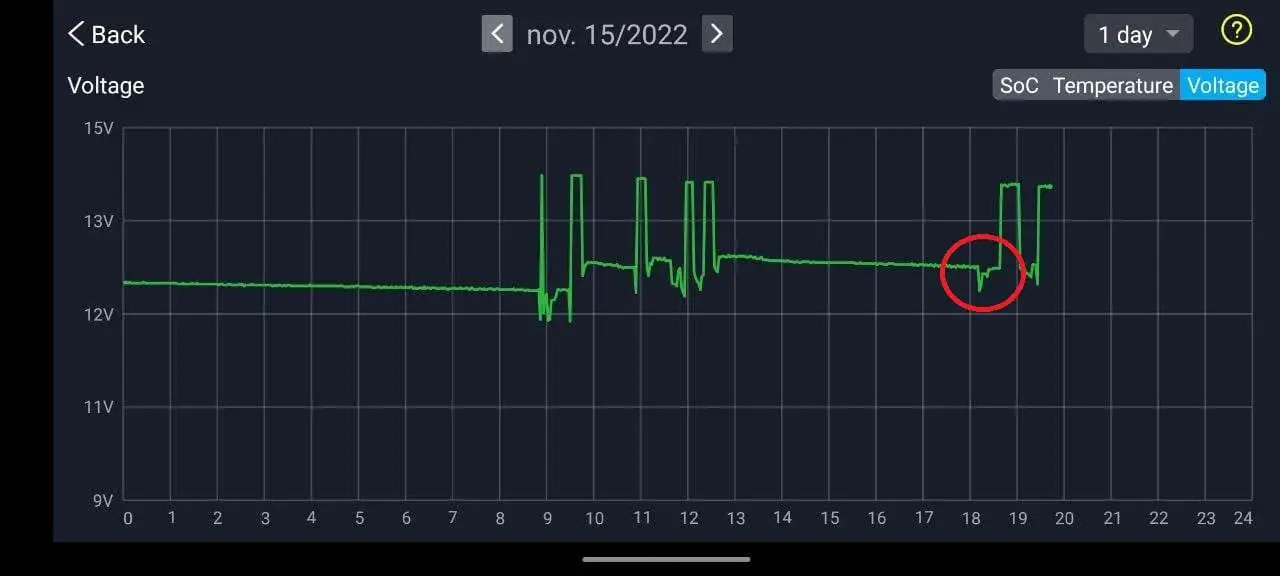

I´m in contact with other owner in Spain with same problem. He take his CX30 Skyactive X 186cv to Mazda Oficial Service, and they didn´t any solution. This user paid for a new type AGM battery (more powerfull), because his CX30 leave around somes times, and had to call the tow service.
He has installed the same battery controller than I, and last night send me a screenshot of his app, and I have detected the same leak peaks.
