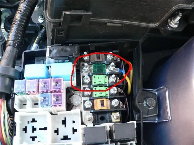

Sorry, let me try to clarify my question... G85 used a crimp connector on his cable and connected that to the existing battery terminal, as seen here:
http://img.photobucket.com/albums/v217/A2_Projects/Projects Gallery/IMG_8508.jpg
So I was interested in seeing how other people are doing it?

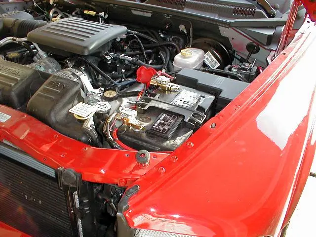

On my Durango & PTC I used a PG battery connector and replaced the hex screw with a post. Attached the PG to the battery and the factory terminal to the post on the PG. Pic attached but it isn't very good, you can kind of see what I'm talking about.
Anyhow, I don't think that will fit under the battery cover on the MS3. Any ill effects of not running with the battery cover?

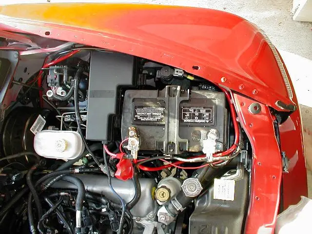

I did it this way. Very clean and the wire is protected with a fuse.
