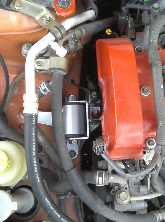

I have a friend with a boosted p5 that broke a couple of his mounts at the track and now he is back on stock mounts. Here is a pic of my pass. mount. It took me a few minutes comparing mine and yours to see what you were talking about.
AWR is a stand up company, I had a of set rear sway bar links for over 3yrs that were the wrong size. I called Tony up and he said not a problem with doing an exchange, keep us updated I looking to by the side mounts from AWR.
do you have solid mm front and rear as well ?
engine jolting back and fort from not having solids in front and rear of it will be your best bet of pass. mm failure
edit: options would be solids front and rear mm's and get a replacement from AWR or solid front and stock + inserts rear mm and get replacement from AWR or go with stock + inserts pass. mm.
