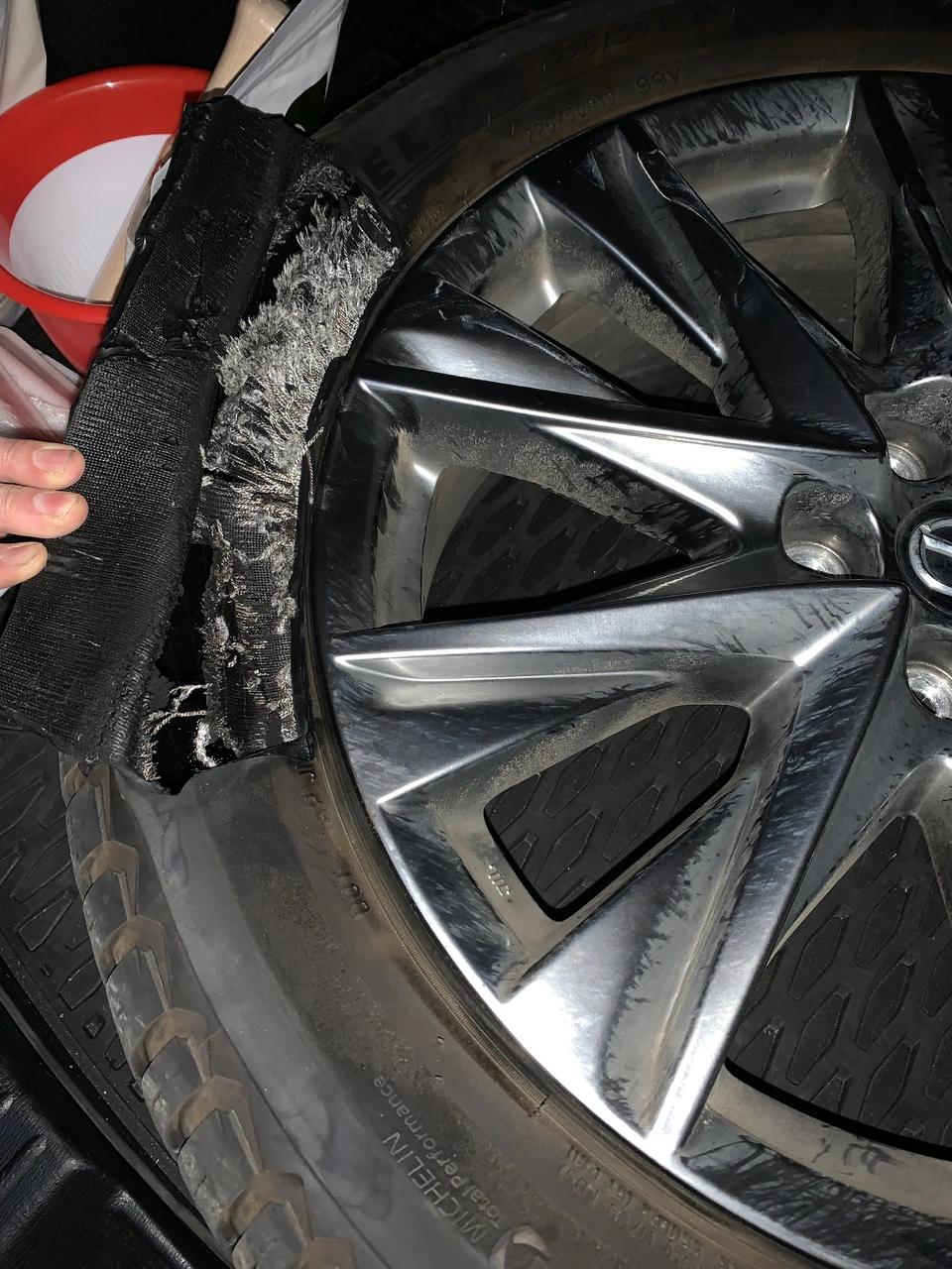

My better half drove about 20 miles with a flat. She has never experienced a flat before so she thought she was being chased by a helicopter (these were her words, not mine). The sidewalls were completely shredded. I need to have the rear diff checked out once the tire has been replaced.

Yeah…in hindsight, I prolly should have gone over some basic safety stuff with her. She was like… I can’t stop on an expressway. I had to keep going. 😩
I would still stop on a catastrophic tire failure though. The wheel was smoking by the time she got home.
Absolutely. Get off the road so you don't cause an accident that will involve more cars. Glad that didn't happen.
