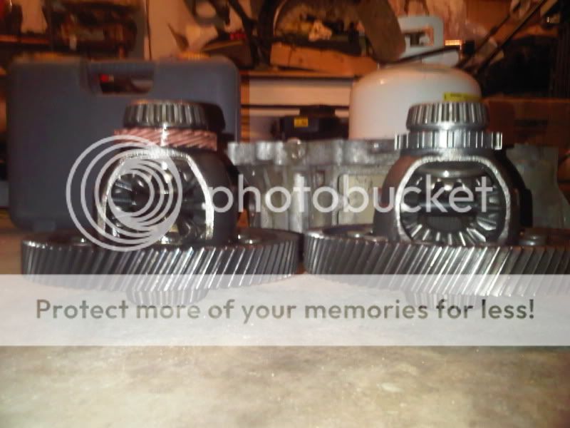

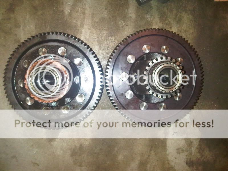

some interesting things about the atx diff to the mtx diff:
The final gear is different in size, the mp3 diff is smaller in thickness.
over all diameter looks to be the same, however i haven't measured to be sure.
the actual diff looks super similar but there's some differences:
the spyder gears are different,
the needle bearings are bigger on the m/t,
the spline count on the spyder gears are the same, but the m/t has a bigger diameter hole.( i need to see if the axles are different on the m/t vs the a/t: confirm?).
the rod(?) that the bearings are on seem to be the same, just the bearings are different.
so i'm thinking i can bolt on a torsen based LSD onto the atx gear, press on the VSS ring and the atx wheel bearings and voila LSD on the ATX.
pictars!!
the quaife
atx vs mtx
