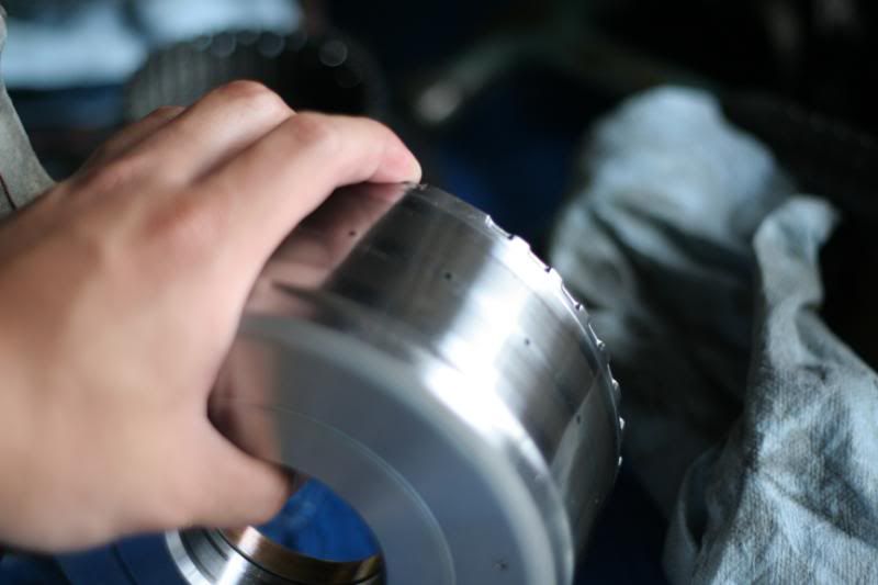

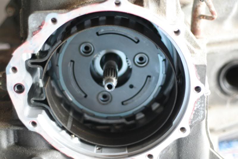

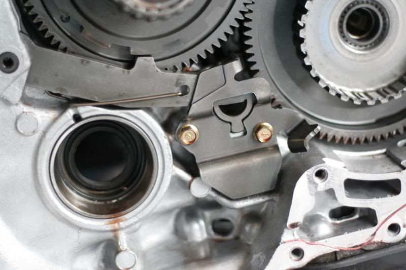

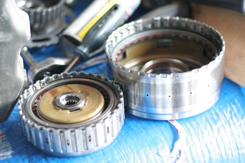

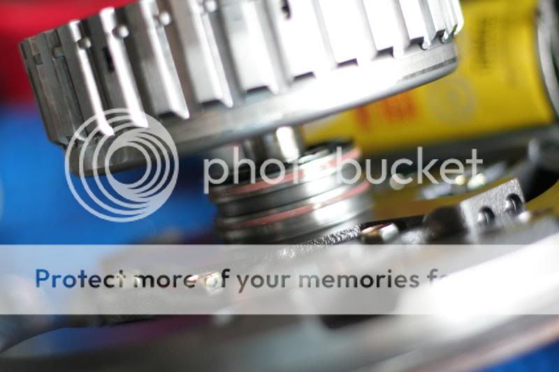

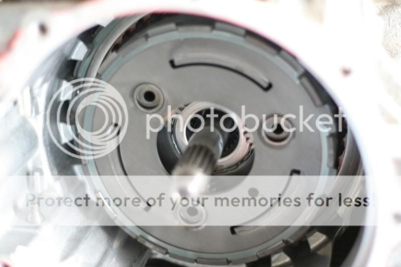

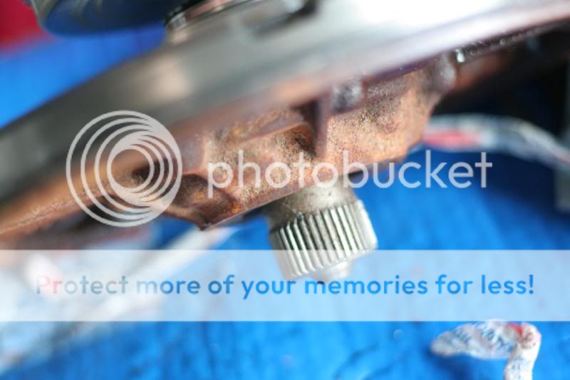

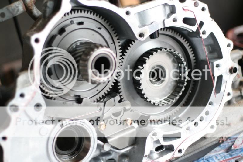

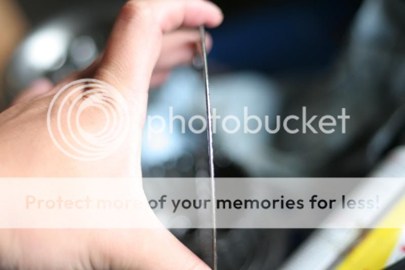

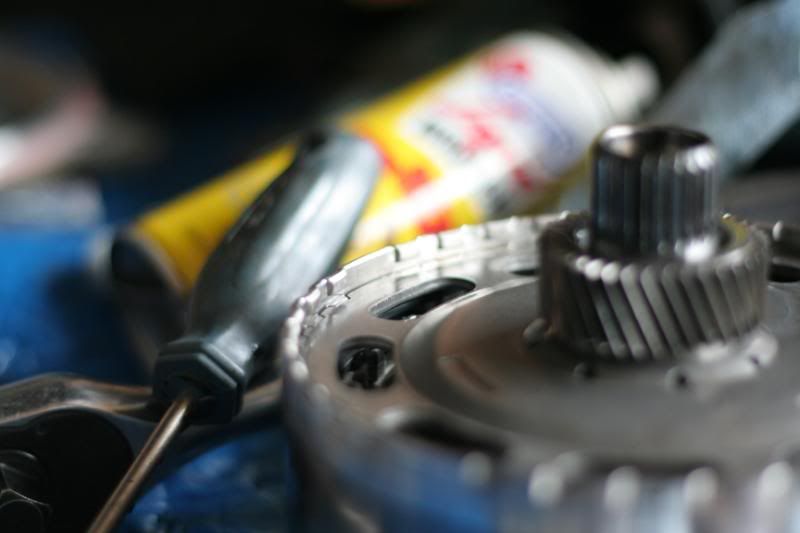

The side cover removed, overdrive band and the drum with arrows showing the wear areas,
if the drum is worn it needs replaced.

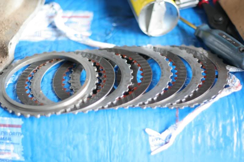

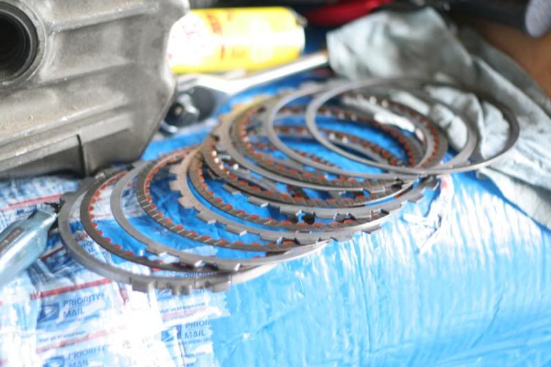

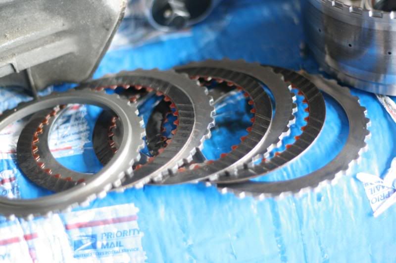

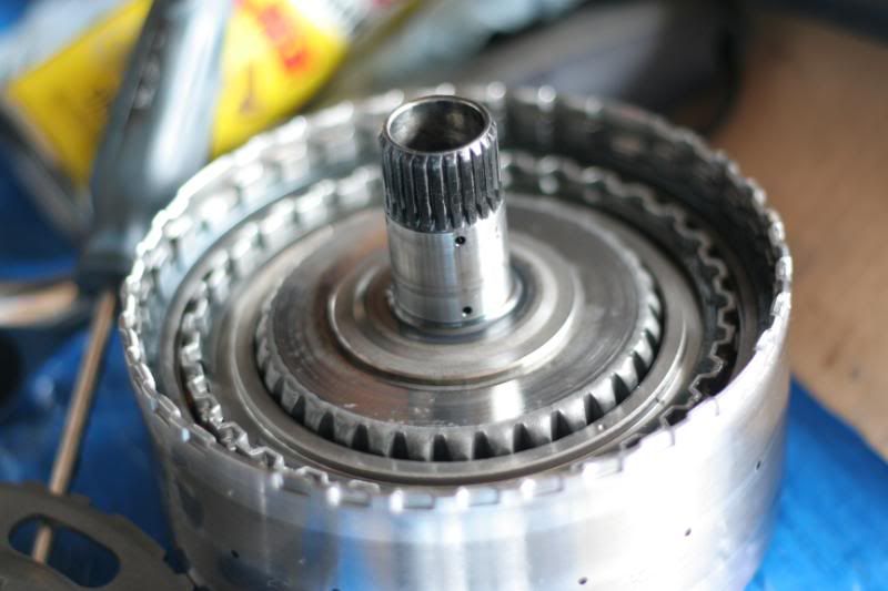

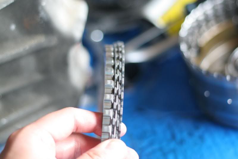

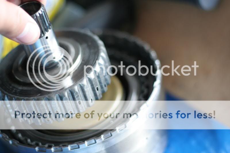

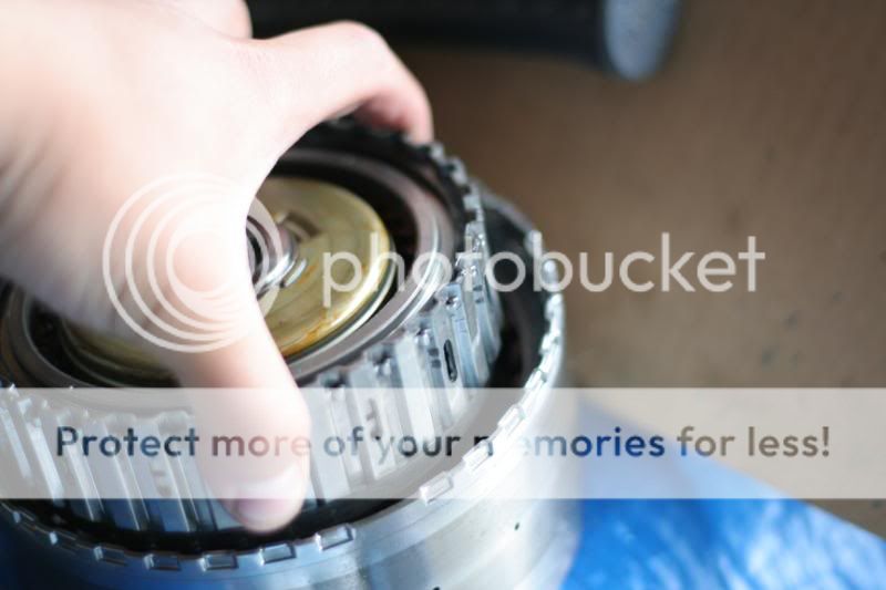

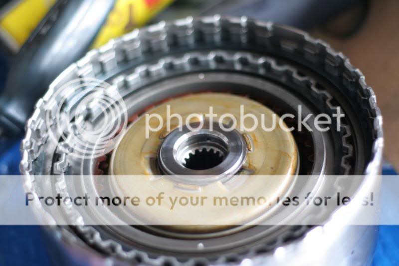

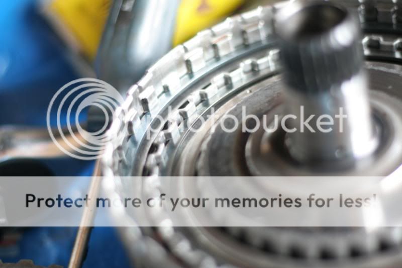

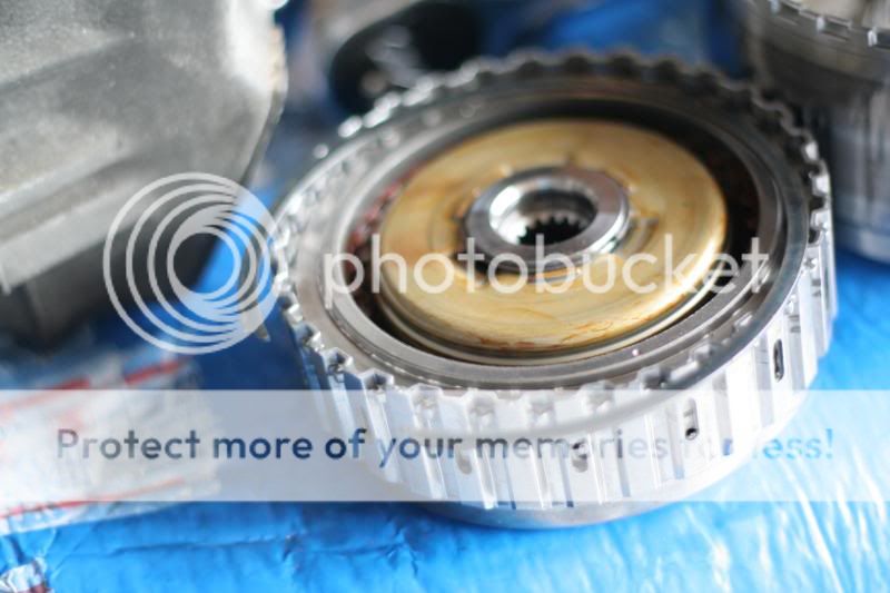

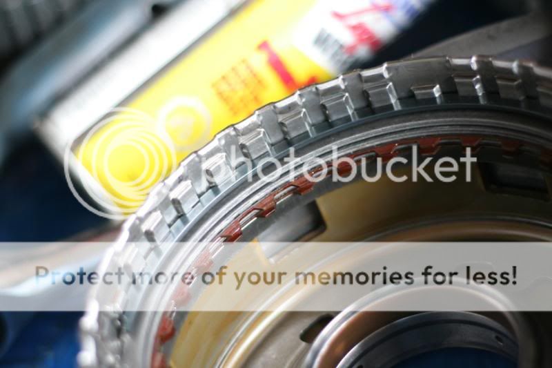

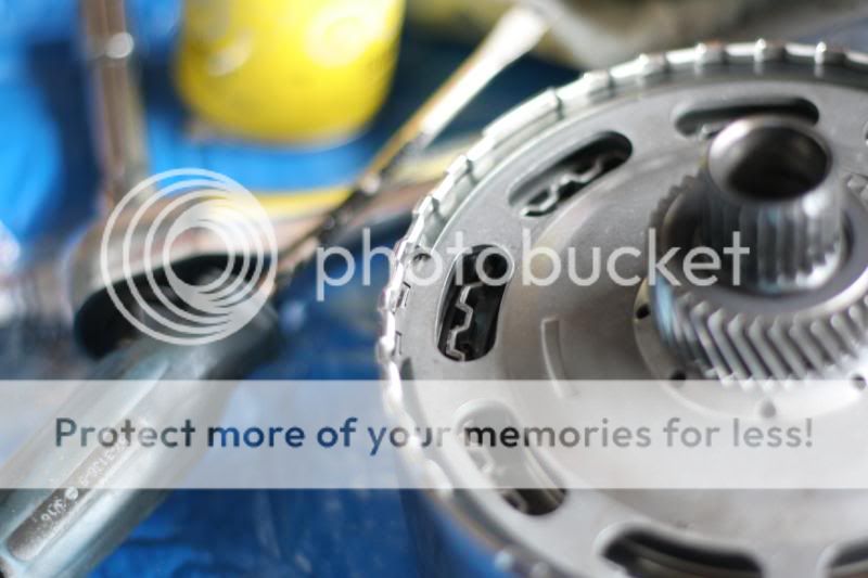

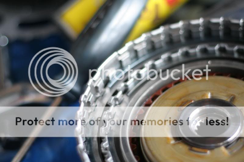

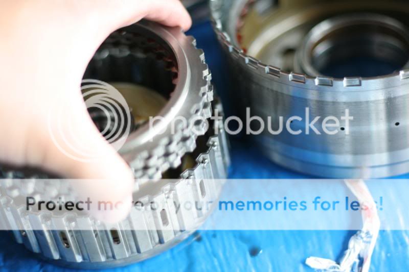

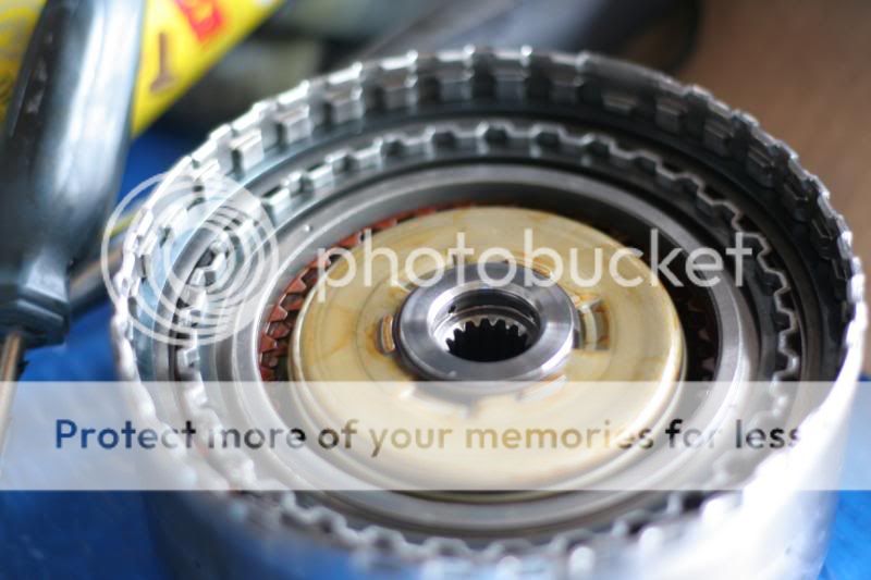

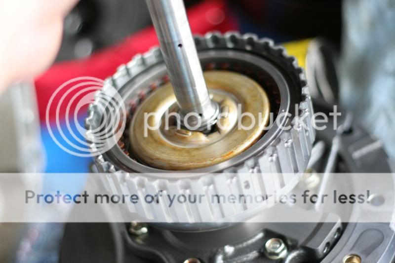

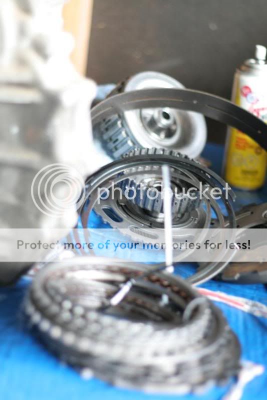

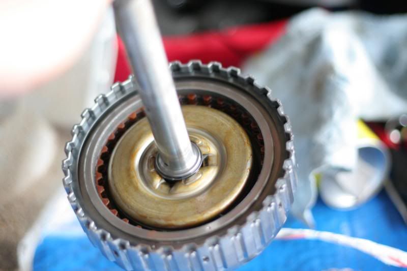

Next is disassembly of the drum , this pic shows the direct clutches, stock three top, and replacement clutches bottom, (note they only used 4 clutches and steels) the kit includes 5 but some people have had trouble fitting all five in, mine was a tight fit but I got all five in.

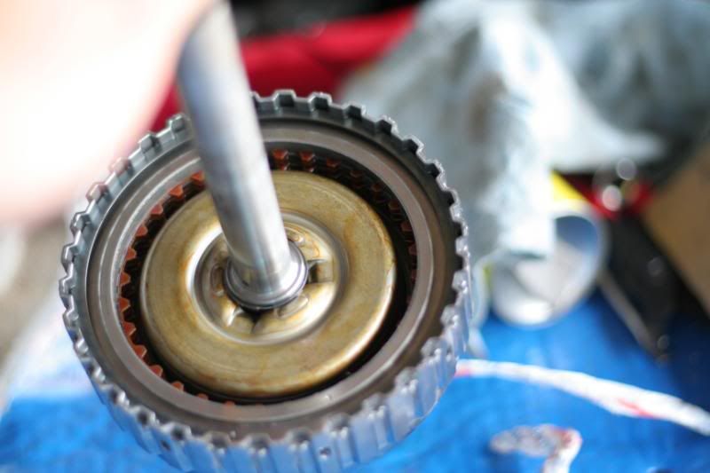

barrowed pic my direct clutch looked worse than that!

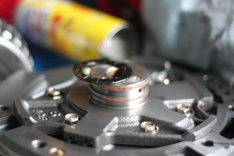

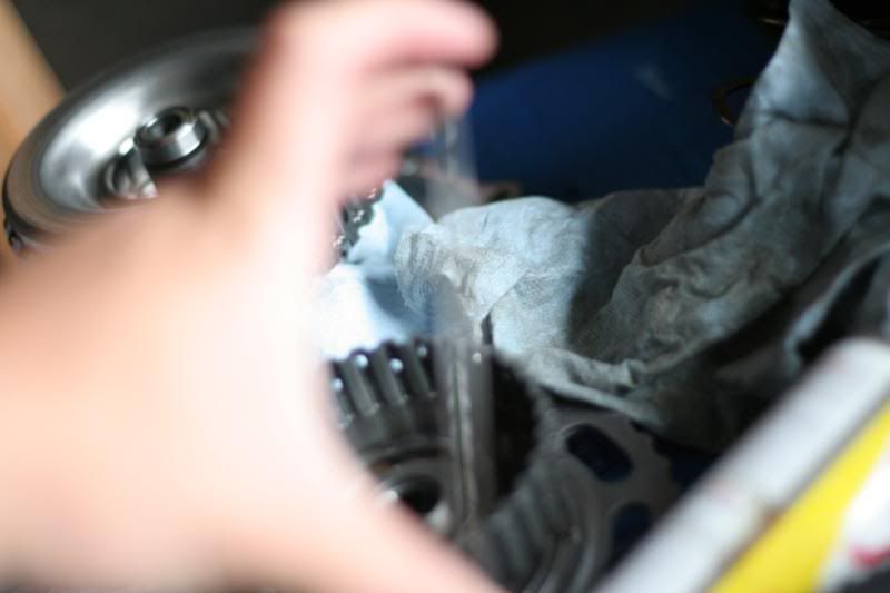

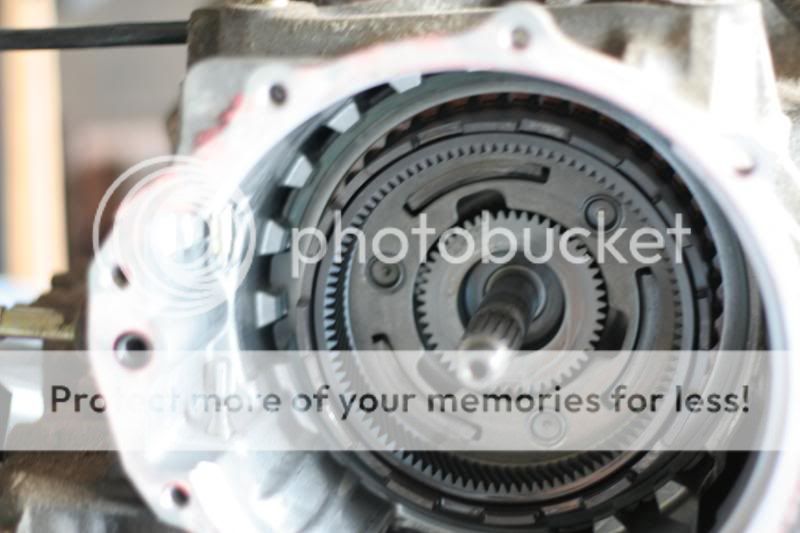

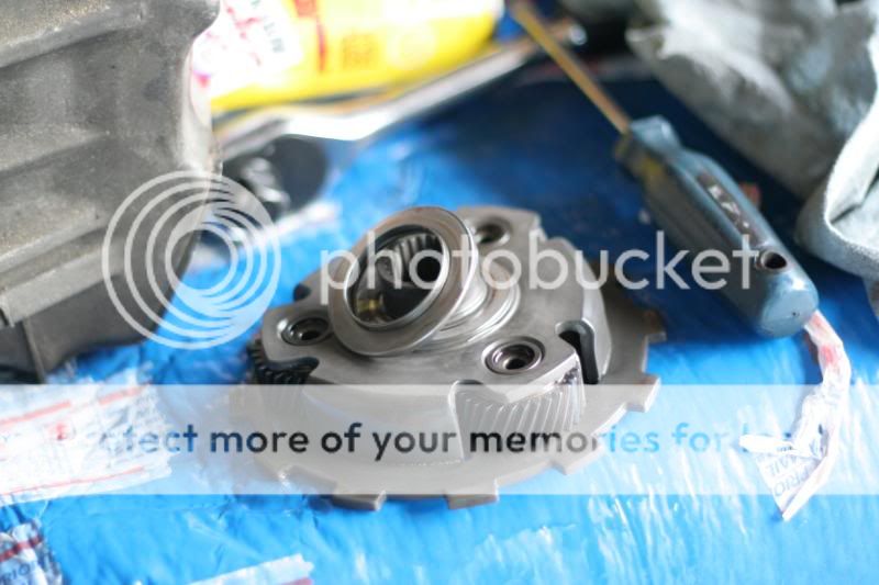

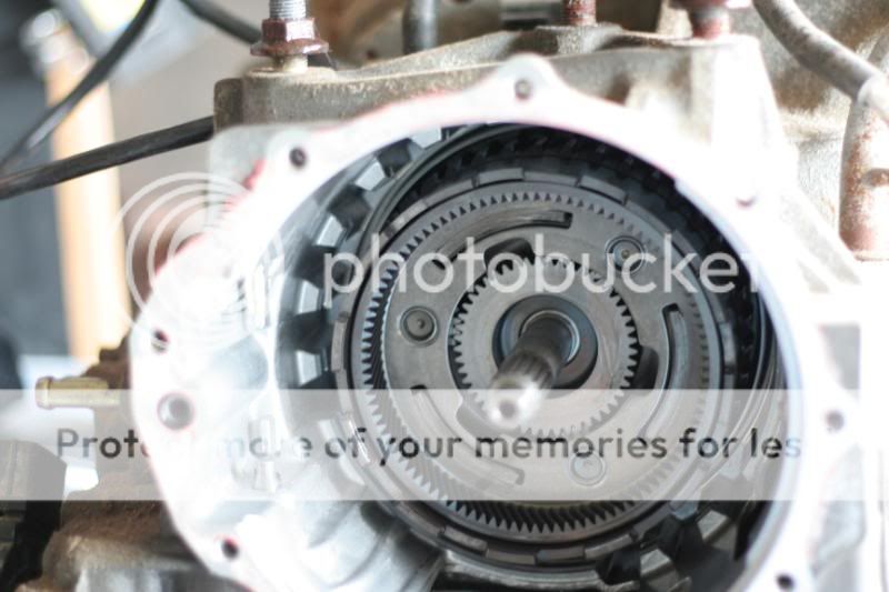

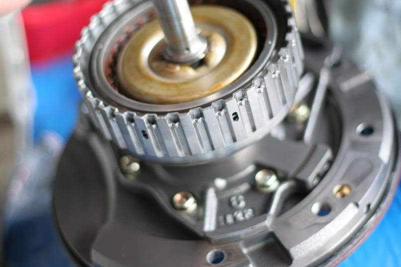

The planetary gear set is then removed inspected.
The kit I used for the upgraded clutches and steels Alto part #133750 AHPPWR
This kit has Alto redlined clutches kolene steels and has the infamous powerpack upgrade for the Direct clutch, This is a problem prone area in these tranmissions. Stock there are only 3 clutches and 3 thick steels, which in itself seems odd becouse everywhere else it uses at least 4, the kit gives you 5 clutches and 5 thinner steels, and with a little effort fits easily, this set-up is alot better than stock.

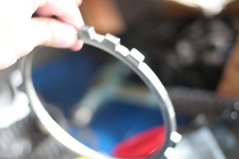

I also used Alto hd redlined band part# 133961
There is also tool to check the band, it is not adjustable like other transmissions, it is adjusted by a bolt on the case, you have to have the tool to check the lenght of bolt needed, and then most likely order the bolt from mazda.

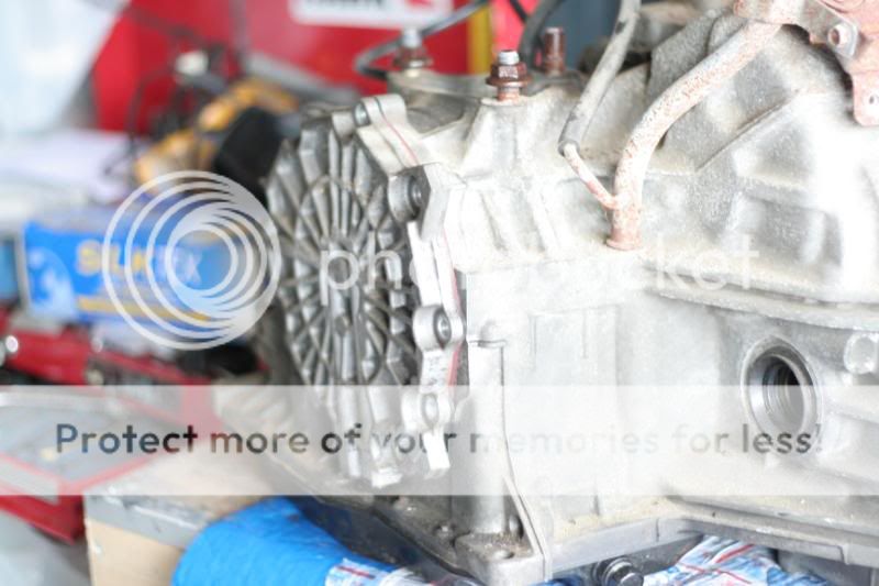

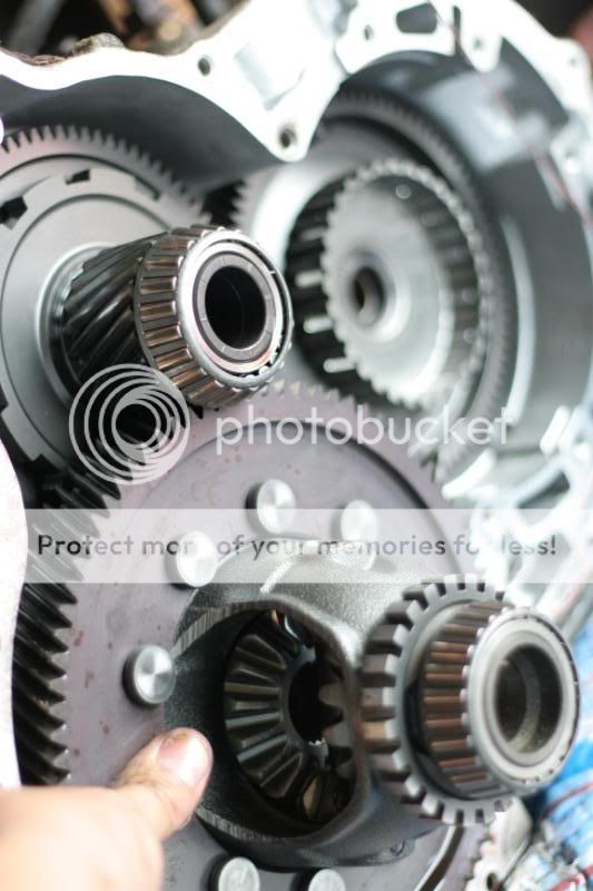

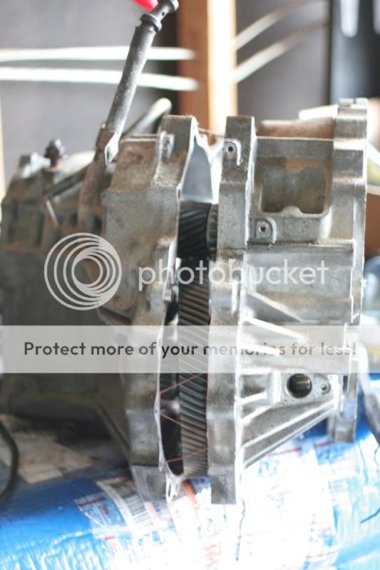

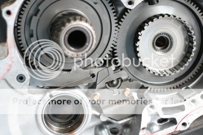

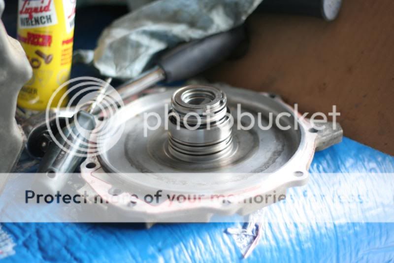

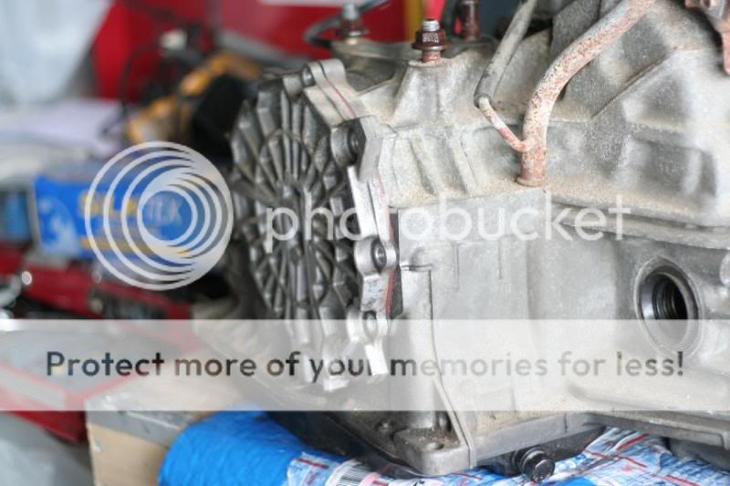

The case split in half

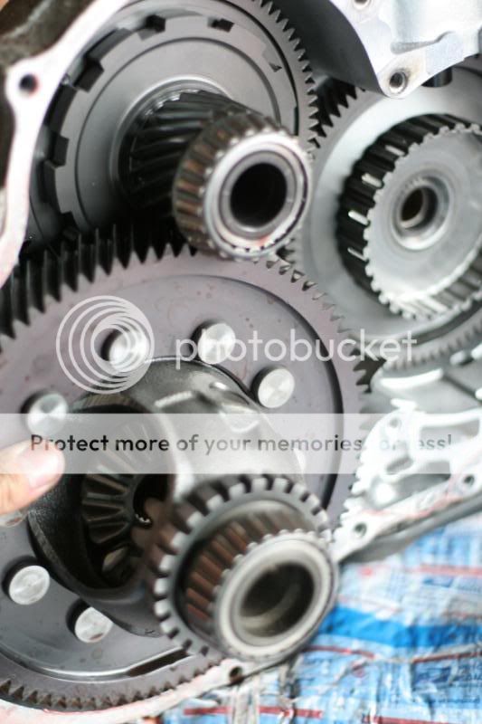

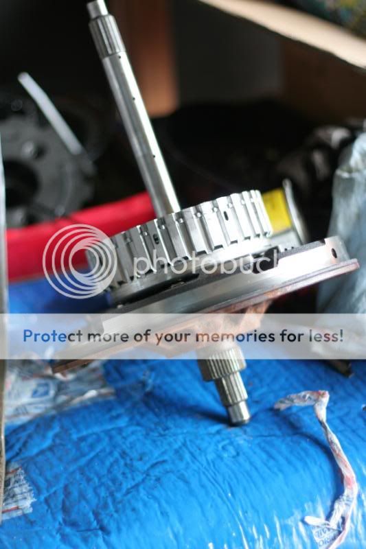

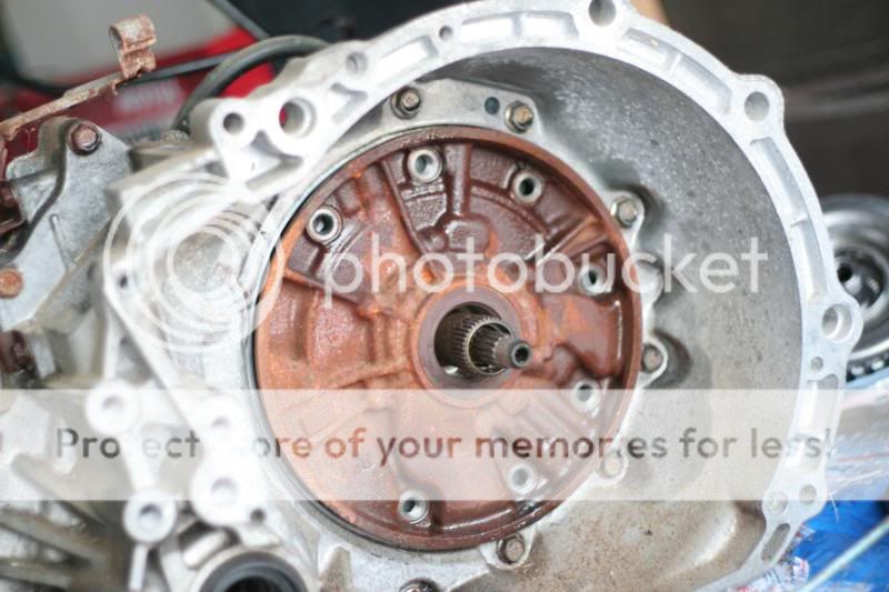

Pump removed, input shaft can now be removed.

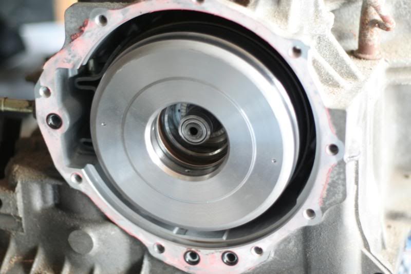

I bought a ford racing kit #
it has upgraded converter and the billet input shaft.
(note this kit has been discontinued by ford racing -however TCS makes the converters, and they or lentech made and can probally still get the shaft)
The converter in the kit is for a focus and the bolt pattern to the flywheel is just a bit smaller, I had a machine shop redrill my stock flywheel to fit the converter, cost about $20 the shop said they did this type of thing all the time. Ive ran a few thousand miles and had no problems.

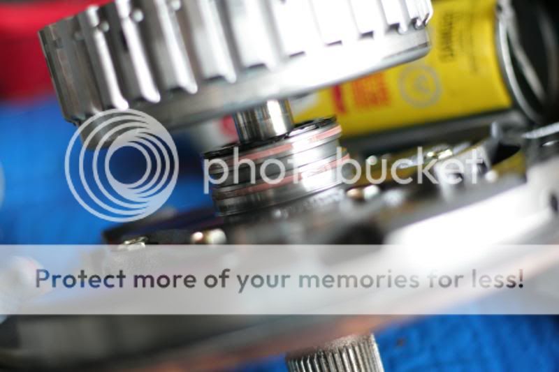

input shaft and moulded pistons.
