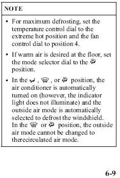

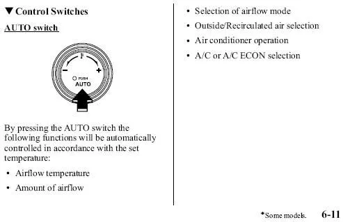

Below are two excerpts from the 2006 Owners Manual...
Yeah my old Mazda3's manual climate controld did something silly like this too. As soon as the position indicator is turned to the floor, defrost/floor, or defort, the a/c comes on. But the a/c light didn't come on.
It was buried in the manual.
98strat, I think we are in agreement. I'm saying that when the ACC is on, so is the A/C system. The compressor will continue to cycle, though, if the air is directed to the windshield, windshield/floor, or floor-only. Ambient temperature is not a factor.
Antonio, no, I am not a Mazda tech. I have spent literally hours trying to verify this both on paper and in the real world. I don't have any better paper than what's posted in this thread, but observing the car has been very instructive. This is just how Mazda designed it to work, and I think it's fairly foolish and often unnecessary. Fortunately, our car still handily beats the EPA highway estimate, even in town most of the time, so at least the fuel economy side of it is not bad for us.
