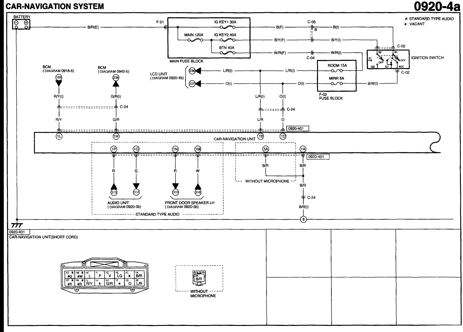

About a month or so ago, I told myself I'd look into it. I pulled the screen out, installed it in the car, and found that the LCD screen is the only part that works. The two additional connections supply the +12VDC that I need to power up the screen on start/acc on.
Now, I'm on a quest to do this in two phases. Phase 1 is simply installing the unit and supplying that 12V to open the unit up. The rough plan is to install a wire tied into the cigarette lighter and using an inline fuse, run power to the connection. I still haven't figured out which terminal(s) need the supply voltage.

Right now I'm looking for a wiring diagram for the nav unit. If anyone has one and can post it, it would be greatly appreciated.
On the back of the unit, there are 2 connections. One is a 1x6 white connector, the other is a 2x12 grey connector. I need pin outs for each of these.
Additionally, there is a pigtail, but that only supplies power/data to the LCD screen, which works.
If you've got the stock nav, you just need to buy that interface I posted up. 4 wires spliced in and you should be set.
I actually just pm'd someone who i think might have this and if they do ill post it to help you out
Steve i got the wiring the diagrams for the nav.. i will post it on here when i get home in about 20 mins
okay i got it.. hope it helps Steve

Trying to decipher the wiring diagrams and find where the 12v source comes in. Thanks to amilliems6 for providing me with them, and I'm hoping this afternoon to have it powered up and functional and Phase 1 will be complete!

I did seem to find 3 possible terminals to apply a voltage to and hope to power it up. I'm going to bring it into work this weekend and bench test it before I put it in the car, that way I'm not messing with anything.

Currently I've got two 12VDC lines in to terminals 1O and 1Q on the harness, as well as a grounding spade. The unit will power up, then try to close itself every 4-5 secs, but will not open when the open/close button is pressed. Still trying to figure out where the open signal is coming from.
Still unable to get this working properly. For whatever reason, with +12V and proper grounding, its not working. However, when I put -12V to several of the terminals, it closes and then pulses periodically. I'm not sure at this point what is going on.
