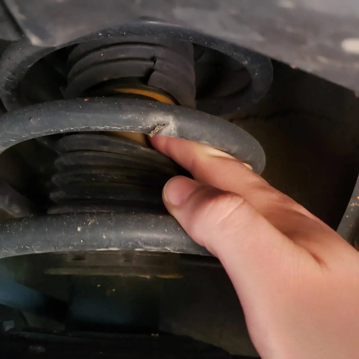

I do at least some DIY so I went to investigate using duct tape or sealant. The boots are actually torn horizontally in multiple places, so much so that they're effectively multiple segments now:
I might try getting some duct tape in there. They felt pretty brittle so I might break more than I fix if I push too hard, but it's probably worth a shot.

I think it might be difficult to tape them without removing them from the coil.
There is this stuff on TV you can spray but how can you position the spray can under there?

Thanks for posting the picture. Well the dealer wasn't lying about the boots being cracked. Do you live in a hot, dry climate? I used to live out in western USA for a time and noticed that rubber components dried out quicker than when in eastern or midwestern states.

Seattle for a few years, now Michigan for a few. Neither has been particularly dry :)
