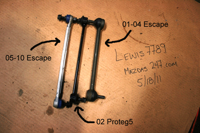

So a few months ago I was changing the front endlinks on my mother in law's 2002 Ford Escape. These endlinks only cost $11 per side so about $22 total.
They fit perfectly, I have been running them for about 6 months now.
So go down to your local Checker/Oriley, Autozone, Napa or what evers. Tell them you want front endlinks for a 2002 Ford Escape.
Its worth it!. 1/3 the price of an oem!
(Picture thanks to Evan)

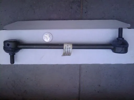

Based on HKPRO5's tip, and my upcoming MSP suspension install, I picked these up today at Autozone for $10 each. They're HUGE, easily twice as thick as OEM, with much beefier looking ends, and included grease ports!!! Pretty crazy! These are Moog brand, whatever that means, 1 year warranty.
Quarter included for thickness reference. ;)

That is almost as thick as the sway. Great find! Doing that on Saturday too Philip?
Moog is an extremely large company that specializes in aftermarket steering and suspension components. They've got a sticker on the side of many race vehicles as a sponsor and have been around for a very long time.
well that's even better, then. I wonder If Duralast just sources from multiple vendors. Regardless, these things are so huge I have no doubt they'll last longer than my car.
I did the MSP suspension install last weekend (thanks o.g.sk8ter!). It went really smooth, BUT...unfortunately we couldn't get the front endlinks off the sway, so we just kept em on. I was set to just use the Moogs regardless of what condition the old ones were in, but it wasn't worth the hassle.
So no side by side pics. We did compare em, and they're less than a half in shorter than OEM. They should work just fine, and are DEFINATELY higher quality than OEM.
