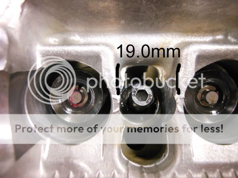

I can't be the first person to have run into this problem... so this is either a warning to anyone else upgrading to ARP head studs, or a chance for someone to point out what I'm doing wrong. lol
First of all, the washers for the studs were just a hair too large in diameter to fit down into the channels in the head, so I had to pull the head back off, stick the washers in place with some assembly lube, and then replace the head.

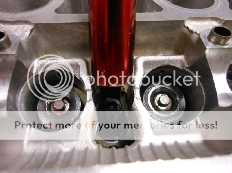

I breathed a small sigh of relief when I saw that the nuts were just barely small enough in diameter to fit down into the channels, but then I find that my smallest 14mm socket is too large in outside diameter to fit into the channel! F***! The channel has a diameter of 19.0mm, and my 3/8 and 1/2" drive 14mm sockets had ODs of 19.7 and 20.6mm
I just did some quick googling, and even thin-walled sockets look like they are going to be pushing the large side of 19mm. Do I have some freakishly machined head, or am I overlooking something dumb here? (entirely possible...)
In case it's not clear what I'm talking about, here are a couple of pics....

Anyhow, I found this yesterday: https://www.amazon.com/dp/ (commissions earned) and I was able to find a post on a BMW forum stating the OD was 18mm, so it should work perfectly. Spending $30 on a single socket really sucks, but I guess it's better than spending $60 on a set of OEM head studs or disassembling the head again to grind those channels larger. Hopefully this saves someone else a headache down the road!

So. I'm officially a damn idiot... it's not a 14mm nut, it's a 1/2" nut. (hand)
Which doesn't make my life any easier because none of my deep sockets are 12-point. The hunt continues....

Are u sure its 1/2"? I just checked my ARP nuts and my 1/2" sockets don't fit, but a 14mm socket fits nice. Did that socket you ordered fit down in the channels?
My nuts were most definitely 1/2". The 14mm socket I ordered DID fit down in the channel, but it was too large for the nuts. To add insult to injury, a 12-point 1/2" deep socket only cost $4 at Menards. lol
If you're sure your nuts are 14mm, I'd be happy to sell you that socket I bought. Shoot me a PM if you're interested.
Are you using 12-point sockets? That was the facepalm mistake that led to me thinking they were 14mm nuts.
My sockets are 6 point, but I just tried my 12 point 1/2" wrench and it fits. Does the 12 point 1/2" deep socket fit down in the channels?
Yeah, a 6 point 14mm will fit on there, but a 12 point will be too big. And trying to put 90 ft-lb on those nuts with a 6 point socket would be bad news.
The channel is 19mm wide. So if you don't have a calipers, just see if it's smaller than a 19mm wrench I guess. lol
Yes, the 12 point 1/2" fits, I've used mine on multiple occasions on two different heads. Its a cheap kobalt socket from lowes. It was like $4, and you should def only use a 12 point socket, do not use a 6 point
