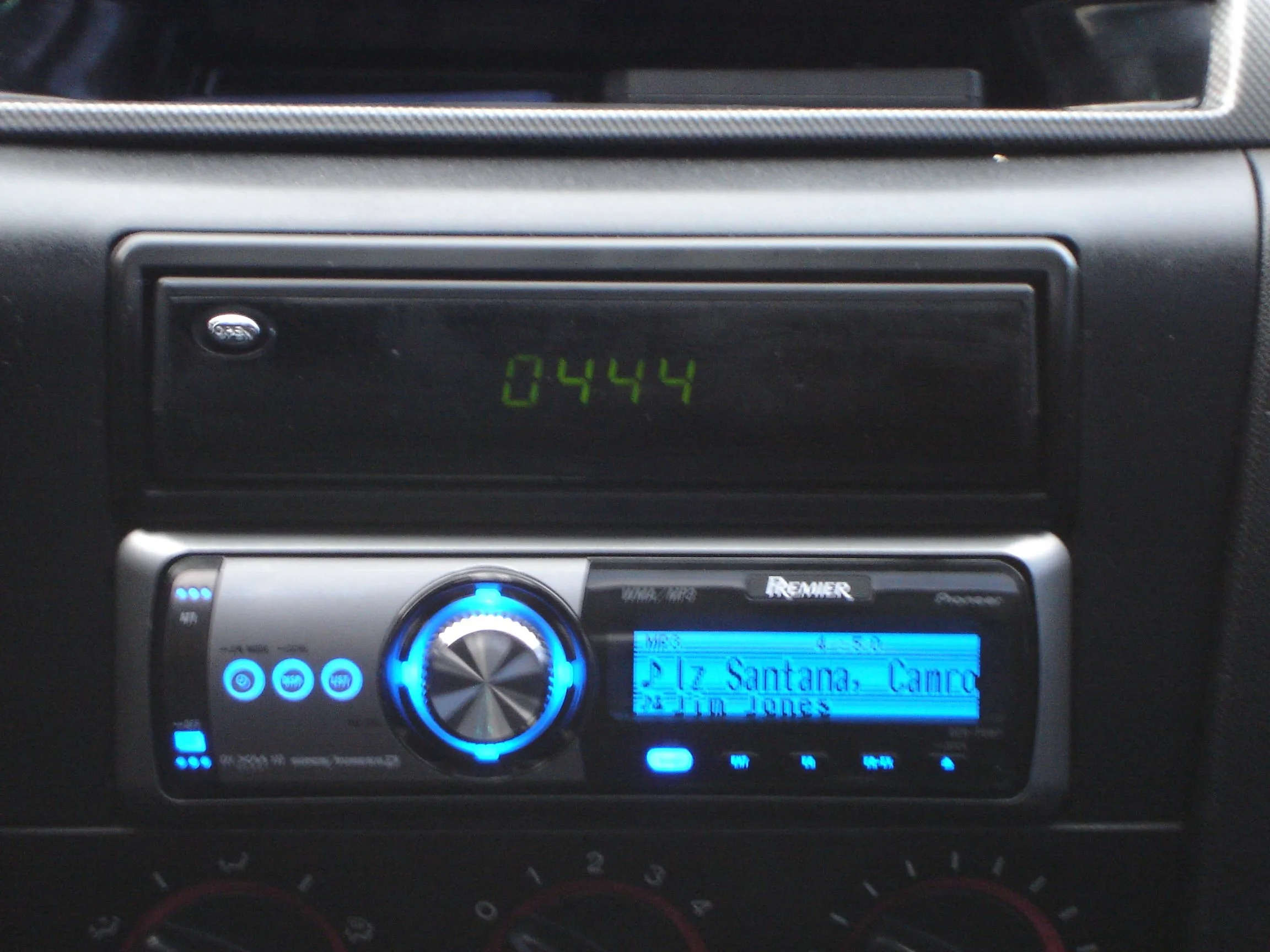

I used the kit for a double din setup, then changed it to a single....Here's the double din pic. I don't have a single pic..

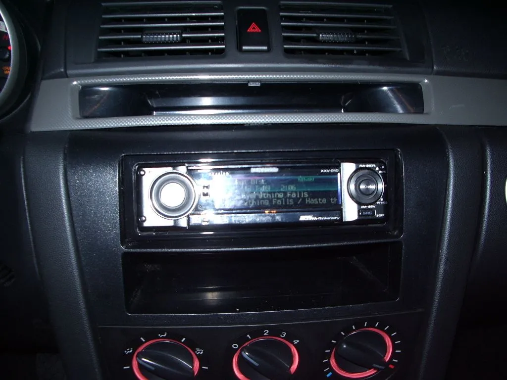

I used a metra Dash kit on my 3....
Link With Pics
