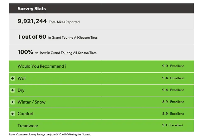

Priortized for comfort:
https://www.tirerack.com/tires/surveyresults/surveydisplay.jsp?type=CSTAS&sortValue=20#ratingsSort
For some reason the CrossClimate2 didn't show on that chart. Here's the ratings:
