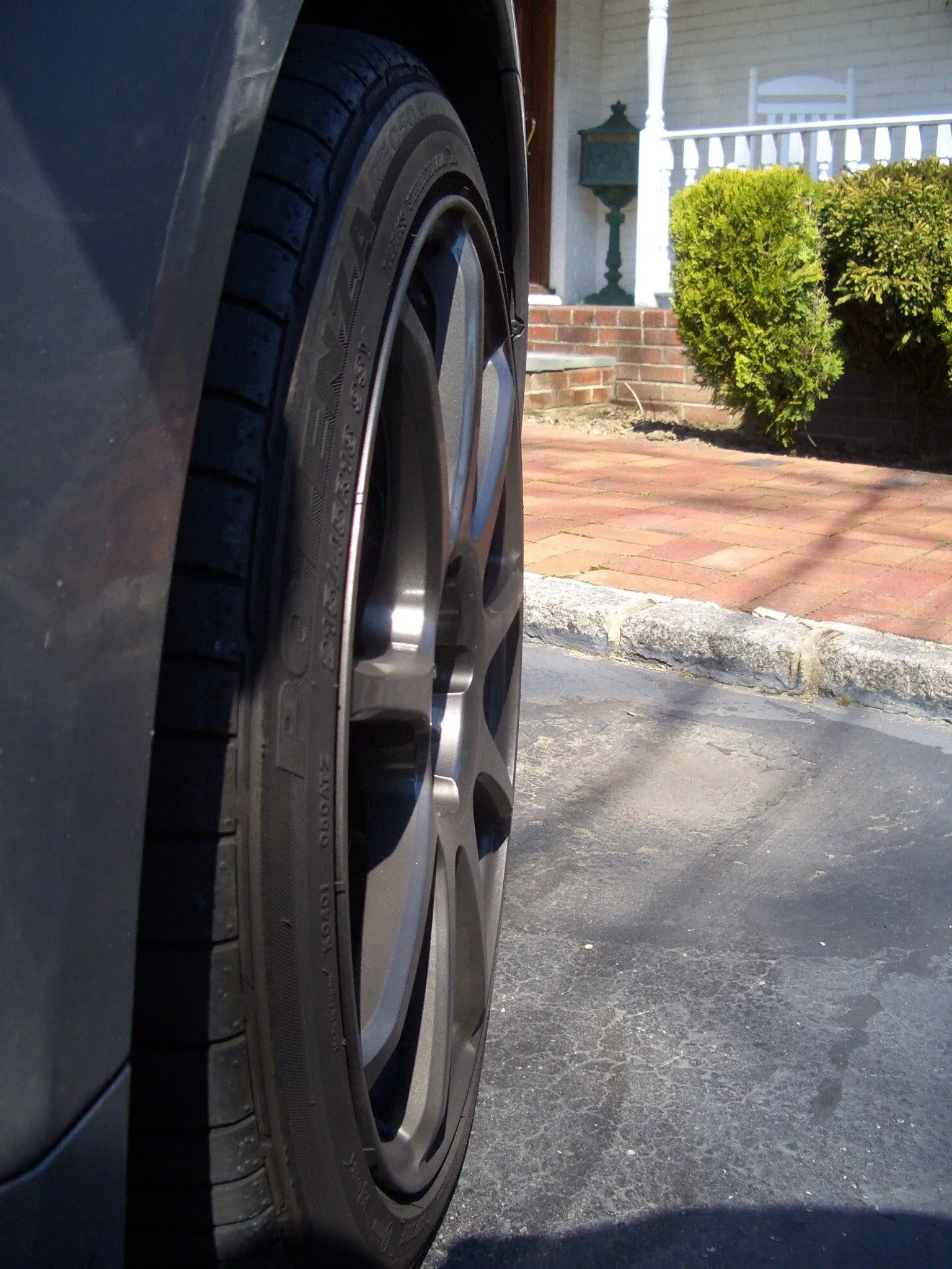

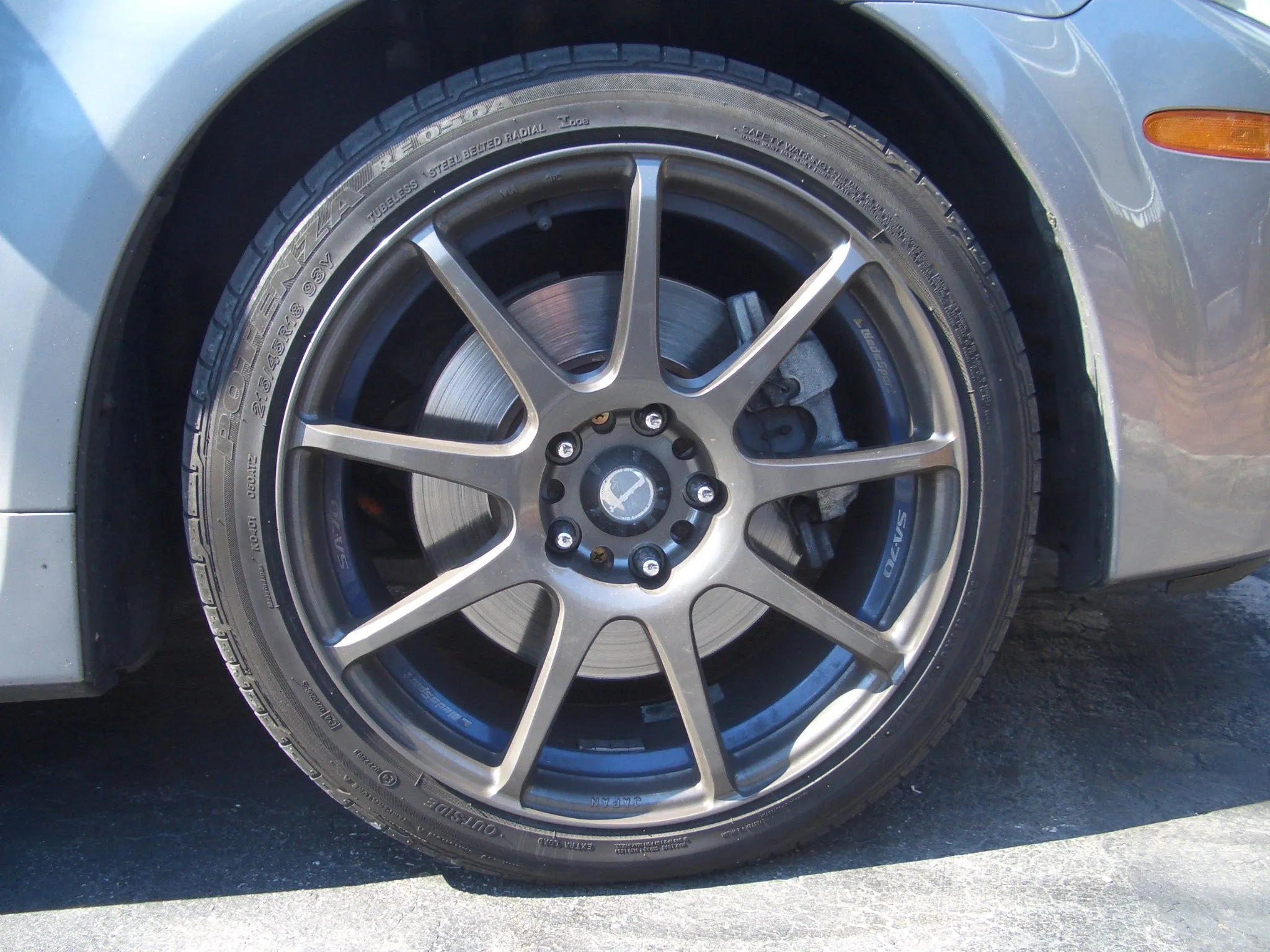

I just mounted the stock potenzas on other rims (same exact specs though...18" x 8" with a 50mm offset) and they fit fine. BTW, they are wedsport sa70s. The outer edge of the rim sticks out a bit from the tire but it's not too bad. I'll post a pic in a few days when the weather clears up.
Thx LawMan - if you can, get a pic from the edge facing the tread so I can see how much the rim sticks out.
I was thinking about doing the same thing. That way I can use the stock rims with some decent all seasons or snow tires for winter.
Hey here are the pics. Sorry it took so long.
Looks a little bit stretched...but I can live with that until I wear out the stock tires.
