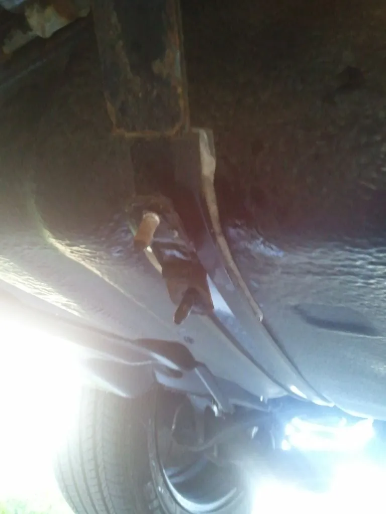

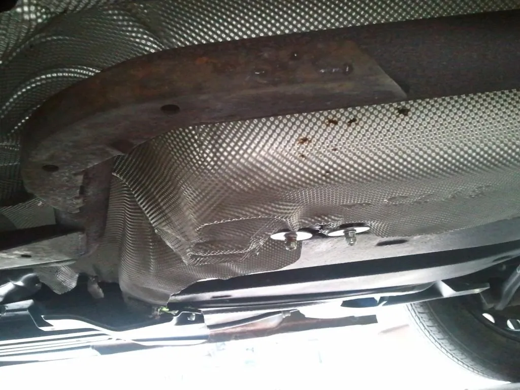

My wife informed me she was getting a really loud rattle when idling, and a scraping sound on occasion when driving up concrete aprons off of the street. I looked under the car and the gas tank heat shield was folded down and bent over. Her Mazda5 is a 2007. The little nuts that hold the heat shield in place pulled clean through it because the heat shield rotted out around them. The studs that the nuts go onto were rusted badly. I soaked them in penetrating oil and I was able to get all but one off without breaking them, but I was very irritated to find that the studs that attatch to the gas tank straps do so on a little sheet metal ear that hangs down. When you try to loosen the nut, the whole ear bends. I ended up using a vise-grip to hold the ear and a 3/8 drive ratchet with a 10mm deepwell socket to get the nuts off. My preference of course, would be a 1/4 inch drive. I had to loosen it a little, soak it again with penetrating oil, tighten it, loosen it, etc. to get each one off without breaking them.
Eventually, the hardware store opened, and i was able to buy the new M6x1.0 pitch nuts and some stainless fender washers to hold what was left of the heat shield up. I put a bunch of antiseize on them and two nuts per stud (the one on the washer was a flange nut and the one on the end, i used a nylock to keep the water and salt from getting on the threads). I could have just cut them shorter, but I didn't want to break out my air tools and fire up my compressor that early in the morning.

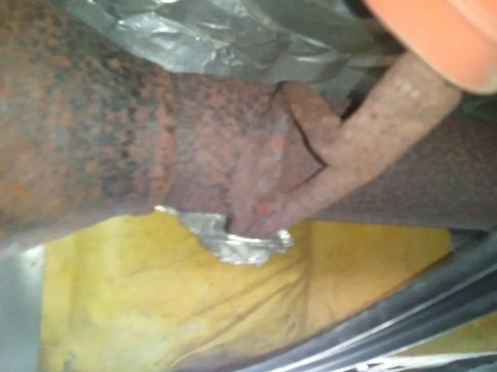

Another thing I noted was that in front, right above what looks like the catalytic converter setup, there is a heat shield in the tunnel for the exhaust that is essentially aluminum foil wrapped over some fiberglass insulation. Half of the foil is gone and the insulation is exposed. Is this thing in danger of catching fire? Do I need to order a new shield for it and pull everything apart (exhaust, crossmembers, etc.) just so that I can know my wife and kids are going to be safe? Can I even get a new shield? I would think there should be a recall for an issue like this BEFORE something bad does happen.

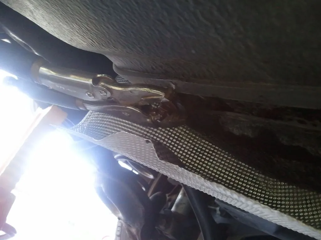

Before:
After:
Header wrap. We don't get too much rain here, so its held up really well over the last 4-5 mos. If I drive like a madman, I can smell it a bit when I park. My wife has never smelled anything tho.

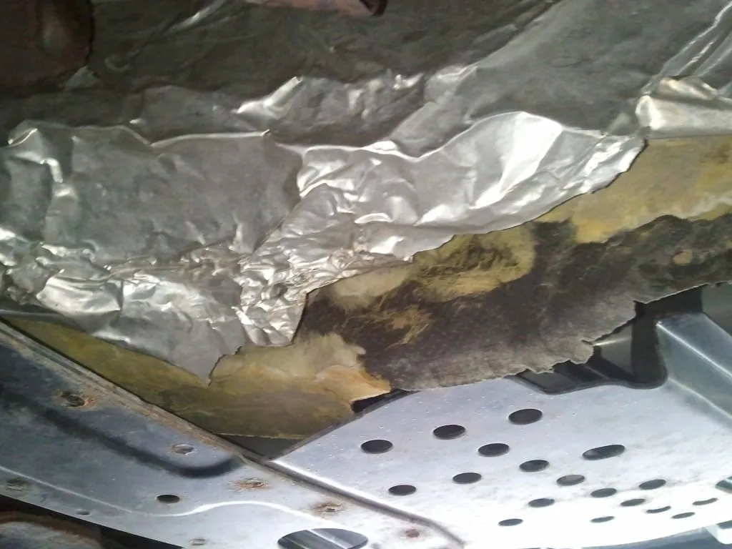

I'll definitely look into this further then. I don't want to chance anything. Looking at it again last night while I was underneath doing an oil change, it is much worse. The foil has fallen down off of the fiberglass altogether, and is what is left of it is balled up on top of the exhaust now. I read somewhere about a recall for the Mazda5 for vehicles driven in the manual mode of the autostick. Supposedly they installed some sort of heat shield, i am unclear as to where, and there was also a re-tune to prevent ridiculous rpms in manual mode. I checked and the there are no outstanding recalls at this time. Incidentally, we never drive our 5 in manual mode. I suspect the heat shield deterioration has more to do with the heating and cooling cycles and, of course, the shoddy materials utilized. I wonder why they used fiberglass at all. Did you notice a difference in cabin noise levels since you removed yours, thaxman?
Header wrap isn't a terrible idea, but we do get some nasty weather here, and so far this summer, it has been raining almost constantly. I would be hesitant to put it directly under a car, as I have seen what it does to headers over time in engine compartments around here. Even if i have to buy the part and put it in myself, I just want to know my family is safe. I just wish there was a better alternative to the retarded foil on fiberglass.

Oh, and no noticeable noise or heat difference inside. Of course, I already pulled the resonator box out of the intake, so I can hear a tad more noise from that mod. If I drive it a bit harder tho, I can smell the header wrap a bit when I park, even after 6 mos.

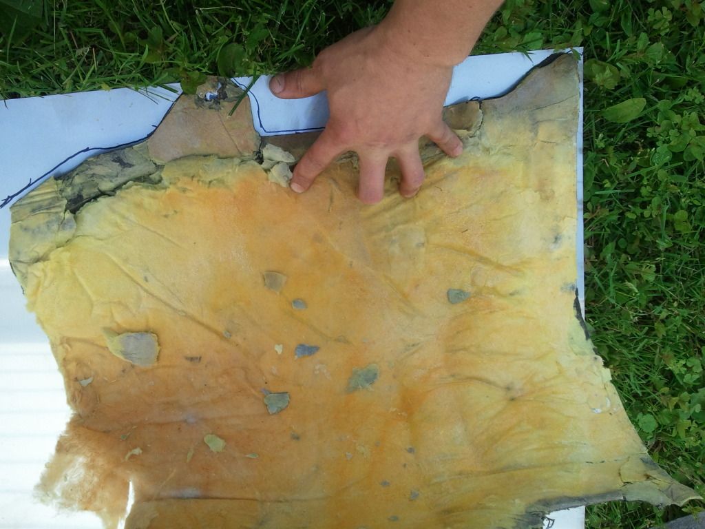

I am going to make one. I think a 24 guage thickness would be easy enough to form. I ordered a piece of 24 guage 304 stainless that measures 2 feet by 3 feet today from MSC. With shipping it came to $57. Alot cheaper than the dealer cost, and this should last much longer than anything foil-faced. If it isn't enough, I can always add the thermotec adhesive product to it, but I think that would be overkill.
The stainless sheet came today. It was obvious after looking at it that it would be too short. I started by backing the rear of the car up onto some ramps, setting the parking brake, and then lifting the front high enough to get it just about level with the rear. Then I put 4 jackstands under the front for safety. Next, I removed the 4 bolts on the smaller crossmember (behind the one that goes over the brake lines). One of the ones on the driver's side broke off, so i had to drill and re-tap the hole with an M8x1.25 tap. Next, I removed the plastic push-rivets, and of course, one of them broke as well.
All of the foil was hanging crumpled up on the top of the exhaust so removed it and balled it up so I could get to the fiberglass. Next, I made a cut through the fiberglass with a shears just above the exhaust by the back of the *second cat* and pulled that section out. Then I worked the rest back down the tunnel toward the rear of the car and removed it. I tried to do my best to preserve the overall form of the fiberglass so i would have a pattern to work with. I carefully laid the pieces together on top of the stainless and found that not only was it not going to be long enough, it would not be wide enough either. One side I ended up having to rivet an ear of scrap on to get the passenger side heat shield secured.
[/URL][/IMG] I cut the stainless off where the fiberglass pattern started to go up the tunnel toward the firewall, as there was no way that I could make that compund bend easily. Then I rolled the fiberglass mess and traced it's profile carefully to the sheet. Once that was done, I started cutting it out with an aviation snips.
