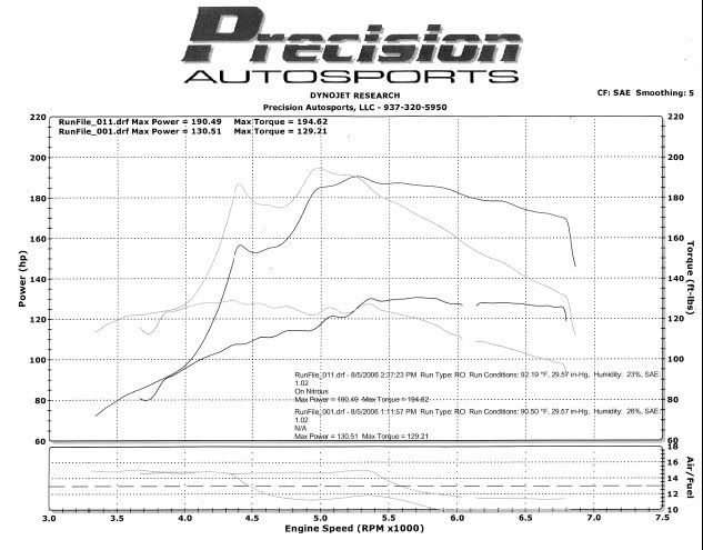

Average WHP is between 175-185 depending on mileage. (Stock).
Lowest stock was 175, highest was 185 I think. Average of course falls between those two.
That particular dyno'd car was also run at the track (stock) and ran a 14.822 @93 mph.
A 6s ATX dyno's around 155-165 WHP. Here's a dyno of that...
Higher # of course is modified. (Thats my old 6s ATX).
6i MTX dyno's around 140 WHP...
6i ATX dyno's around 120-127 WHP...
I can't find the 6i dyno's right now, but you also didn't ask for them. Since the Mazda 3s MTX/ATX uses identical engine/transmission as the 6i MTX/ATX...it also dyno's exactly the same.
Thus the first dyno I gave you.
With a dyno sheet right below that line...thats the 6s MTX stock dyno.
