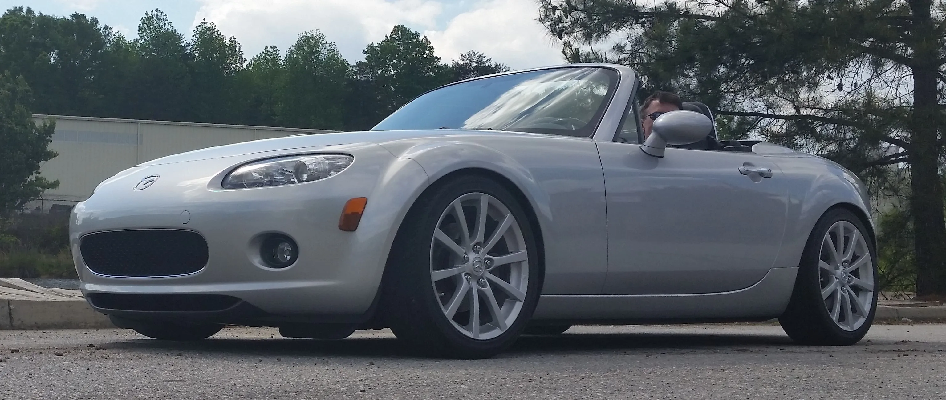

I don't want to buy a set of wheels with a different offset. I also don't want to lower the car. But, pushing the stock wheels out towards the fender of the car would look better. I did this on my MX5 and it looks great (but I also put coilovers on). Has anyone put wheel spacers on? If so, what thickness without wheel stud replacement or modification? Where did you buy them?

25mm. H&R makes them. I did have the fenders rolled as well. If you put 20mm in I think you could avoid rolling the fenders. The kind I bought bolt to the hub using the original studs and the spacers have their own studs that you bolt the wheels to using the original lug nuts. But, a 20mm spacer may also cause the original studs to contact the back side of the wheel when you bolt it on. I know with 25mm you won't have that problem. I found somebody local with the correct tool to roll the fenders and he came to my house and did it for $80.
