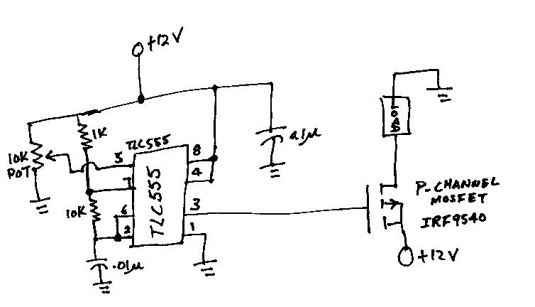

Here is a block diagram of what I think you are asking. You can use a SPDT relay to switch between the original and modified PWM signal. I do not know what you are trying to control but if it is just lights then I already have used a PWM circuit as a dimmer for the dash lights on my 78 Spitfire. The only thing missing is the delay circuit to control the relay.
Delay circuit to control the relay? Is this diagram of a PWM circuit? What is the load in this situation, the dash lights?

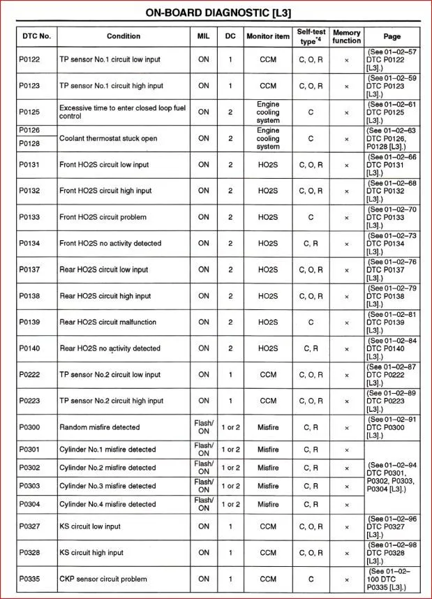

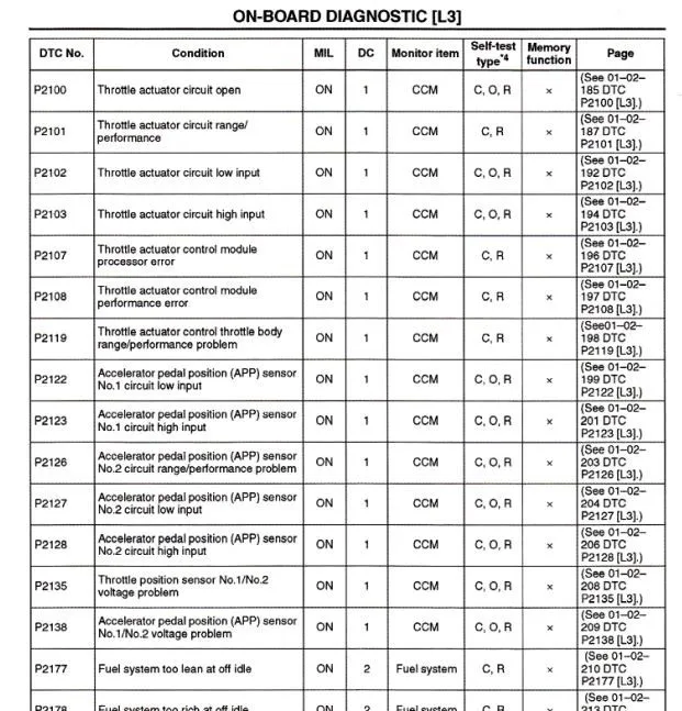

I will check the cel codes related to the throttle by wire subsystem when I get home. Usually the error codes gives hints as to how the thing works.
CEL related to the throttle by wire
I scanned the pages that had the codes for the throttle by wire for 2006 GT.
As you can see it has quite a lot of checking with regards to the the pedal position, throttle actuator, and throttle position sensor readings. Although it does not have yet the 'brake override' feature (avail. in newer models to eliminate possibility of unintended acceleration).

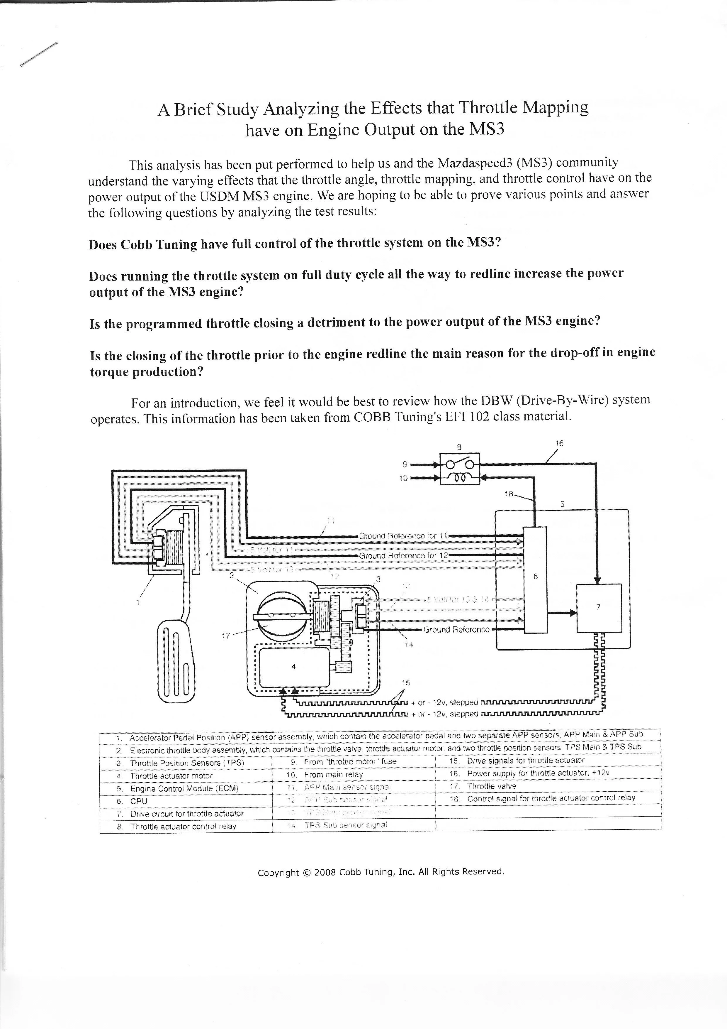

I included a page I once got from the internet showing the throttle by wire block diagram.
Let me know if you need the page for a particular CEL.

Thanks skyhawk. This definitely indicates a 12v stepper motor for the throttle. I still haven't gotten a chance to investigate, but hopefully the harness for the TPS's and throttle motor aren't together, that'd just be too easy.
Do you have the pages that correlate to the 'P' trouble codes? Section 01-02-##.
