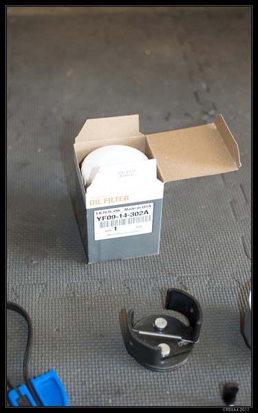

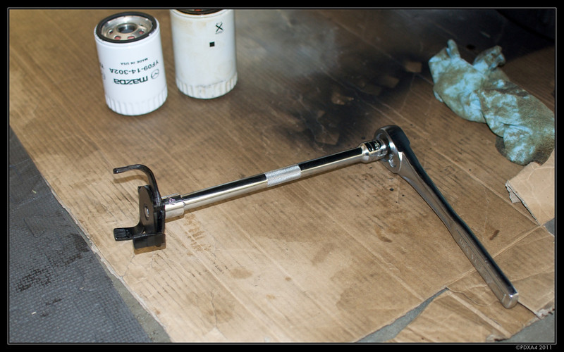

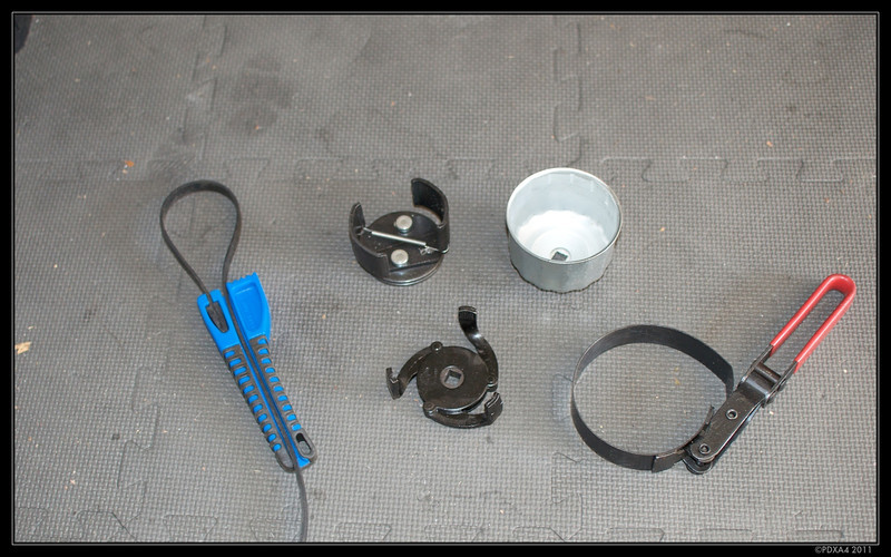

Knowing how hard the oil filter is to remove(both from reading the forum here, and also experiencing the same on my MX-5) I was well prepared with my various oil filter removal tools...
OEM filter ready to go...

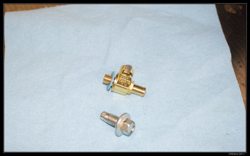

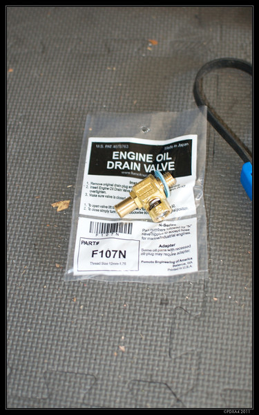

As well as the Fumoto drain valve...

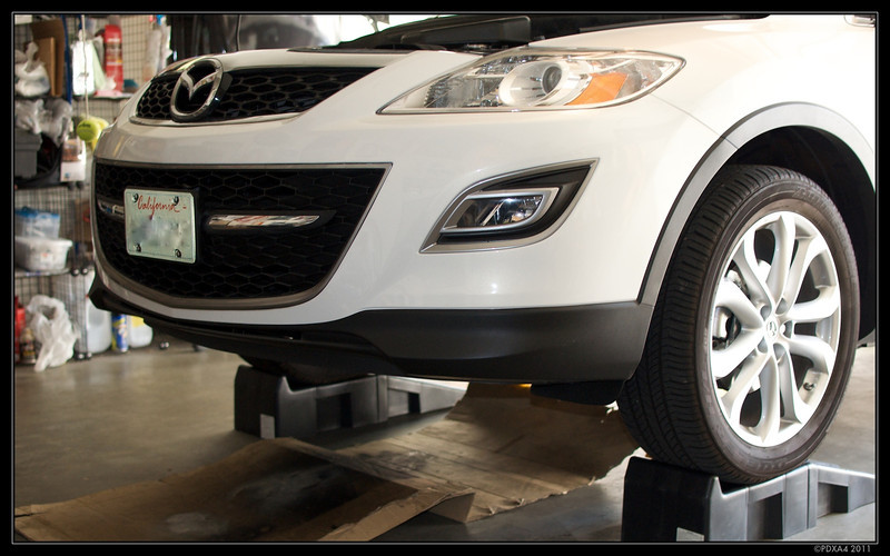

Put the car up on ramps, as well having jack stands under the car for extra safety...

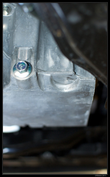

Easily located the oil drain plug, and you guys were right about the oil pan being sharp - I've never seen a car like this before with a unfinished cast part.
15mm wrench to remove the drain plug...

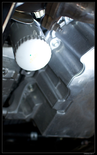

Original filter...

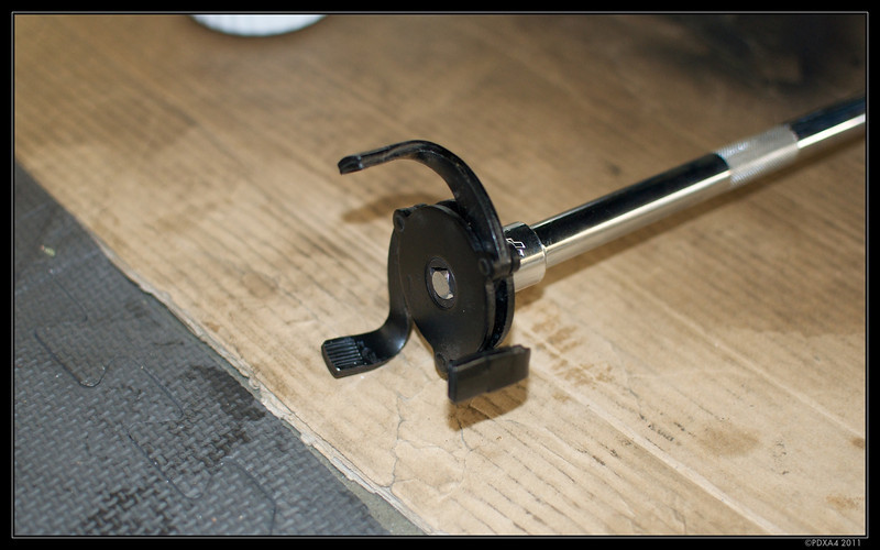

Tool of choice to remove the filter...It was tight but easily removed with my setup...

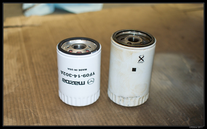

New filter vs old...I already knew tks to the forum of the different size, so I was not worried.
Old drain plug, and the Fumoto valve...
Installed Fumoto valve, used a 14mm wrench to gently tighten it into place. I also use a small tie-wrap to ensure that the release valve does not move...

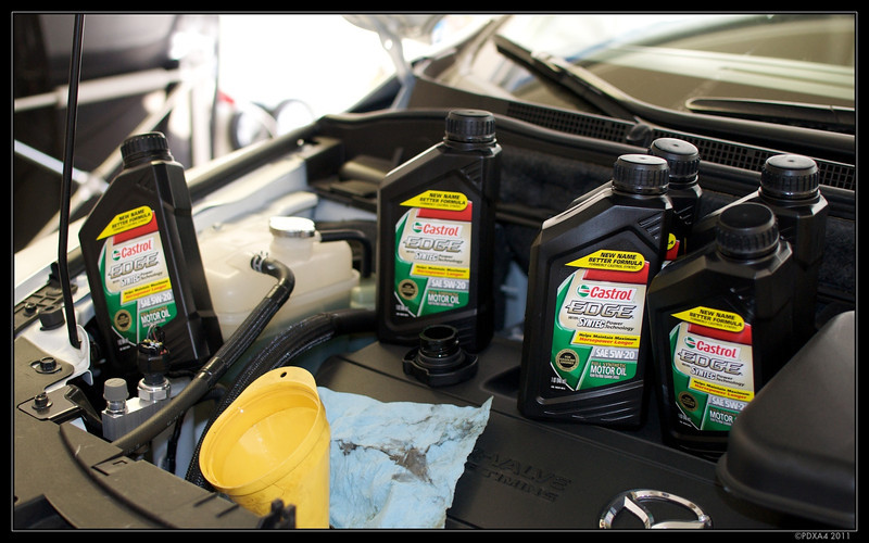

Oil time, 5.5Qts of Castrol Syntec 5W-20 for now...

Nice! How much for the Fumoto valve? Good idea with the zip tie. By the way, did you experiece a double oil flow before putting in the Fumoto? My drain hole spews oil in 2 different directions, about 4 feet apart at the ground.
I think my Fumoto valve ran me about $32if I recall. I see you have a newer CX9 than mine. We have an 07 and the Fumoto for our year requires a two piece setup. I like the idea of the zip tie as well.
Cost was $36.55 to me, I also got the ADP-107 adapter even though I knew I did not need it for this car, but no harm for the future...(use coupon code YM4 on Quickoildrain.com for a discount)...
I used the zip-tie method on my other cars for years now when using the fumoto valve, extra level of security for me...snip it for the oil change, and stick on a new one when ready...
No double oil flow out of my pan, came out straight...I do hold a oil funnel up closer to the hole (approx 4" away) to assist in directing the oil to my catch can on the ground...
Yep the older models had a recessed pan...

To remove the original oil filter: would a 76mm 14 flute oil filter wrench work? I have that for a 2.3L Mazda 3/5 and I'm hoping it'll work.

Thanks for this excellent write-up with pics! Did 5.5qts put you right on the money?

I also noticed that the YF09-14-302A I installed was quite a bit shorter than the factory one. Also, no marking on the factory one, I would have expected at least something saying "genuine Mazda" or something similar.
