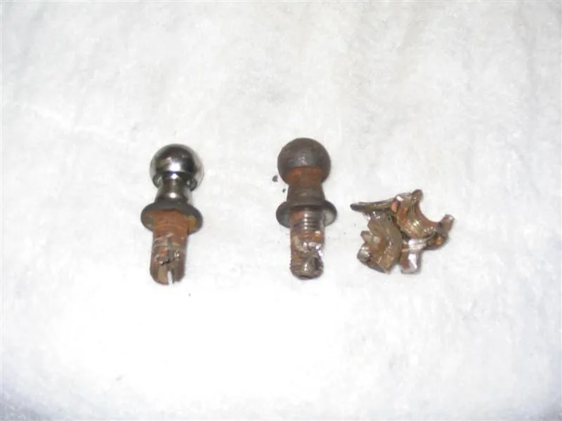

Angle Grinder:1 Rusty Nuts:0
The "washer" on the left was actually a nut to begin with...
<img src="http://www.fractalhost.com/publicimages/nuts.jpg">
Nah, I had all the hardware - only slight problem was the bolts that came with the awr enlinks are not threaded down the shank far enough, so when fully "tightened" the endlinks were not tight - the nut was just hitting the unthreaded section on the bolt.
Easily solved with several packing washers, though.
bwahaha, awesome!!! How long did it take you? I used a dremel and it took fooooooreeeeeeeeevvverrr
Well, I wasted 2 hours going with the "PB blaster, hex key in the end of the bolt and ring spanner on the nut" approach. I actually managed to get one nut halfway off before the stupid hex socket rounded off.
It really is the worst piece of design I can imagine.
Took 5 mins with the grinder - I was a little worried with the amount of sparks flying around in the vicinity of the gas tank at one point :-|
I started the job with a dremel, but kept breaking those silly fragile cutting disks so ending up finishing with the grinder...

My first shot at an endlink and I ended up doing the same thing, looked exactly like that. After replacing an endlink I purchased my air tools, and with a good soaking of PB Blaster, all 4 endlinks came loose in seconds. After hours spent with the hex tool, wrenches, rachets, etc. I said there has got to be an easier way.

I was a little worried too but it seemed to come out rather easily and mine had ~40k on it when I swapped out my springs but it was the 2nd time I had done so. My '01 MPV was a different story... it had ~93k on it when I attmepted to remove them. I had already bought the endlinks b/c that was part of the reason I was replacing struts due to worn end link on drivers side front. Swapped out Tokico blues on it and it rides very nicely now. So my Dremel vs. EndLink, Dremel wins. Guess which end link was bad?!
