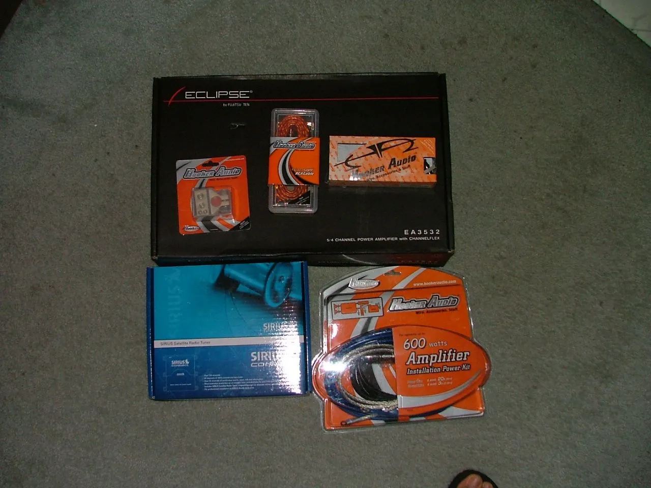

I picked up an Eclipse 5-Channel this afternoon. I can't exactly rememer the model number, but it will do the job. I also picked up a Sirius connect unit so that I can convert it for use on my carputer.
I believe the model I went with was the Eclipse EA3532.

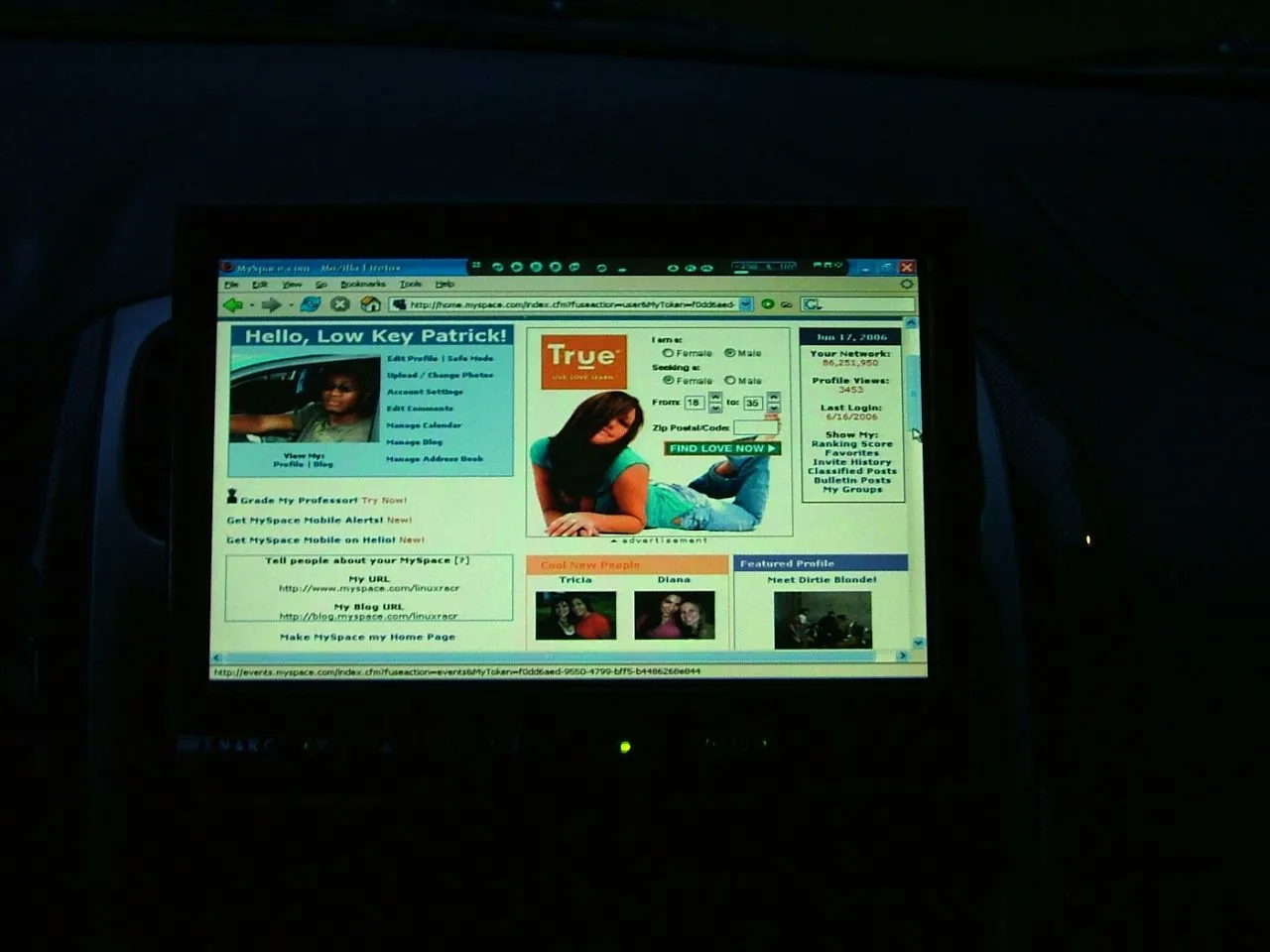

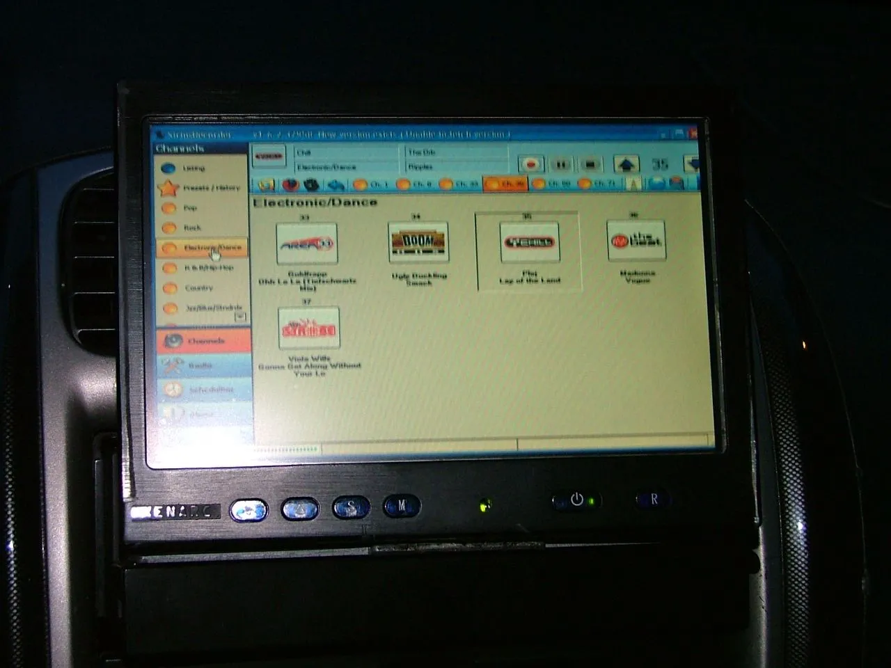

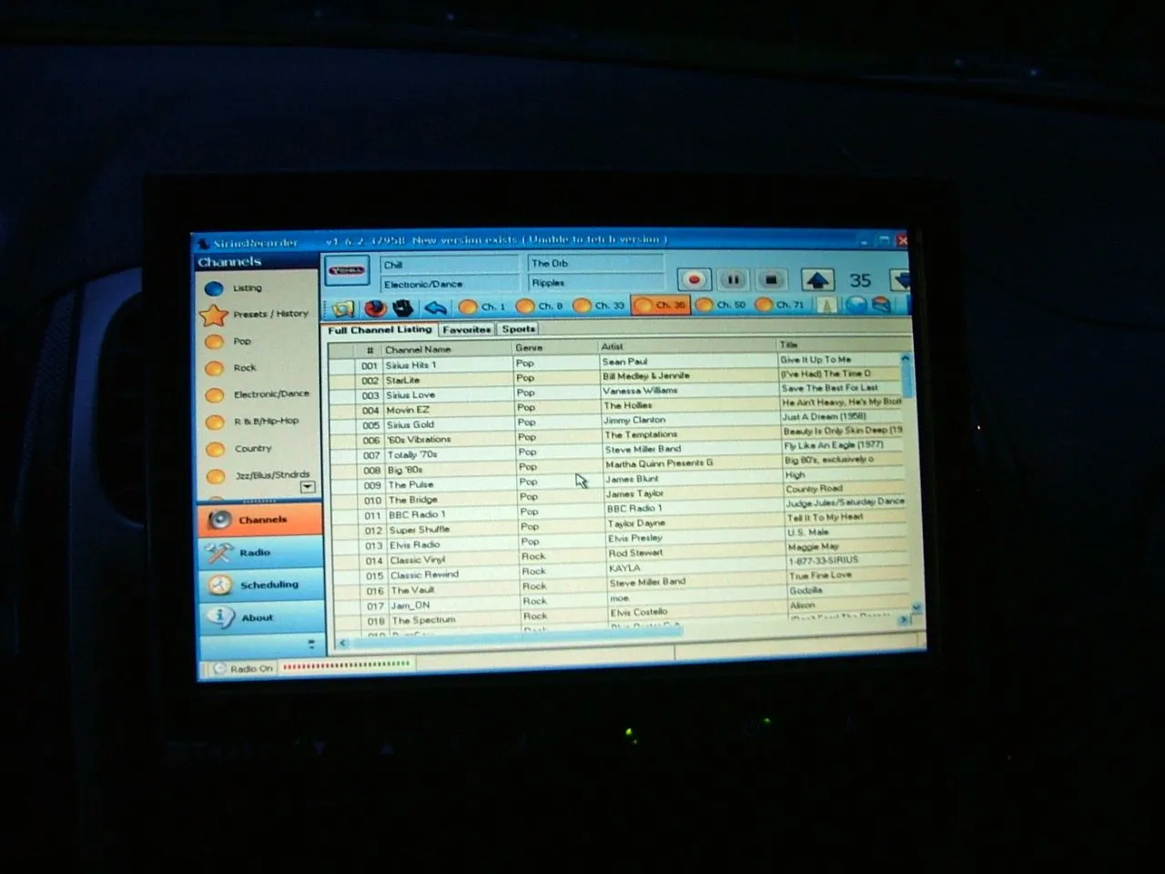

Everything is now installed accept for the Sirius tuner... My Sirius connect to RS232 PCB board arrives today!
A few
Here are some quick shots I snapped last night:
