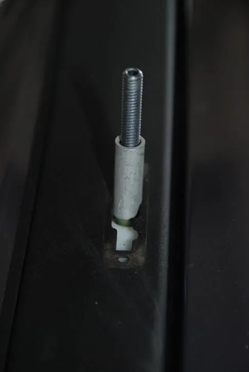

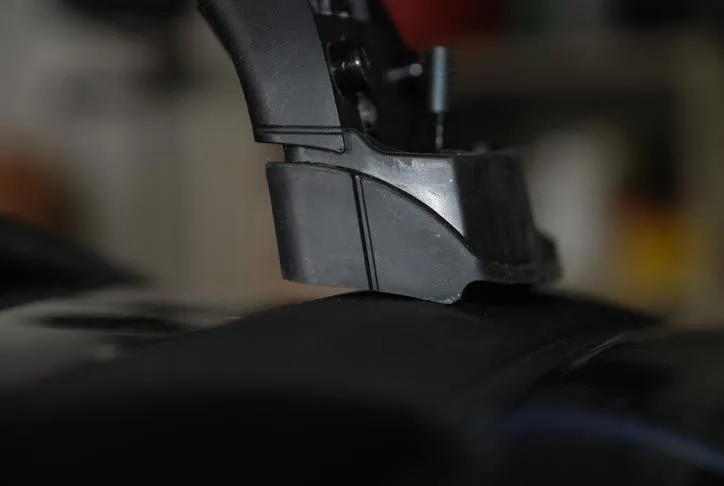

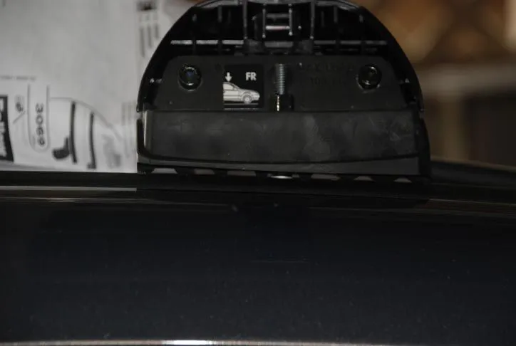

Here are some photos of what I'm talking about (finally!).
At first I thought the collars themselves weren't going to fit... as they are actually wider than the hole in the rail. But with a little wiggling, you're able to stretch the rail just a hair, and then they go in.
But if you notice in the photos, only the one edge of the feet actually sits on the rail. And that, just barely. You can actually see daylight between the ridges.
This just doesn't seem right.
No one else is seeing this with their Thule feet?
I'm wondering if Mazda changed the design of the mounts, and the non-OEM Thules haven't caught up... since even the collars seem oversize.
I have the same issue and when I originally installed the mounts I thought there was something wrong.
i had the same issue but then just gave the nut that holds it down a few more turns and it tightened down nice. i did have to hold the allen wrench in the top of the threaded stud bolt so it wouldnt turn as i tightened the nut.
Hey jibwagon, I went out and tried... and, nope, that nut ain't going down any more no matter what. I even tried to pull down on the rail as I was tightening. It's not moving.
