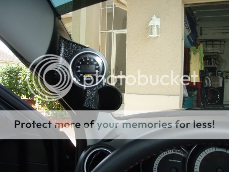

Here is my new gauge from AEM....yes I know "we can't cause of air bags" spare me any hate please...I went to the dealership and had them look at it. The tech at my dealer said as long as it is below the air bag then I'm fine. I took apart the pillar and also saw a pic of the airbag deployed...it rolls straight down and the pillar blows out to the side. Anyway tell me what you guys think. I'll get some pics up soon but here are 2 vids...

I like! Oh and I am a believer that the pod there would not be an issue. The way that air bag would go off the only thing it would do is kick the top of the pillar cover out a bit. The headliner is really where that airbag is.
Thanks for the comments so far guys....and yeah, I saw the airbag! It was right in my face while I was doing the install...plus I'm an EMT and they teach us about the dangers in the airbags while taking people out of a car. Also I'll get some pics in the day time today and post them later tonight!

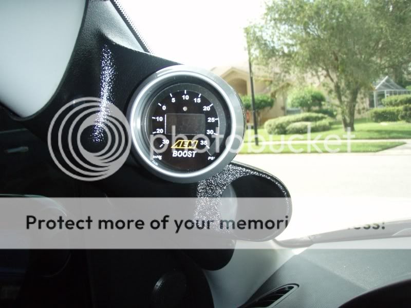

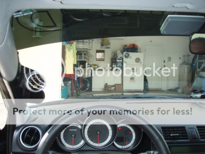

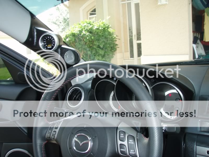

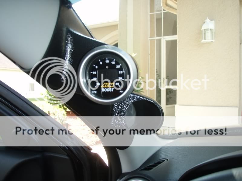

Day Pics!!!!
maybe you could do a "how to" for this install
First thanks for the exhaust comments guys! About the warrenty...I have a good dealership and know people in coporate for Mazda...so I don't ever have problems, but they did say that as long as the parts don't cause a problem then they can't void anything. I don't know if I'll do a "how to" but I will say it is very easy once you know what you're doing. I took the carpet up on the driver side of the car and drilled a hole right throught the floor. Yes I know primitive...but it works...lol. I ran the wires along the bottomup where the exhaust is, along the back of the engine bay, then put the ground where the main car ground is. Then the power I wrapped around the A/C fuse in the fuse box...and walla, power! Then the rubber weather stripping going around the door, take that out. Then just take the pillar out. Make sure you pull the clips out on the bottom first, then the last clip near the top, you have to slide it up and out. I bought the pod from www.glowshiftdirect.com cheap and looks great! Most of all, take your time and pull the clips out without breaking them. Good Luck!
