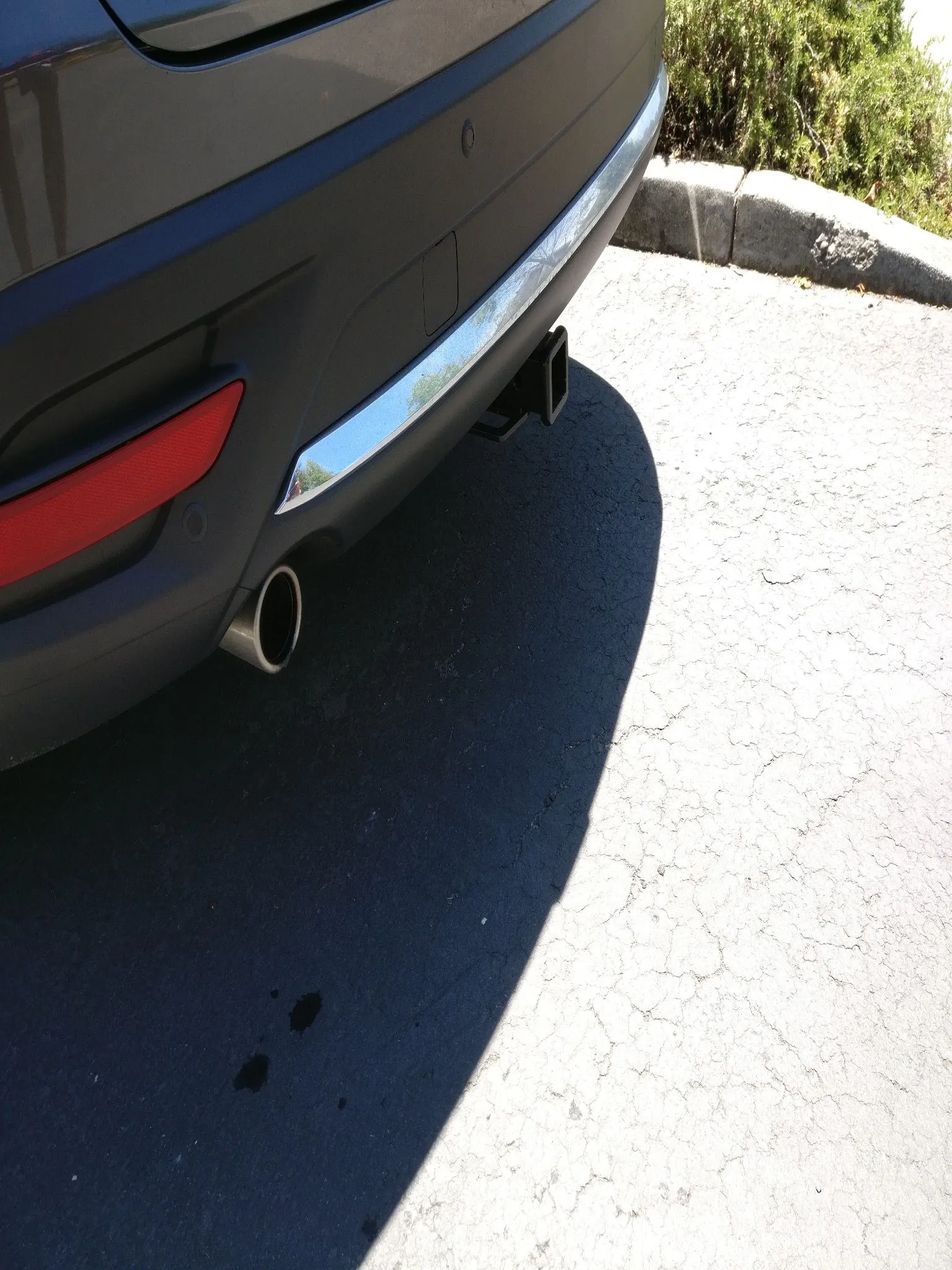

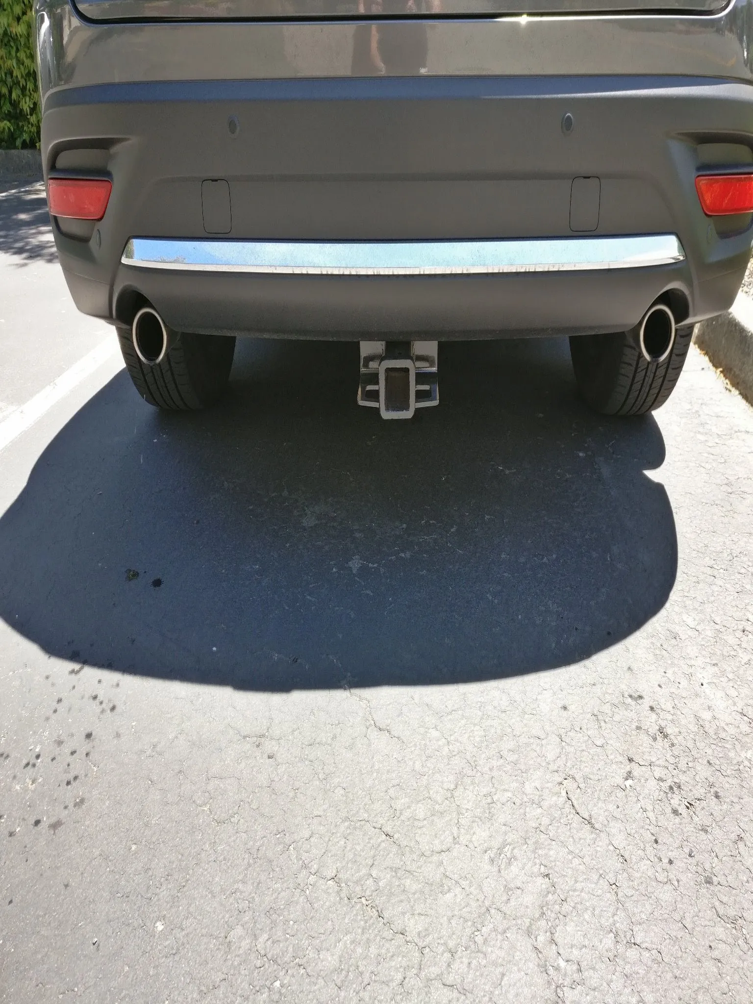

Here are two picks of the Curt Class 3 Trailer Hitch (#13284) on my CX-9.
The forum image uploader is janking the aspect ratio and making it look squished, but you get the idea.

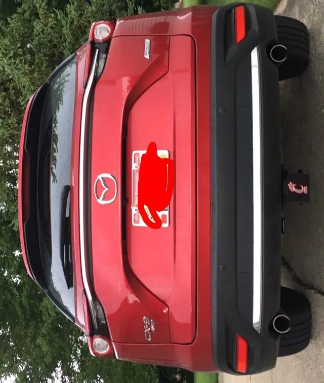

I just purchased and installed the draw tite max frame from etrailer.com. It looks good and was relatively easy to install. Etrailer's customer service was great.
VERY easy installation. I installed it in my driveway, and it took me maybe 60 minutes (a good bit of that is due to several neighbors stopping by to see what I was up to).
