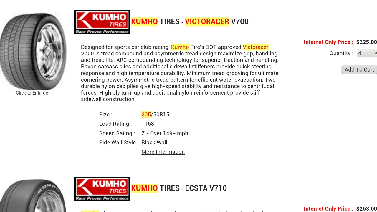

Will a 195 tire still work, or should I go to a 205? The car has to pull double duty (daily driven) so I can't go with a V700 or something else that will wear like that...
195 will work more than fine on a 7.5".. actually, it's better suited for a 7.5". 205's are perfectly suited for an 8" rim (specifically speaking of 15's).

I went with these Kumho's love them! There not as pricey as other fancy tires and I get a hook up from the tire company I spent ten years working for, but my friends in miata racing clubs love them also.
