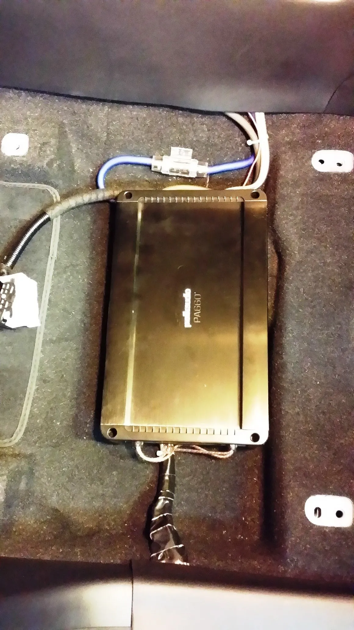

also, where did you mount your amps. I was thinking about doing it under the passenger seat. I suppose i'll need to take the seat out, but how could i fasten it to the floor?
Yep front passenger seat. I didn't fasten it diwn as it is heavy enough and fits the foot print under the seat perfectly. Also helps when taking amp out to tune the across over.
I have made some aluminum spacers, 1.5" long(can be 2" too. I have used some long screws to mount the amps. I have placed them on top of the plastic air duct and at the back, I have used the two spacers. I have drilled into the floor. Not easy, because the sound deadening material gets stuck on the drill bit as it turns.
I have the sub's amp, under the driver seat and the four channel, under the passenger seat.
Sub amp under the drivers seat:
http://www.mazdas247.com/forum/attachment.php?attachmentid=209021&d=1413672051
Four channel amp under the passenger seat:
