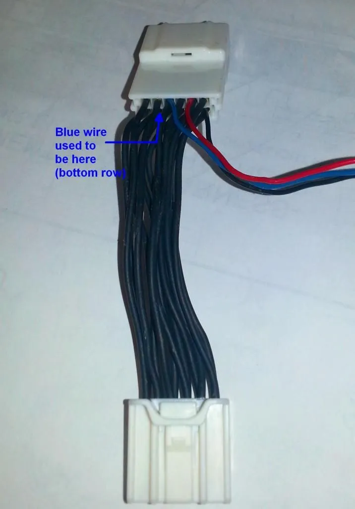

OK, found the problem and it was a doozy. First I have to thank the response from PerrodelSol which led me to re-think and find the issue. To make the long story short it turns out that the ACCESSORY WIRING HARNESS THAT COMES WITH THE MAZDA MIRROR IS INCORRECT!
Perro saying that the Homelink buttons have to be programmed with the ignition off, led me to check the wiring plug for correct voltages at the mirror (since the dimming/compass worked I had assumed the power connections were OK). Turns out that there was only ~2V at the harness where the Battery (Always ON) voltage was supposed to be, but the Switched power and ground was fine.
I, of course, assumed I had screwed up the harness, and after recovering from banging my head on a brick, I went back in to the A-pillar to check. Tested the wires at the car connector (C-11) and found no voltage at that pin there either. After a lot of referring to the schematics for the 2014 car and comparing with the adapter that comes with the mirror, I came to realise that the Blue vampire wire for the Battery voltage IS ON THE WRONG PIN (at least for the 2014, I did not check the 2013 UPDATE: I checked and the 2013 MY cars should work fine).
So, after those many hours of investigating and thinking, I swapped the (blue) wire in the adapter plugs over to the correct pin, plugged it all back in and BINGO it now all works! The picture below shows where the wires SHOULD go in the adapter in case someone else hits the issue (only the blue wire and it's associated black interconnect wire are swapped, the red and black were already correct). Otherwise, I recommend that if you want to get this mirror in your 2014(+?) car (that didn't come with one) you pucker up and pay the dealer for it and let them deal with the headache.
Thanks again to Perro :)

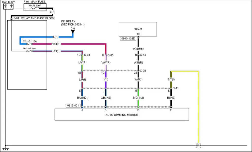

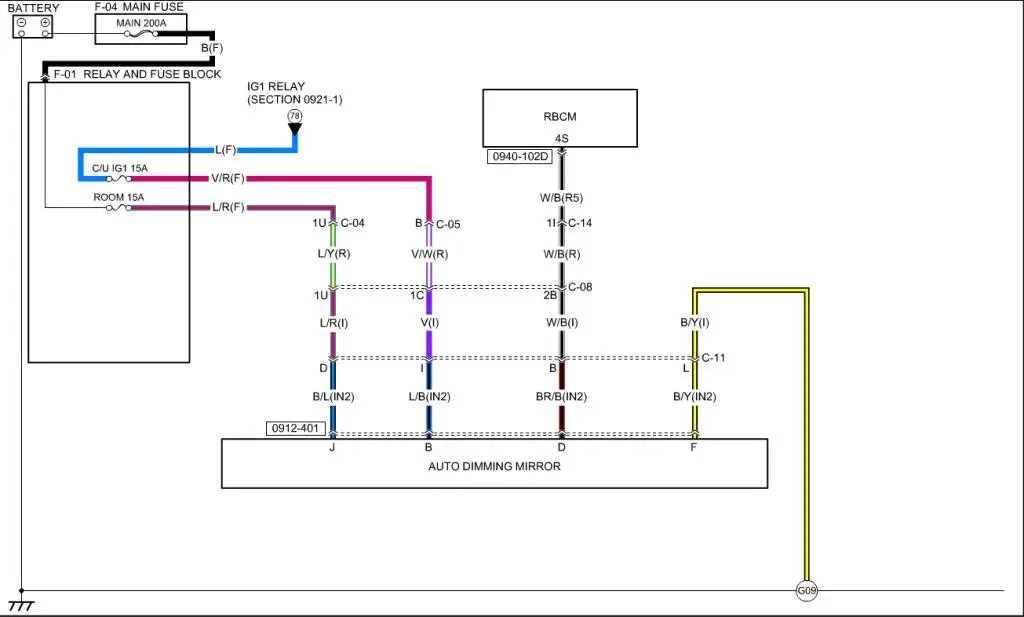

I got the schematic from the Mazda online source that was given in a thread on this forum (sorry I no longer have the link you'll have to search, I just copied what I wanted). But here's the 2013 and 2014 pinouts for the connector to factory autodim mirror (that DOES use the reverse wire):
You got the wire colors right. The accessory mirror does not use the reversing wire. You can just tap into the wires below the C-11 connector... see my photo and extrapolate back to the connector that one plugs in to (for a 2014).
View attachment 203366 - View attachment 203367
Very helpful. Thanks so much!

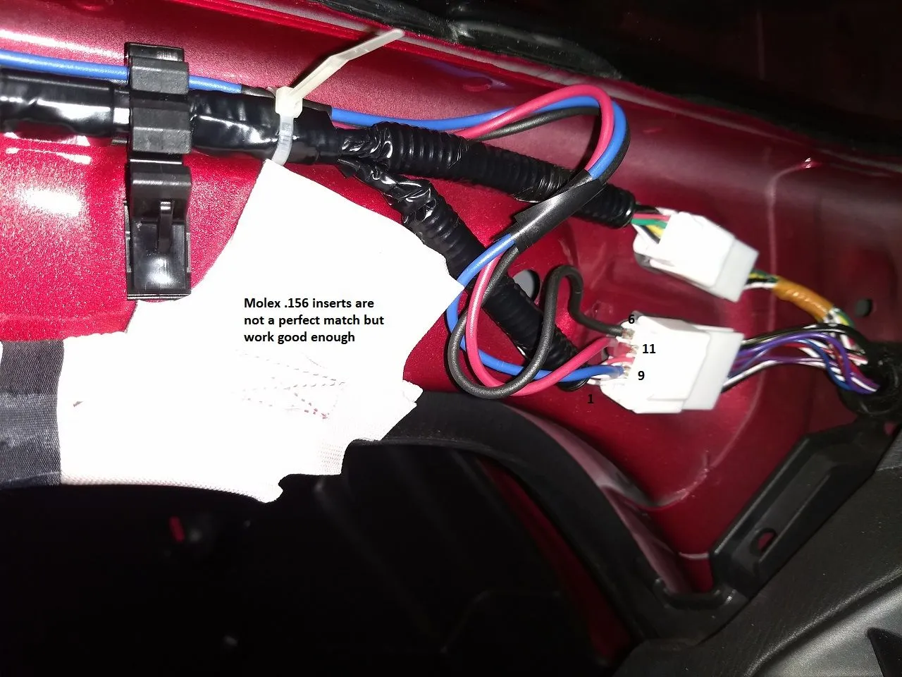

Thanks to this thread, I could build my own accessory harness for the homelink mirror on the 2015 CX-5.
Got the mirror from ebay for $40, gentex 453 (from an infinity I believe).
First, the 2015 and 2014 share the same wiring. Ground is on pin 6 (black), 12v switched is on 11 (red), 12v constant is on 9 (blue).
I have used 18ga wire because that's what's easily available, but you probably want to use 22ga if available.
As for the inserts into the plug, after much detective work I still couldn't figure out what standard is used in these things. I gave locally available .156 molex connector a try, and it is not a perfect match but gives a solid connection, so I recommend given that they are readily available in most electronic shops.
attachment.php
