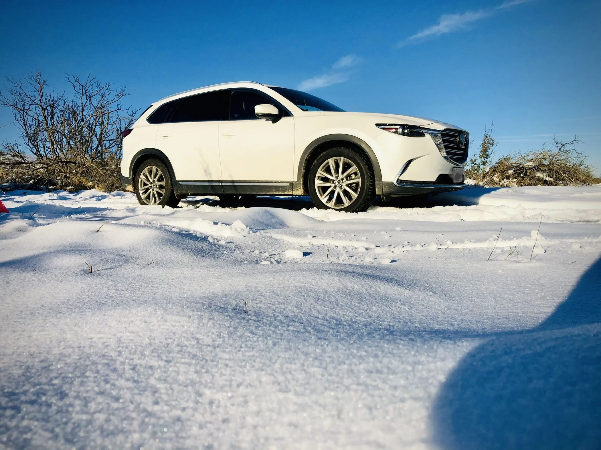

Hi everyone,
I’m thinking of buying stock 18” rims for some A/T tires, looking at 255/70r18 and 265/65r18. I was wondering if anyone here had this setup. Any input would be welcomed.
2016 Signature
current setup
Stock 20”
Michelin premier LTX 255/50
