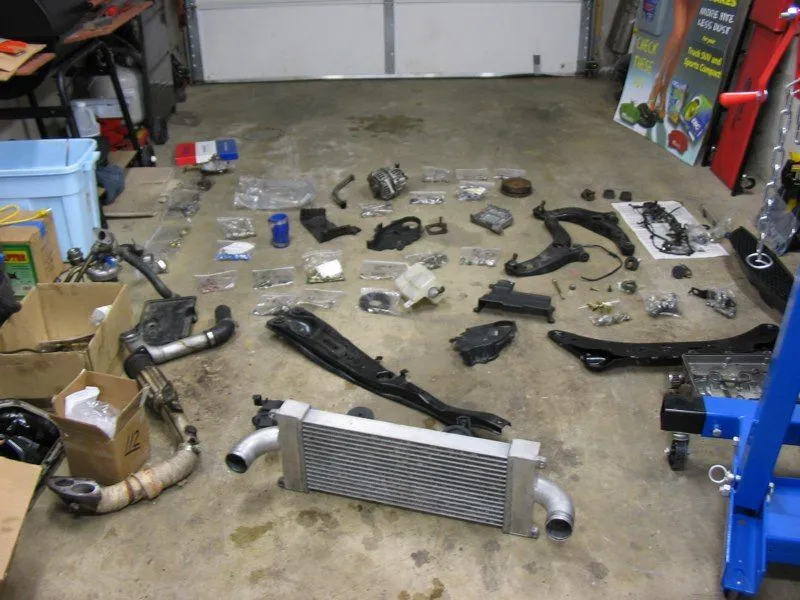

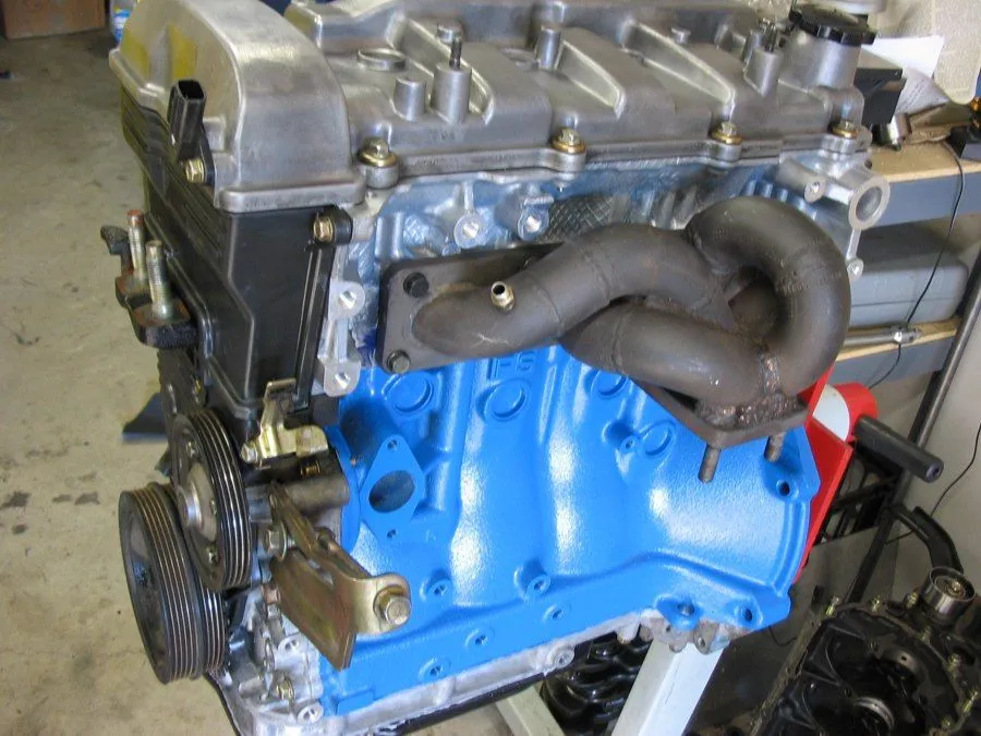

Some quick teaser pics... but more work to be done yet... we had some minor problems friday night.. broke a transmission piece... and that has set me back obviously... but I should get the part on Tuesday and will be moving along from there!
Enjoy.
Steve

Painted it blue and called her new, huh?!?!:D So what's the ETR??? This month???? I bet getting this close makes you a little anxious huh?
looks very good, I have been debating if I should paint my motor or not when I am putting it in
is there a special type of paint or is it just any heat resistent paint that you used?
It is ceramic based block paint.. the machine shop did it for me.. they actually use a Krylon paint. It is rated for like 500 or better...
I decided to paint it because it I have a whole blue and yellow thing going on in the engine bay... so :).
Yeah, being this close makes me super antsy, the ETA is probably next week sometime... may not get it done this week, but should get close!
Later,
Steve
So, we had a few setbacks here and there.. broke the plastic piece in the transmission when I had it apart for some work... then I found that import performance shipped me the wrong timing belt.. then I discovered none of my fittings worked on my turbo for the feed line... then mounting the AEM FPR on the motor has proven difficult... also had some trouble mounting a couple of the oil and water temp gauges... we've gotten all of these things sorted out. All that has to be done now is slap the transmission on the motor and swing it into the bay. Then I have to do some wiring and some house cleaning (aka vacating all the old fuel from the lines and tank) and then she'll be ready to fire up. I'm hoping to do all that Friday into Saturday. Should be driving on Saturday. I'll take quite a few pictures of the process and the motor (I even polished the water jacket lines to a chrome finish... ooh :) ) and give lots of descriptions, torque values etc etc... so lots is coming, I'm just really busy and tied up with all the crazy issues we came across and the like.
Later!
Steve
