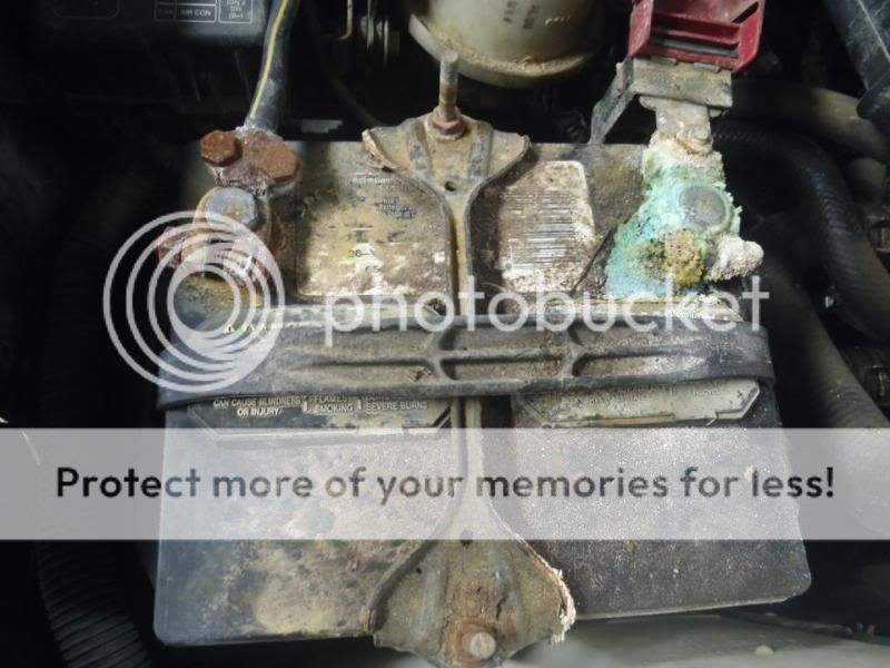

I took this picture a couple weeks ago... believe it or not, this person's battery still starts their truck. Have no idea how.
helbigtw,
"Don't judge a book by its cover!"
Maybe the inside of the battery is brand new .... One can only guess.
Good luck to that guy.
