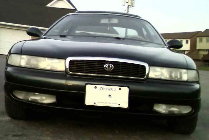

(attn) WOW, that's a clean 929! Most of the 929s I've seen are pretty run down.
Welcome aboard. :)
Welcome aboard. :)
Thanks! I hope I can find the parts I need to totally fix this one up. The prev owner has the ABS unit unplugged because it drains the battery when the car is off (according to what he has said) and it needs an interior door panel, power antenna, window regulator, and a handful of other things.

Really nice 929 you've got there...It's a big ass Mazda and I dig it!
Perfect candidate for VIP cruiser or luxo-tuner style...I see these beauties from time to time in Japan.
Keep us updated on your progress and don't forget to include (pics)
