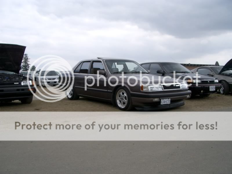

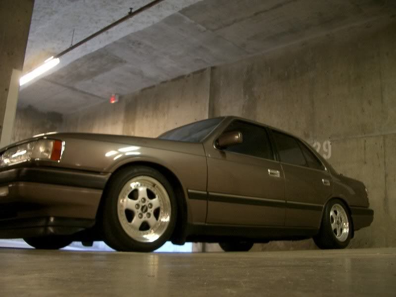

my 89 929 with 5 stock speed tranny.
"mod" list...

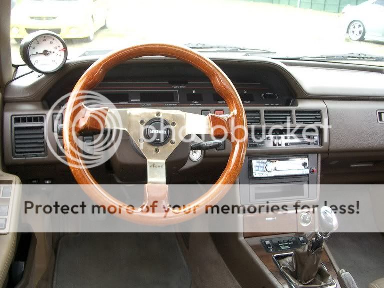

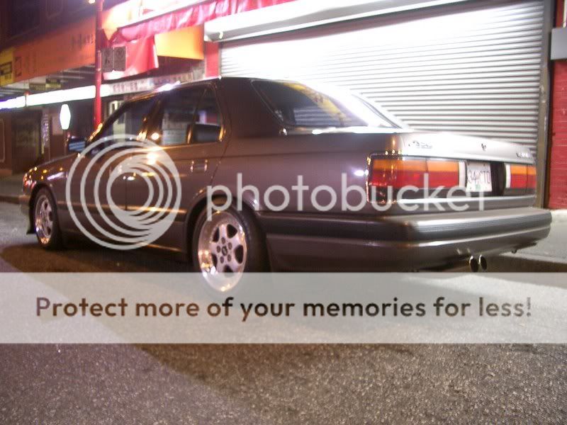

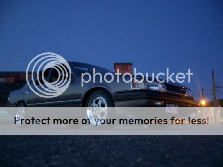

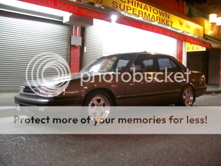

1989 Mazda 929 5spd, Gentle Maroon Mica Metallic with 929S Tan leather, heated seats, auto adjustible suspension (deleted), digital dash and all possible options except auto tranny. 240,000kms
Current Mods - custom made cold air intake with 3" piping, K&N 3" large cone filter, rear muffler and resonator deletion with 2.25" custom cat-back with Sebring resonator and twin-tip VIP style exhaust, NGK platinum plugs and 8.5mm wires, PIAA 9004 4000K extreme white headlights, PIAA extreme white bulbs in headlight cluster, G&E amber corner lights, G&E super bright wedge bulbs front & back, Toyota Camry clear bumper lenses, Frosted orange turn signals, PIAA exteme white interior and trunk lighting, PIAA super white LED license plate bulbs, MOMO cobra carbon fiber shift knob, Broadway wide view mirror, 929S OEM wood grain center console and larger armrest, 929S full tan leather interior conversion, Autometer 3.5" 8000rpm tach, Agos 320mm wood grain race wheel with Momo hub and horn button, Clifford Alarm system, Davidson heavy duty battery, Alpine CDA7995 MP3 head unit, 4 JL Audio 4" door speakers with 4 channel Alpine MRV F-300 V12 amp, 10" Alpine Type R sub and Alpine MRV T-707 V12 amp, custom double stack front air dam painted gloss black, removal of AAS replaced with Monroe Sensatrak all around, 3-3/4 coils removed in front for 3.25" drop, 1.5" B&G rear coils, DIY red calipers, DP Motorsports Enduro 3 piece wheels 16x7 +35mm offset front & 16x8 +30mm offset rear, 195/55/16 Dunlop SP3000 DSST front & 245/45/16 Dunlop SP9000 rear, 50% 7 window tint and more coming soon...
before the front came down another .5"

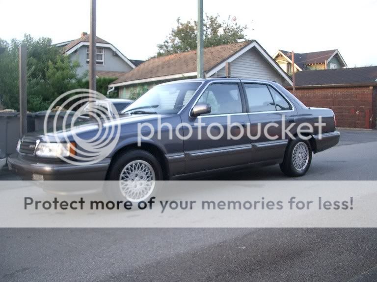

future project car - 1990 929S with 3L twin cam V6 and 65,000kms.
