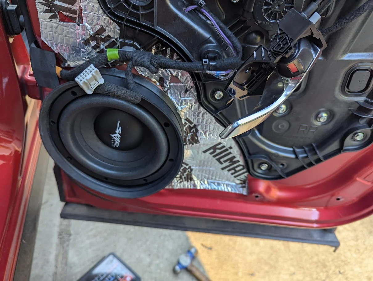

2016~2023 8" speakers fit perfectly in the CX-9 doors!

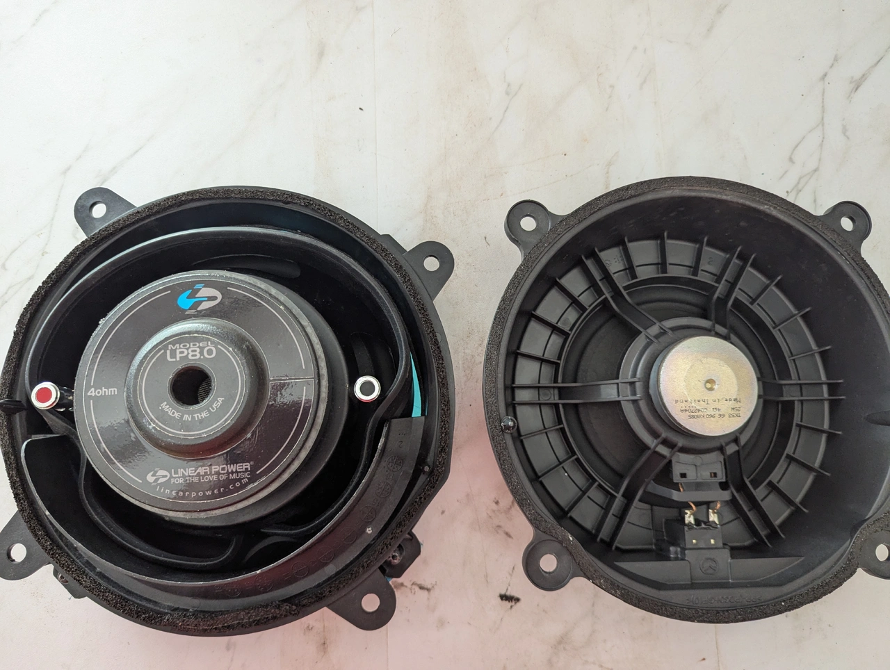

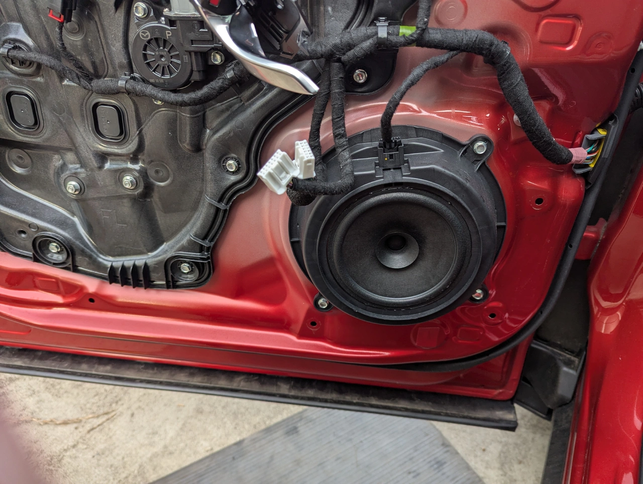

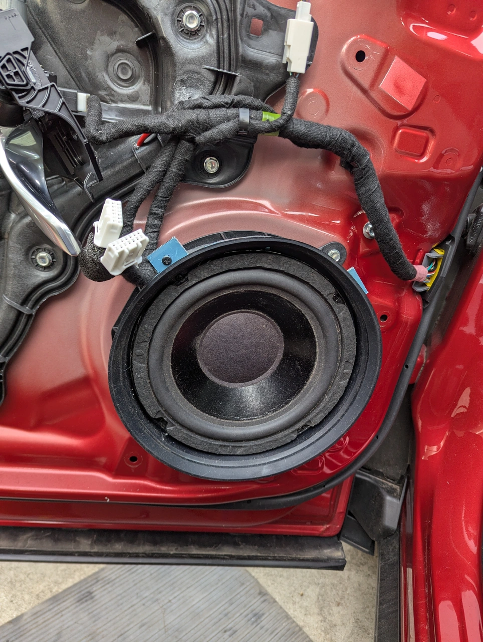

The speakers are Linear Power LP8.0's that I mounted in the doors with OEM Mazda Bose adapter plates part number KD45-66-A61. The speakers didn't quite fit those brackets, so I used a piece of 1/8" sheet aluminum to make adapters to go from the Linear Power speakers to the Mazda speaker brackets. I simply cut the aluminum with a jigsaw to the appropriate size, which was measured with a Sharpie! The specs for the speakers are located on Linear Power's website.
