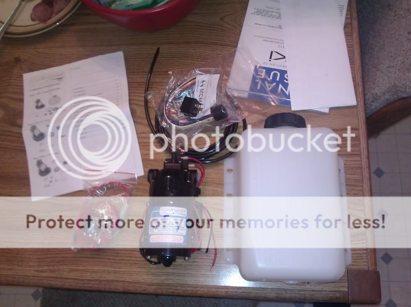

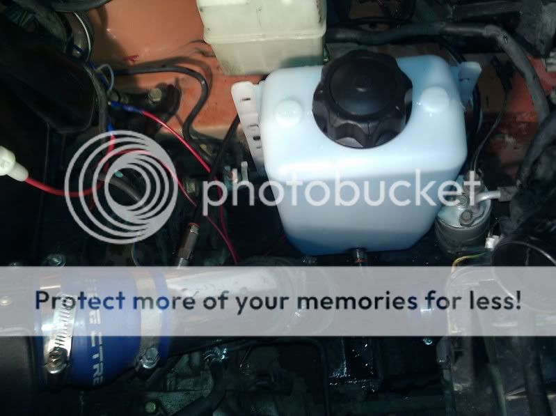

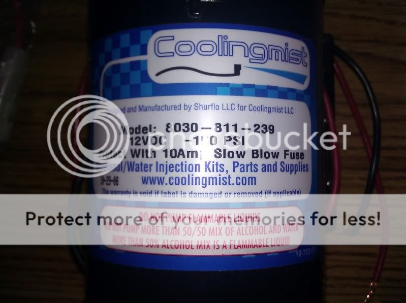

Just got done installing the Meth Kit. loving it so far, feels smoother at WOT and a bit peppier. I think it will really help when i get my fmic, up the boost and get/tune aem fic.

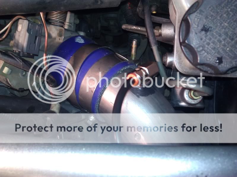

The kit didnt say i had to, but i used some RTV around the injector nozzle. need to clean it up
fit perfectly there
Need to clean up the wiring a little tomorrow. got kinda late and i have to work in the morning :/

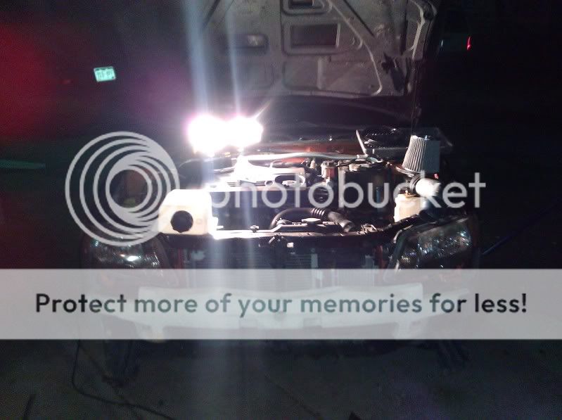

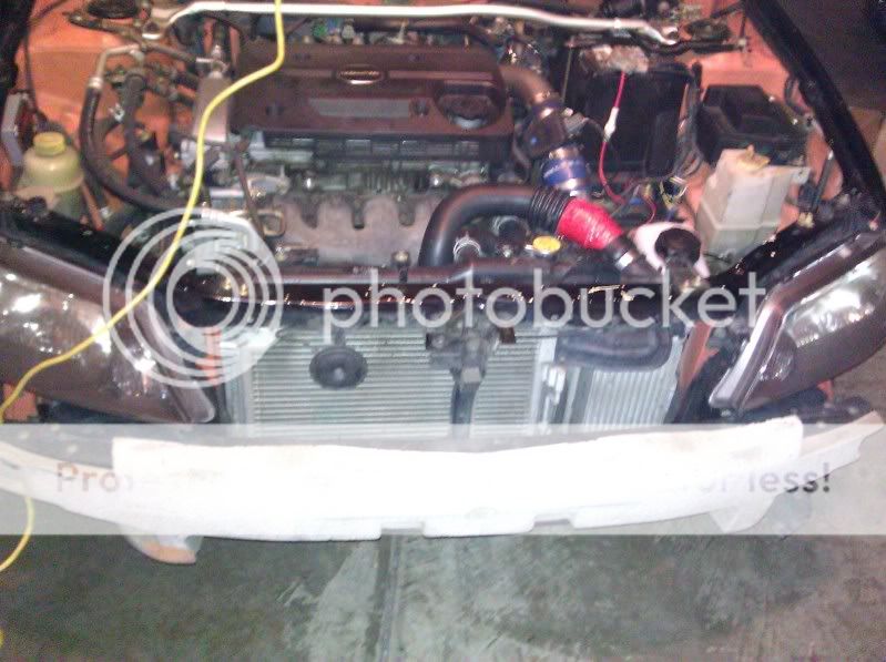

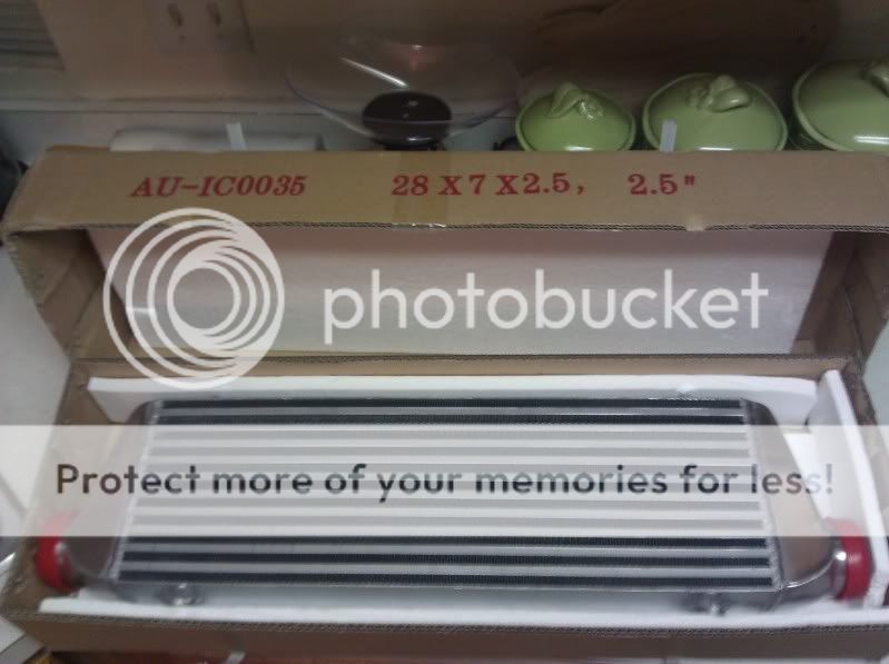

FMIC came today.
install took from 9-12. super tired now.
used the cxracing ebay setup, as i used on my first protege. went with a slightly larger core this time around and black pipes.
still need to raise it about 1-2 inches, finish trim a few pipes, get 2 more T-Bolt clamps. than im going to heatwrap the pipes too.
Yes that is red duct tape on the hotpipe, temporary fix to a boost leak.

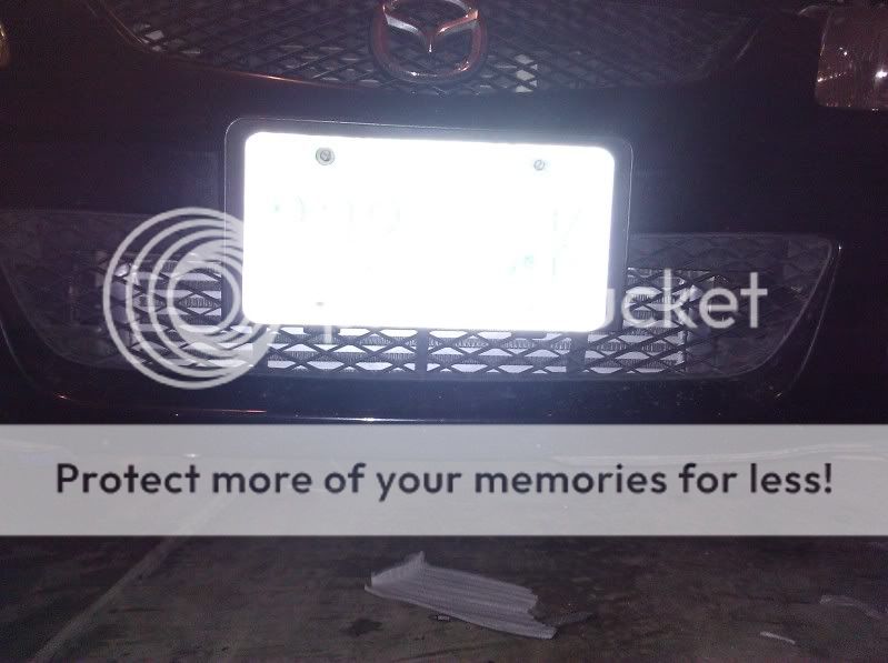

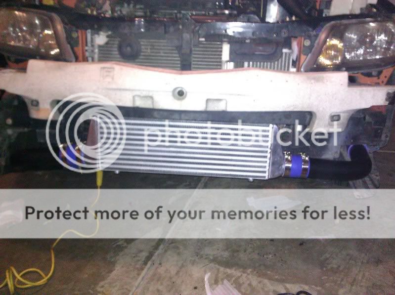

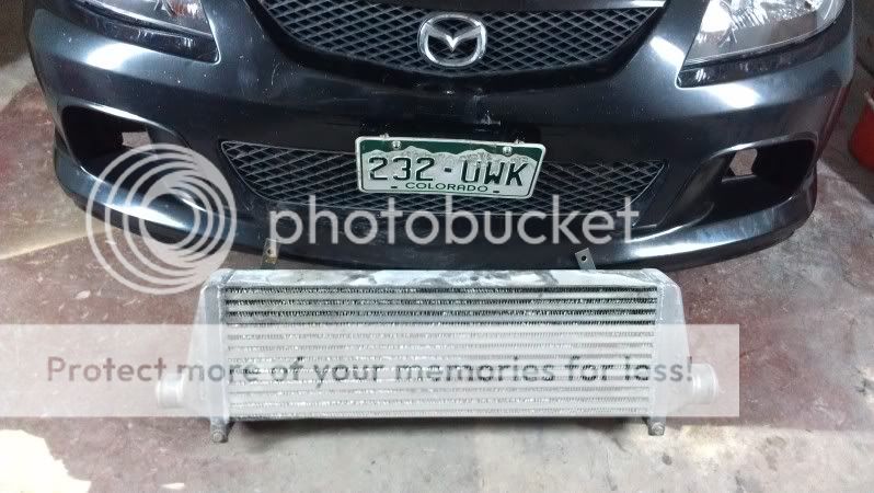

re mounted my intercooler today. more forward and mounted more securely, and cut out the grill tabs
going to try to redo the hotpipe routing so its not hanging so low

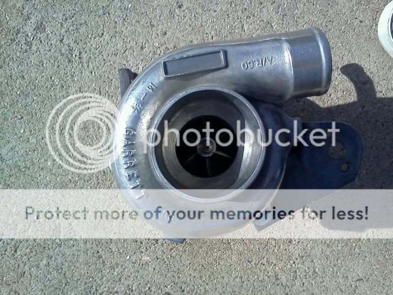

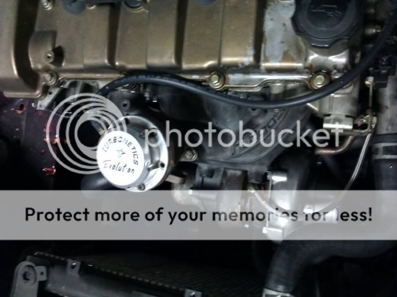

Got this today
1/21/10

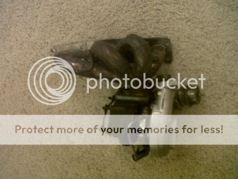

thunder manifold arrived, need to polish it up tho.

ow much did the meth kit set you back?
that would look hot. ive always thoht a crystal white pearl 03.5 would look hot
i got the meth kit from a guy that bought it for his wrx, than sold his wrx. so brand new i got it for 175. just installed it and its awesome! feels a lot smoother at WOT and a little peppier. the FMIC should be here wenesday so that will be next. cant wait!
i may have to look into meth sooner. are you running 50/50 mix so the oem ecu manages it?
def go white! i think the black looks good tho (way better than spicy would).... i wish i had the money to go white.
im just running the blue washer fluid -20 that snowperformance reccomends, its about 40/60 meth/water. its regulated by a boost switch.
i am going to do probably mix it myself next time and do like 70/30 meth...
yea white would be sick, i might do it after taxes...
now are you planning on tuning with meth and adjusting your timing accordingly with meth injected? if so, i sure hope you have a low level warning light because if you advance the timing too much with the meth, and you run out... yea.... need i say more? lol
some meth kits come with a feature that prevents any damage from being done. i think it actually shuts off the car but im not 100% sure on that.
yes i plan on tuning with the meth and yes i will have a fluid level sensor.
idk about that dandan but sounds cool. i would just rather use a sensor though.
