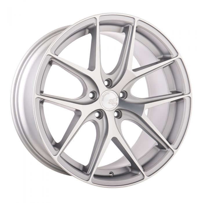

What about the Avant Garde M580, Vorsteiner V-FF 101, or the Niche Misano? They look pretty similar in style.
M580:
V-FF 101:
Misano:
Niche’s don’t come in the offset I want and are too heavy. Vorsteiner’s are amazing but more $$ than I’m willing to spend, (same for Vossen’s, love them but haven’t been able to find any sales and I can’t quite stomach for full sticker price). Will look into the Avant Garde further, thanks.
I just realized I posted a pic of the multi-piece Niche wheel, oops.
Yeah I think out of the three I posted, I like the AG ones the most.
