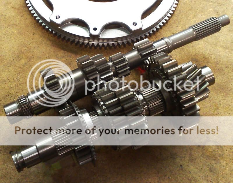

Transmission $7K

a few people here. I can't remember their names. I believe they shredded a straight cut 3rd. The PAR set has a more strict fluid change interval I believe. But even with the straight cut gears, as far as I know, there is still a problem with the shafts shifting under high load. PAR has the reinforcement cups but it isn't a 100% fix.
