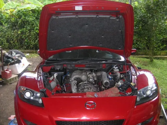

3 Rotor RX 8 657Rwhp @ 9600 RPM (boom07)
neit_jnf said:
cuanto sale la conversion? yo tengo un RX-7 del 93... con un 20B seria mostro!
Siiiii si lo seria ya para ese viene un kit lo vende Pettit Racing en Florida.
saludos Boricua

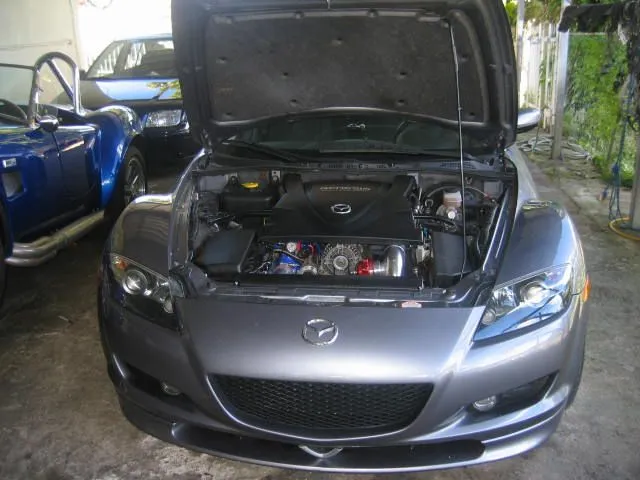

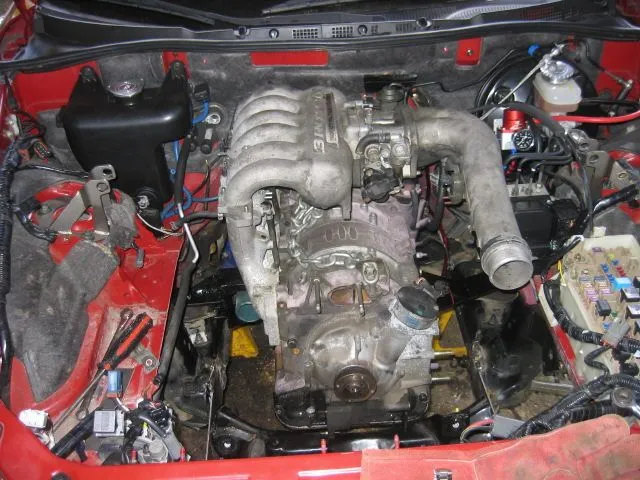

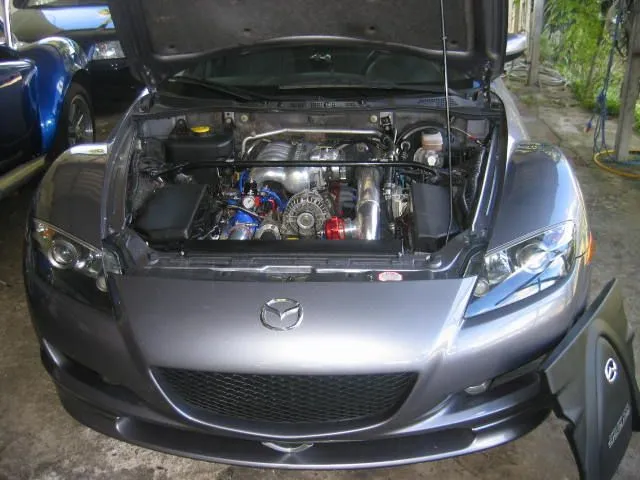

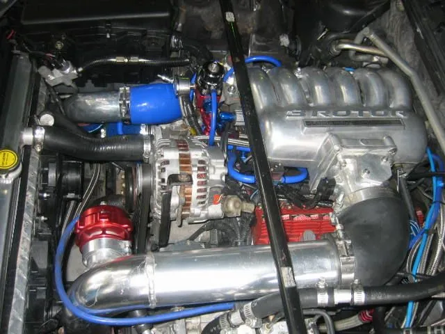

there's an another project on the way :)
3-rotor RX-8 AHHHHH!!!! Awesome!! I found pictures of a guy who managed to put a 20B in an old Mazda 616!! It is pretty cool too... Anything with 3-rotors is OK with me. I would love to put one in my Navajo!
675? How do you pin that to the road? You running a stock tranny? What about suspension/tires. I would think this thing would eat lesser tires.
thank god they got rid of that renesis, it's not a very good motor. Are they using an FD tranny, TII,? That 6spd would break with anything over 350hp
the renesis is a great motor, of course its no 13b-rew or anything, but its a really good motor...the best NA rotary to date. The real problem with the car is the ECU tune.
The 6speed in the rx8 have been able to cope with cars making around 400hp crank on a boosted renesis.
i did use this tranny with a fews mods and i probe that this one is a durable unit i use this for every day to work and for fun after with 10 PSI Boost for every day And 14 PSI boost for ocasional race with 650 RWHP and i no found any problems with it, So i dont know were you find this info? And we have another car running with the same setup and up today it runs with no problems. (thumb)
