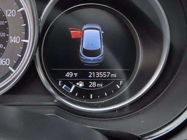

Seems like these can hold up just fine.
https://www.autotrader.com/cars-for-sale/vehicledetails.xhtml?listingId=636579744&allListingType=all-cars&makeCodeList=MAZDA&modelCodeList=CX-9&city=Acushnet&state=MA&zip=02743&location=&searchRadius=0&marketExtension=include&startYear=2016&endYear=2019&isNewSearch=false&showAccelerateBanner=false&sortBy=mileageDESC&numRecords=25&dma=&referrer=%2Fcars-for-sale%2Fall-cars%2Fmazda%2Fcx-9%2Facushnet-ma-02743%3Fdma%3D%26searchRadius%3D0%26location%3D%26marketExtension%3Dinclude%26startYear%3D2016%26endYear%3D2019%26isNewSearch%3Dfalse%26showAccelerateBanner%3Dfalse%26sortBy%3D
