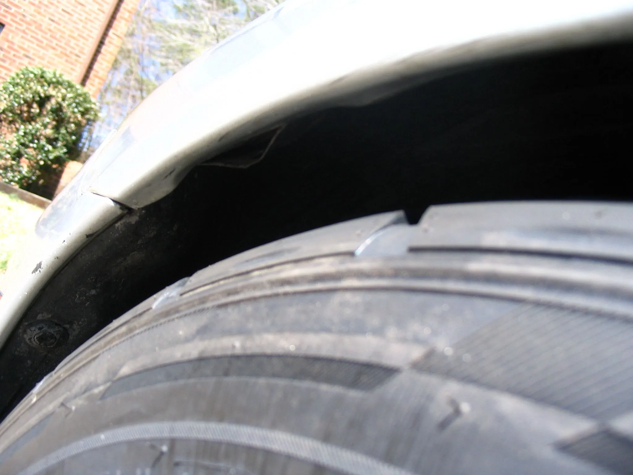

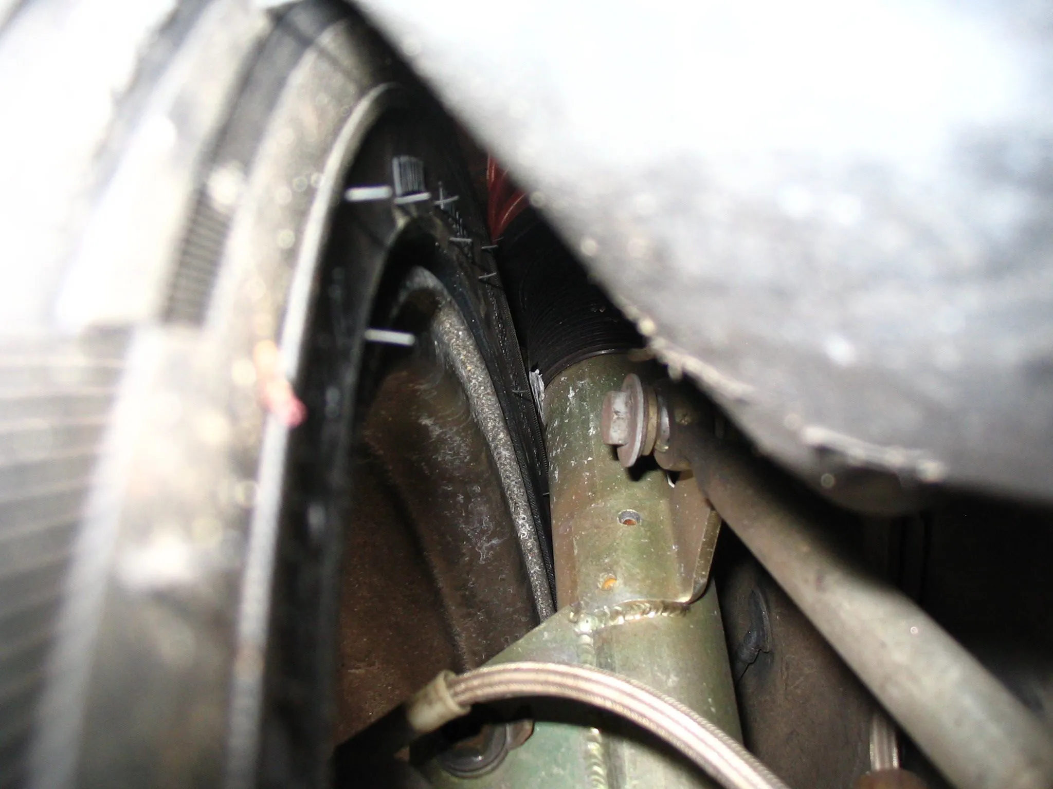

Pictures....you can see in the 3rd pic where I had to clearence the threaded sleeve on the strut a little. It's still very close. The fourth picture shows where the front is rubbing. There is supposed to be a screw holing that little bit of plastic up. i'm going to try and find some very flat headed screws to keep them as far out of the way as possible.

I've driven it a little more today. There are a few rubbing issues under hard bumps. I'll be upping the spring rates and that should cure most of the problem. If it still rubs I'll just have to work the fenders out a little more. It's nothing major. It takes a hell of a bump in the back to make it rub. Once I get the springs swapped the front spring will be 2 inches shorter and up out of the way. That will allow me to reduce the hubcentric spacer a little. That might be enough to tuck the front tires far enough away from the fener to clear that stupid little tab.
There is a lot more grip, but i've had to sacrifice a little acceleration for it. The gearing is a little longer now. I'm still getting used to how the car feels in a turn so I don't have my full confidence back yet. Give me a few weeks and I'll have it dialed in a little better.
