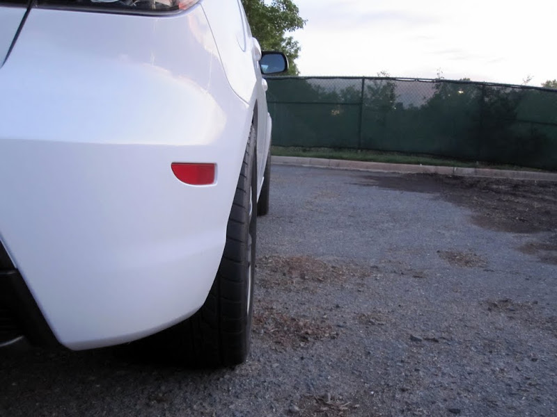

I'm running Hanhook Ventus R-S2 235/40/18. I understand it's not the same sidewall but just saying my input. I had 225/45/18 for a couple months with H&R lowering springs and had absolutely no problems even on the harshest of turns. I went with the 235/40/18s and lo and behold, MASSIVE rubbing issues on the slightest of bumps. Had to hammer my rear fenders flat and it actually completely solved my problems. Now to find some paint to cover up the bare metal on the inside of my fenders...

Without checking your math, 9mm sidewall becomes 18mm diameter - 3/4" or so. It'll be snug. I have 225/45s on RX-8 wheels. They touch on driveway transitions. I'm usually by myself with not much "stuff" in the car, so with any more payload, I suspect they'd touch more.
