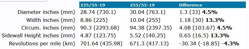

225/55r19 to 255/55r19?
Asking the same question. It's a 4.5% diameter increase, so would it fit inside the wheel arches while turning without touching?
My wheel arch size is 860mm (33.85") and the 255's are 763mm (30") so about 50mm (2") gap each side.

The stock tyres should never rub on the strut. Mine has a 22mm (0.86") gap between the sidewall and the strut so can never rub. Maybe something else got caught there and caused the rubbing mark?
The 255's are wider by 30mm (1.18") so *should* clear the strut by 5mm, not much but maybe that's all it needs.
