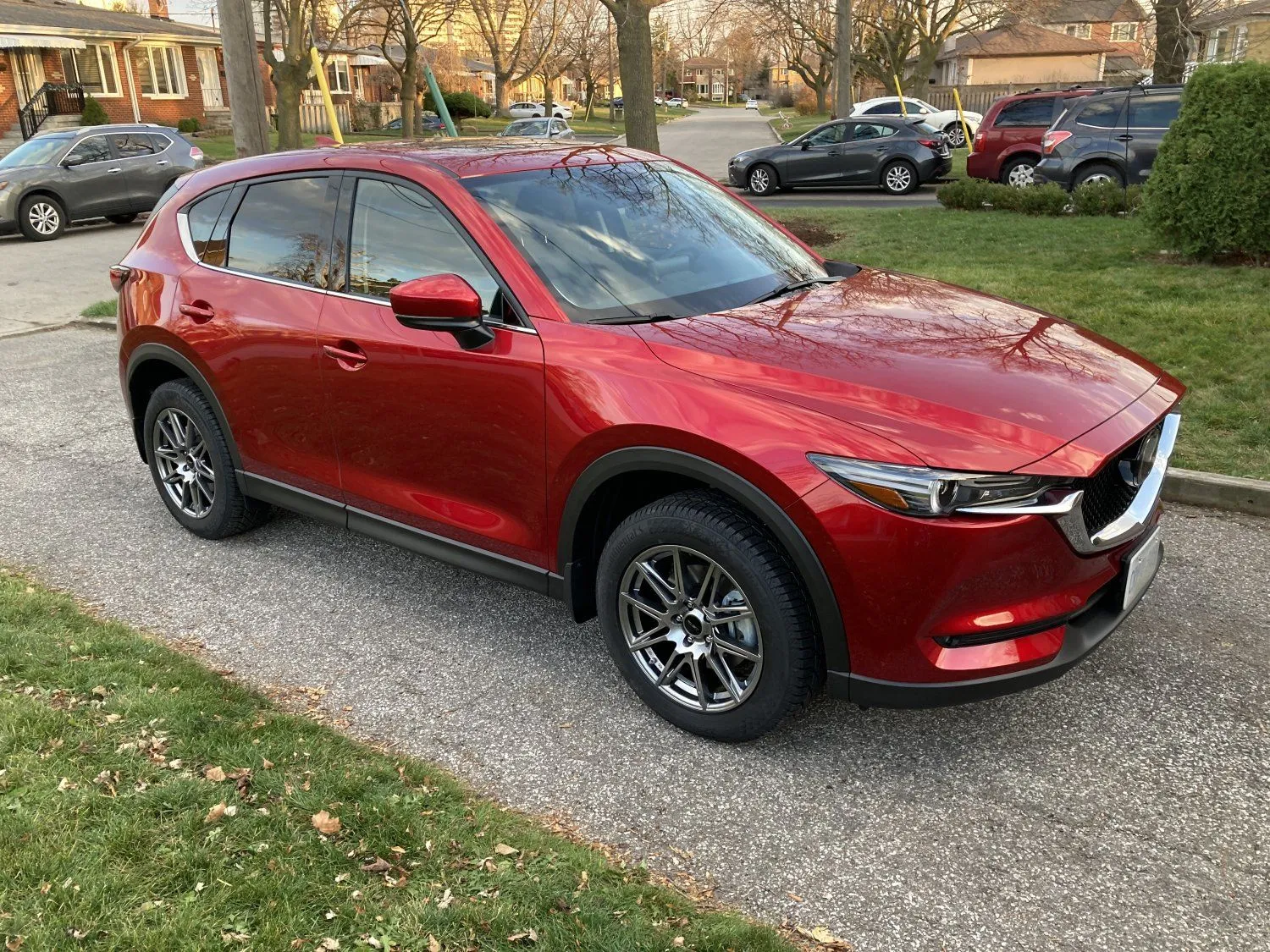

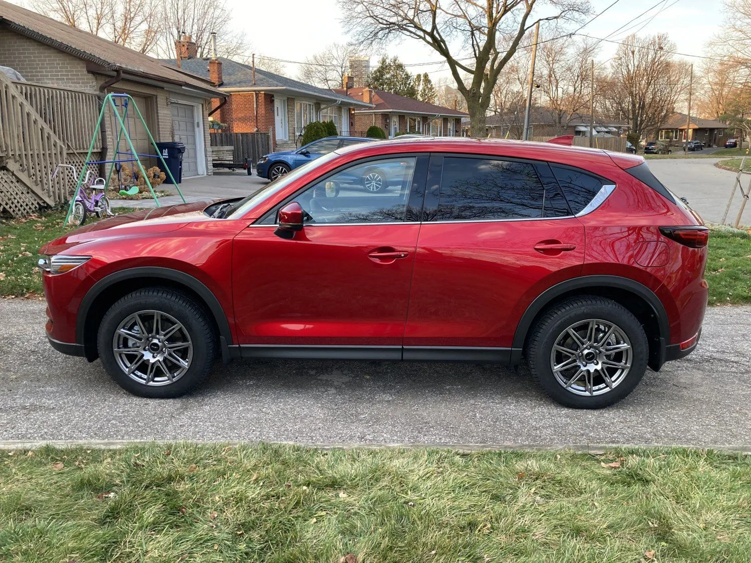

No for the tires, too small. Yes, for the rims, I have the same size on my 2021 CX-5. Aftermarket Fast Switch F212 18x8.0 ET+45 CB 67.1mm 5x114.3mm. Tires are 225/60-18.
