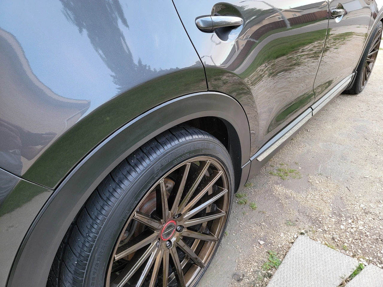

Does the owner of this CX-9 on here? I am curious if 285/45R22 does really fit. I won't be lowering so might have a little more room at stock height but I don't see many fitting 285/45R22 on their CX-9. See a lot more 285/40R22 here. Mine is AWD GT. I was thinking of 22x10.5 +25, +30, +35 or 22x10 +30, +35. Many different wheels to choose from but I'd really want 285/45R22 just because there are so many different tire options at that size.

I run 285/35/22 tires on my 22x10.5 +30 rims. My sidewall is 3.9" thick. 285/45 tires would have sidewalls that are 5" thick. That extra thickness would be perfectly fine in the rear. Up front, you'd be coming very close to making contact with the spring perch. Here is a quick shot of my setup, showing the clearance between the inner rim/tire and the spring perch that I took.

It's hard to tell without actually measuring that distance, but just from eyeballing it, it looks like there's maybe 0.75" to 1" of clearance between the tire and the spring perch, to me. I'm not sure enough to say that it won't fit, but I don't know if I would risk it.

I see. I mean I saw many fitments that 285/40R22 was safe but I’m not too sure on 45. I’d think getting more aggressive offset like +25 would risk rubbing on fender and +35 or +40 would rub the strut/spring as seen there on the picture?
I mean it’s hard to really decide on the offset too. I can see I have options for +25, +30, +35 or +40. Or even 22x9, 22x9.5, 22x10 or 10.5. Trying to find the perfect setup

Measuring will get you certainty about the offset.

Currently my 2018 is on CorkSport springs with the OEM dampers. The picture posted in post #4 is with the 22s installed on OEM suspension, but the CorkSport springs only have a marginal effect on clearances due to the tiny bit of additional negative camber up front, making the tire sit a few millimeters closer than in the pic.
