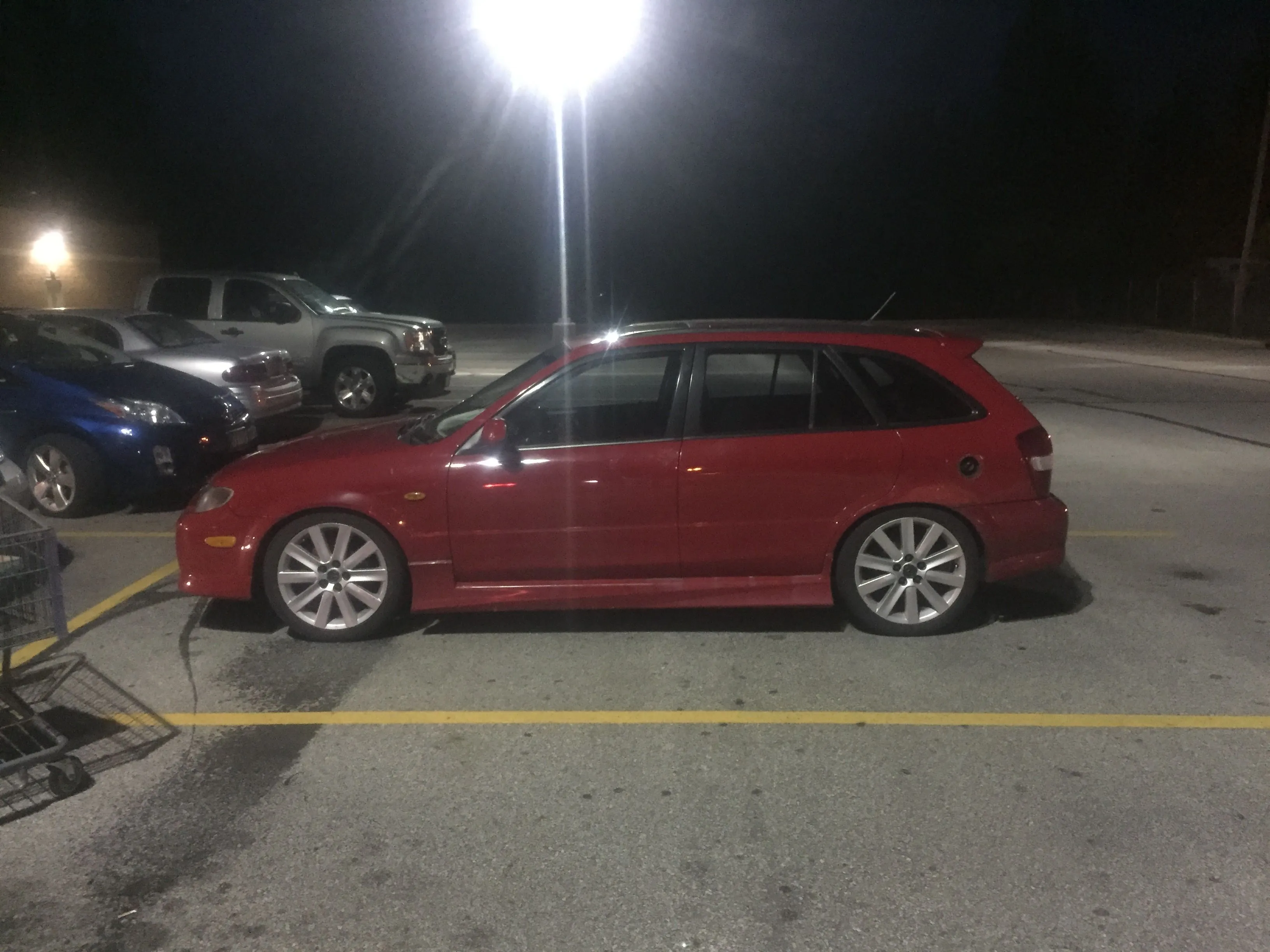

I just picked up some speed3 wheels and the are wrapped in these size tires. I am driving on tockio blues with eibach springs.. will these tires fit my car? Thanks!

I got sick of waiting and put them on, they just fit! And I mean just fit, I don’t think there is even a hair size gap in between the tire and the rear strut! And the fronts are good.. been riding on them for days, no issues so far!!

Lol Im surprised those rims fit on your car... that tire is thin for a 45 sidewall which is the only reason why they really fit...
I wonder how the car drives with rims that big? The cars suspension wasnt really designed around such a large and heavy rim.
In my case, rolling diameter was the same as stock, Volk wheels aren't exactly known for being heavy and my car was on JIC coilovers.
The wheels fit fine on stock MSP suspension too though.
No rub at speed down the Corkscrew on 18's
I have eibach springs with tociko shocks and struts.

Those speed3 wheels look very good on the P5. Hard to believe the car's over 14 years old.
I know, over 218,000 miles in it.. the car is pretty beat up and Ohio rust is starting to take over... that’s why I took the picture at night lol, but at least the wheels fit!
